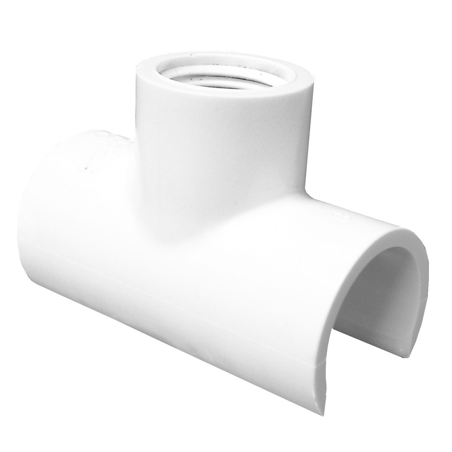

        A real easy storage wall rack
        use(2) pvc fitting above and (2) 10 to 12 inch pieces of pvc
        drill 2 holes in the fitting (upper & lower on the T side of fittings)
        screw fittings directly into wall about 15" apart making sure their level
        add foam pvc insulation to pipe and insert into fittings (add pvc cap to pipe if desired)
        as you can add more racks as you get new planes
