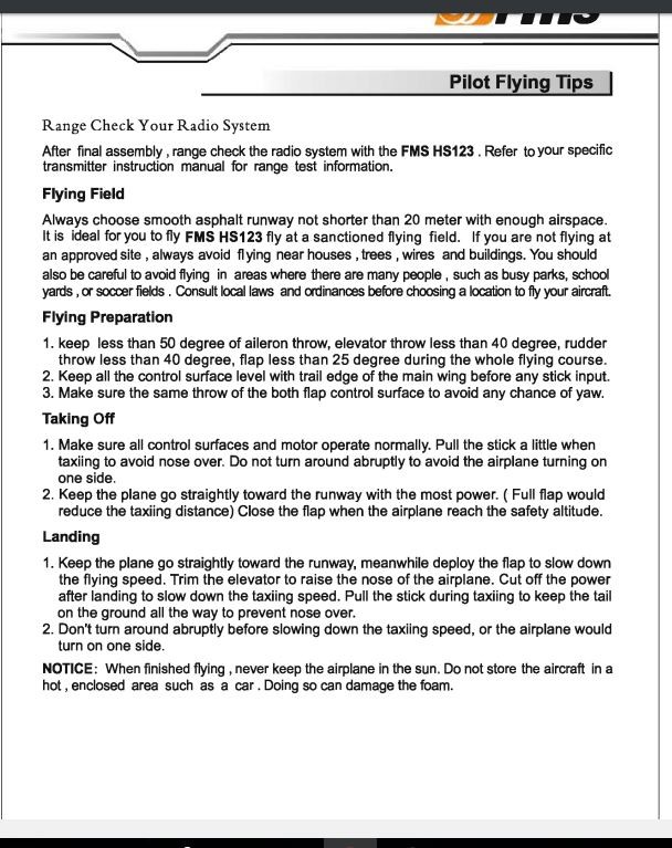

        say I had found this but it isnt much help on the exponential.

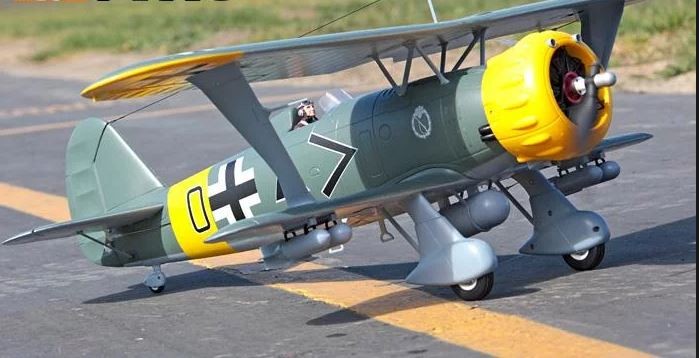

          this is the plane
            Experience...
