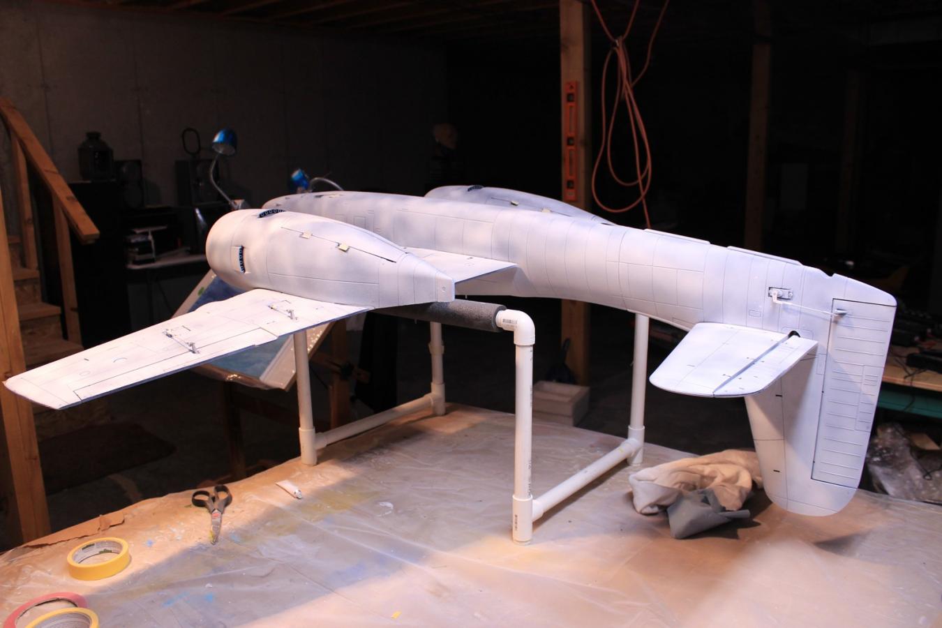

                            I use Minwax Click image for larger version
ID:	208402 Except I use the gloss version. Brush it on, then wipe it off while its still wet. Now, in your case, the Acetone has probably removed the mold release so that might explain no beading Some planes, like my Pandoras, had quite a bit of mold release because they were never painted at the factory. Any plane that was painted would have been precleaned. Wiping the Minwax off will still leave a certain amount on the plane, but if you're still having a problem getting paint to adhere, try the Krylon Foam Primer.

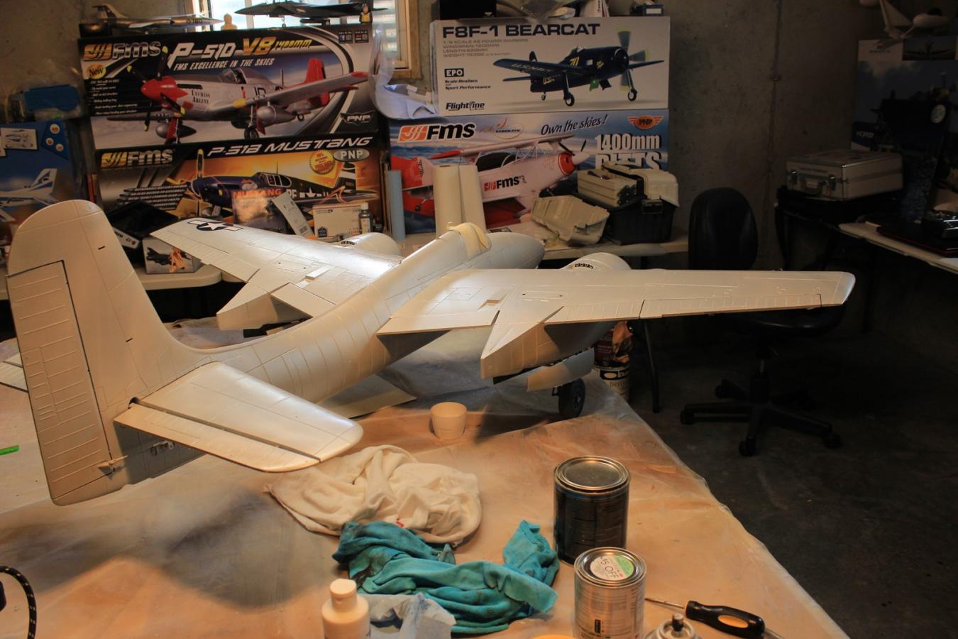

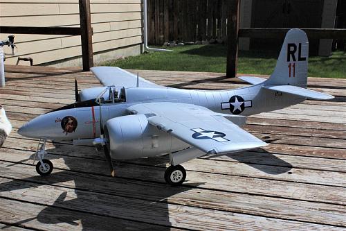

                            I used that on my Tigercat, right over the stock blue.

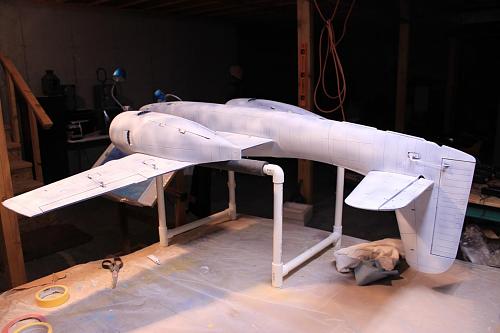

                            Then applied the base color which was a custom mix from Ace Hardware using a Kensington sample water base paint and mixing a silver grey color.

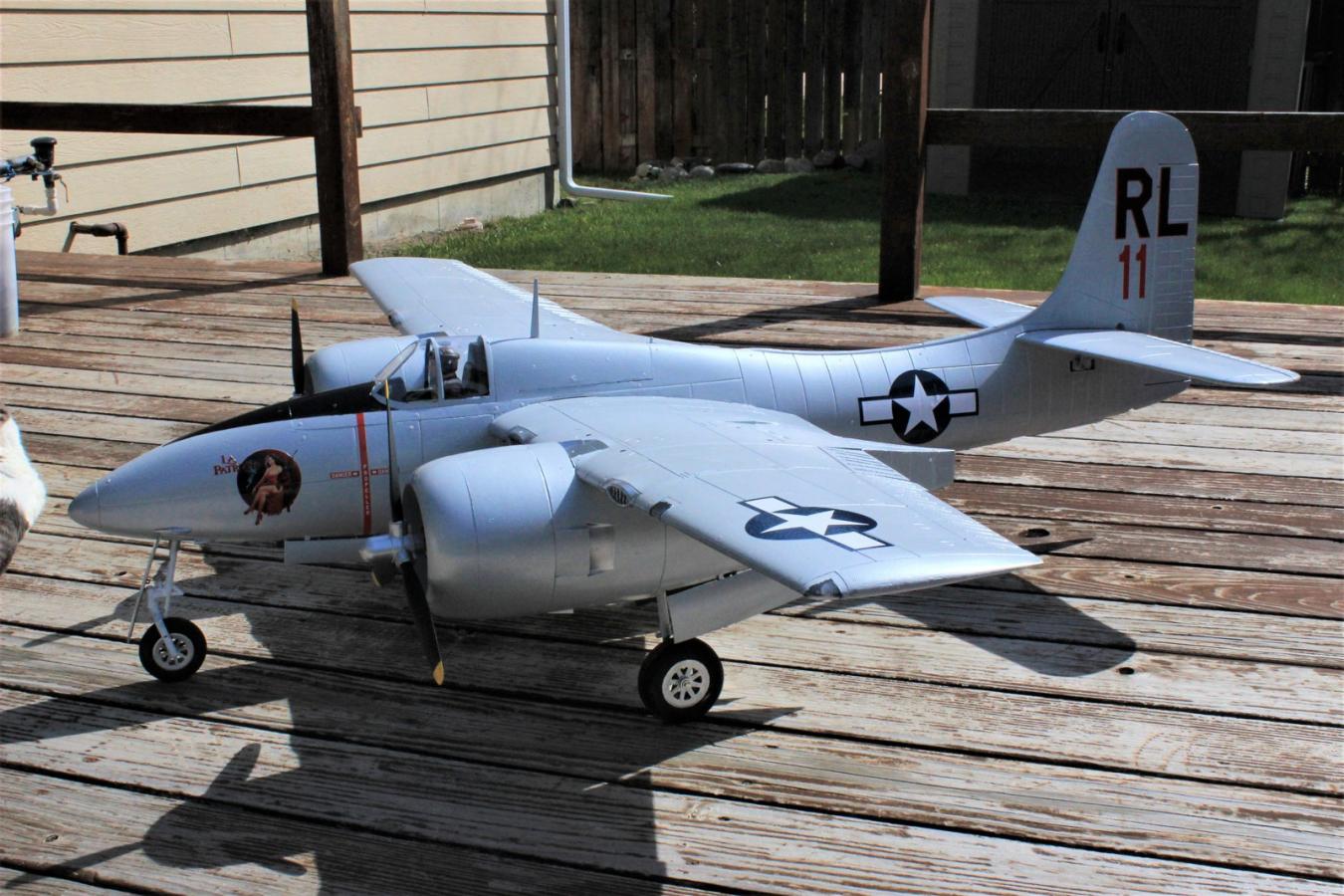

                            then coating it with a pearlesence clear from the crafting section of Wally World, using a spray gun. Six coats if I remember right, then applied the decals, then another six coats of Minwax gloss, this time brushed on as using a brush gives a shinier result.
                            Some people water down the Minwax, I see no reason to. The Pearl coat was mixed to the consistency of milk, I tried it with a brush at first but it was too streaky so reapplied with a brush.
                            Good luck, let me know how you made out!
