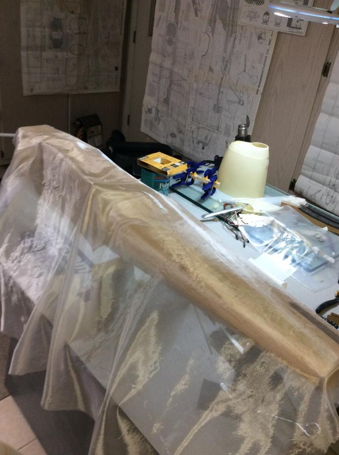

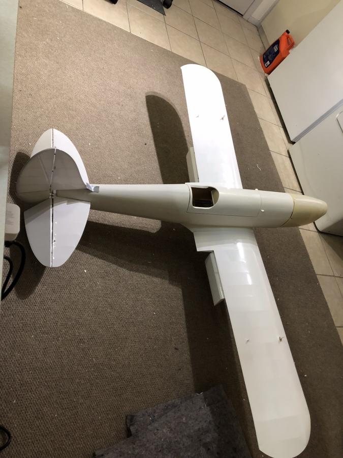

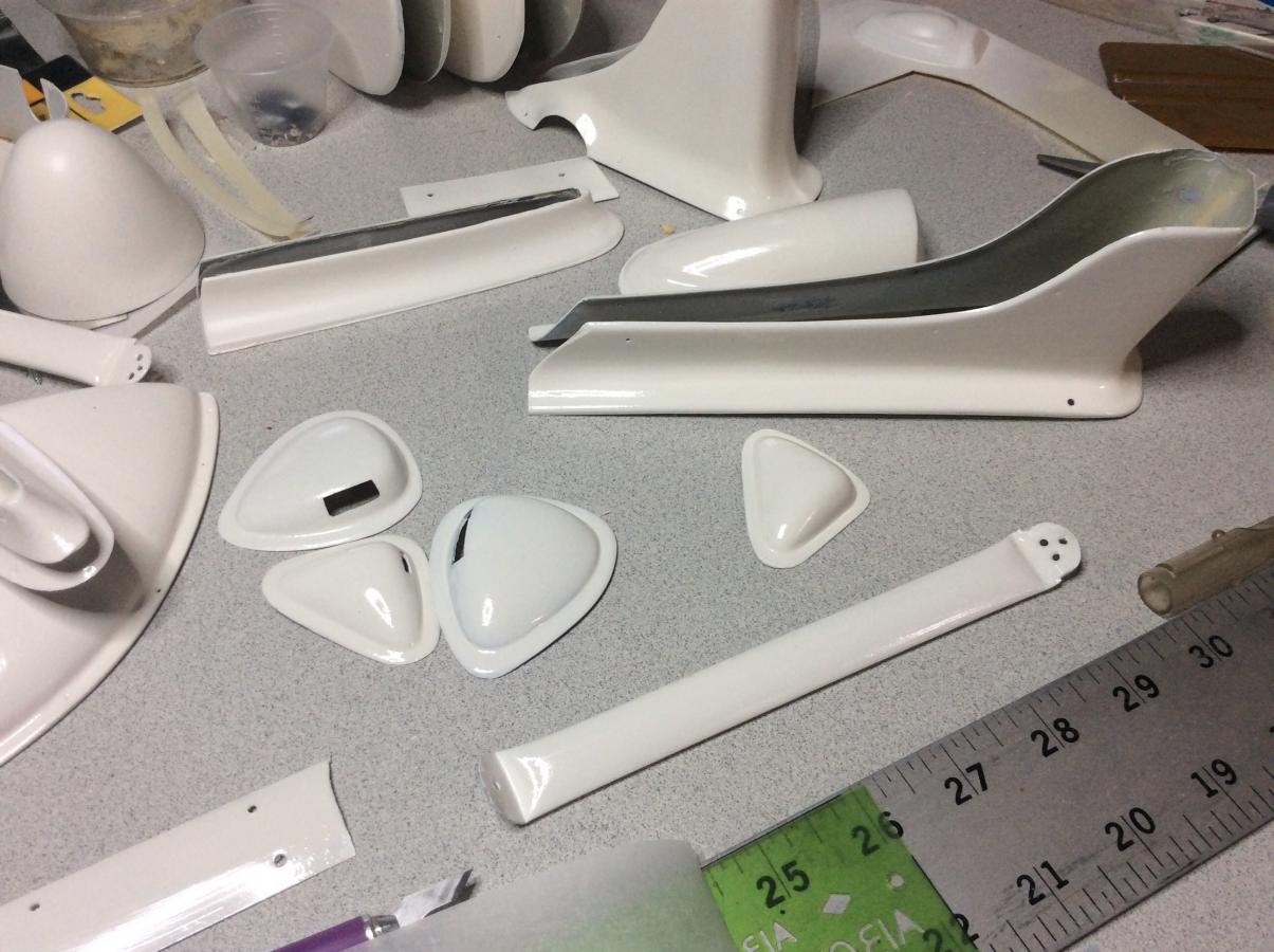

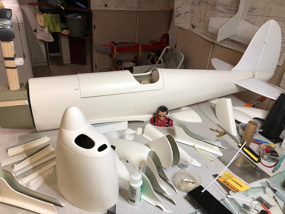

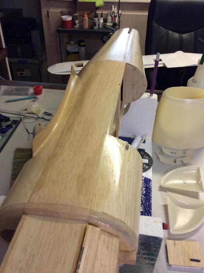

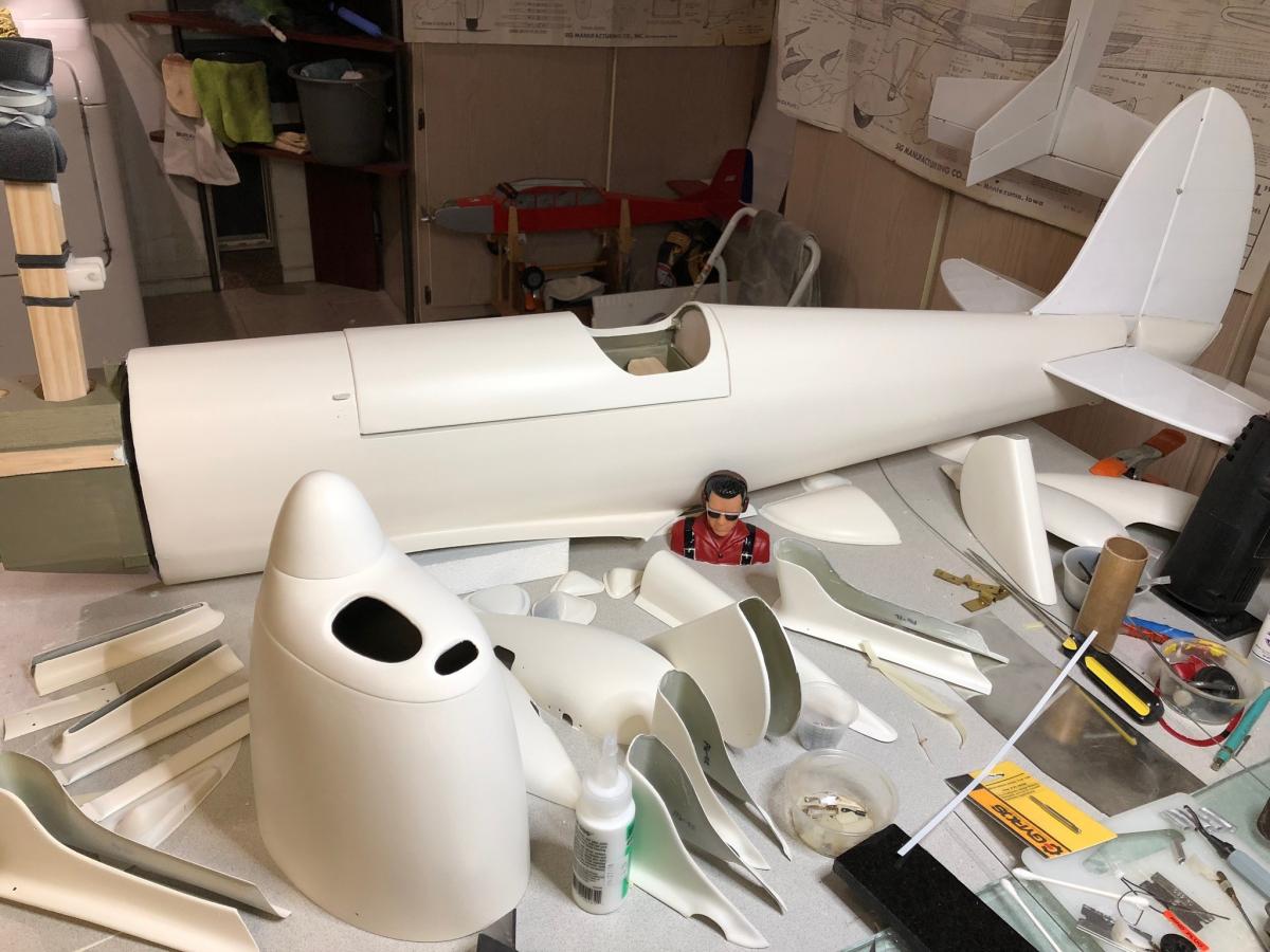

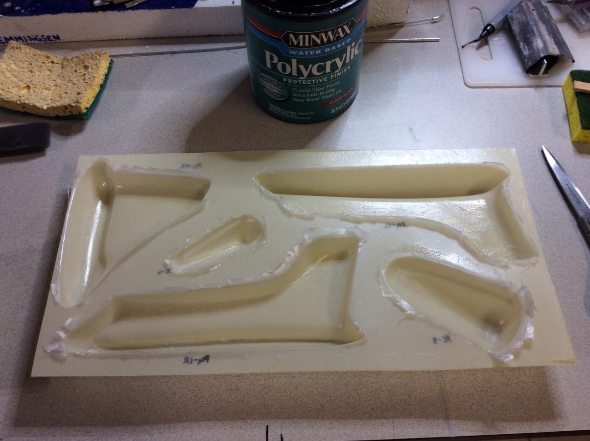

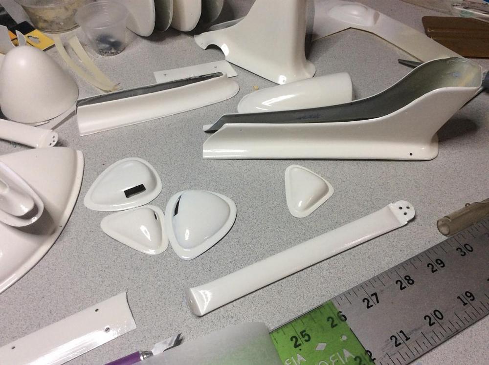

ID:	182551 I used Polycryllic on all of my planes and have done touch ups which covered nicely. Have not used the satin - I like shiny. I even will use it over the Warbird colors on the Ryan. No issues with any bleed, but go light over acrylics on the first coat. Here’s a shot after Polycryllic and yes, a brush applied.
    Since my pics don’t go where I want, you get to figure which is which.

            Most of an entire quart went on the Ryan. Fiberglass over the fuselage, all those plastic parts and even the servo door covers - all adhered with Minwax Polycryllic.
            Wet sanding and foam brush, paint from Warbird Colors. I did spray 2 coats of base color and the thinned paint lays as flat as if sprayed. Never had any issue with Polycryllic, only good results.
