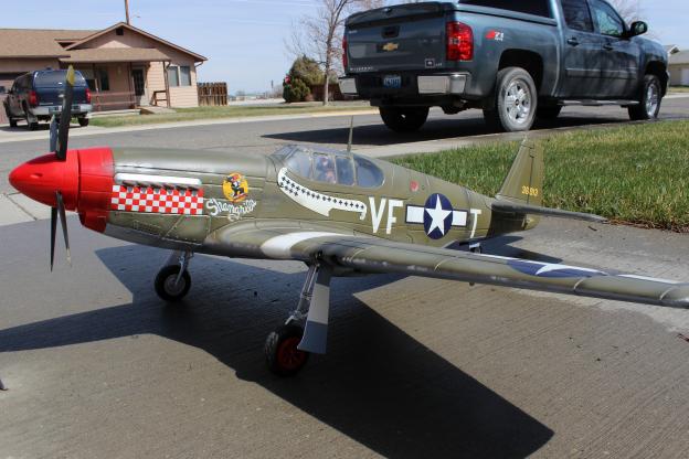

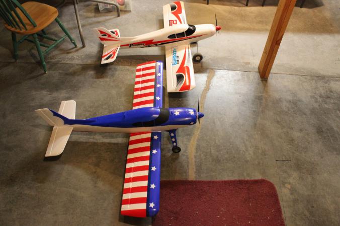

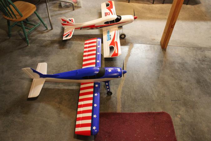

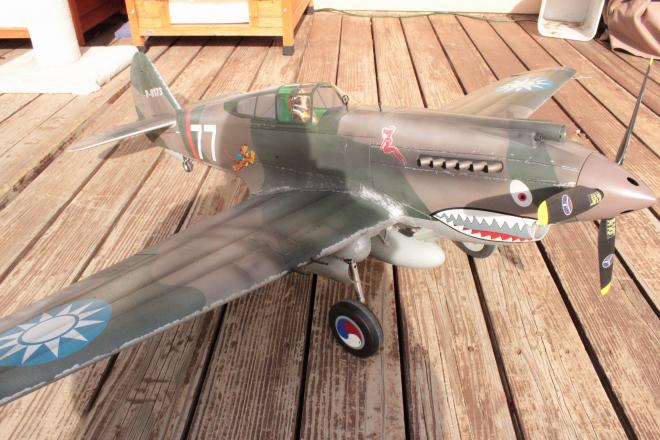

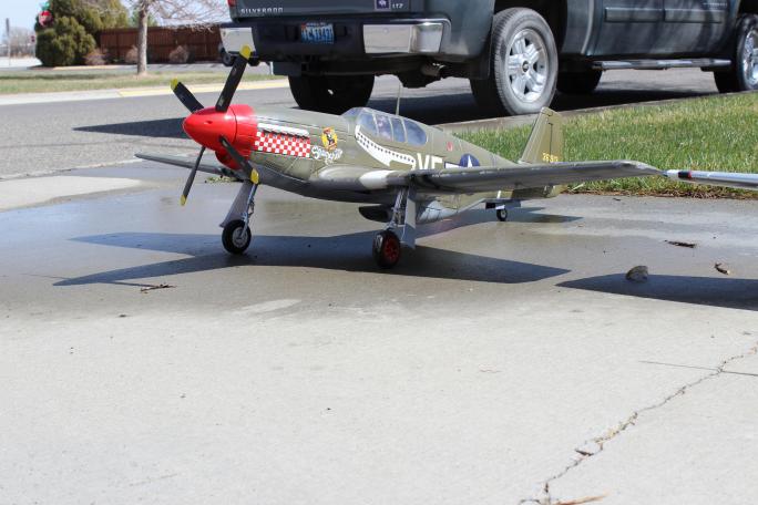

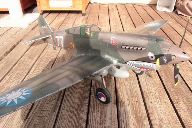

                  Hey Sea Viper. here's some of mine, the P-51B was my first attempt, the Pandora was number two and the P-40 was somewhere down the road!

                    Awesome work man!

                      Thanks Seavip, I want to point out as well that I use acrylics so everything is water based, (the majority are the little bottles that you get in the crafts section in Walley World) so clean up is easy. The key to it, at least for me, is layers (think of Shrek and onions!) The P-40 was the same method as the P-51B, go over the panel lines with a dark color then add layers of color over it. I went right through the Chinese markings on the wings of the P-40 with the dark color, it was either black or a dark brown, can't remember, but it really anchored the decals down into the plane I got the nice lines by using a piece of cardboard to 'mask' it. Light layers of white, tinted with yellow give the effect of faded green and believe it or not, the P-40 brown was mixed with left over green by adding some red to it and playing around with it. I had to match the color when I peeled off the original tigers and got the more authentic ones from Callie. You'd be hard pressed to see the difference!

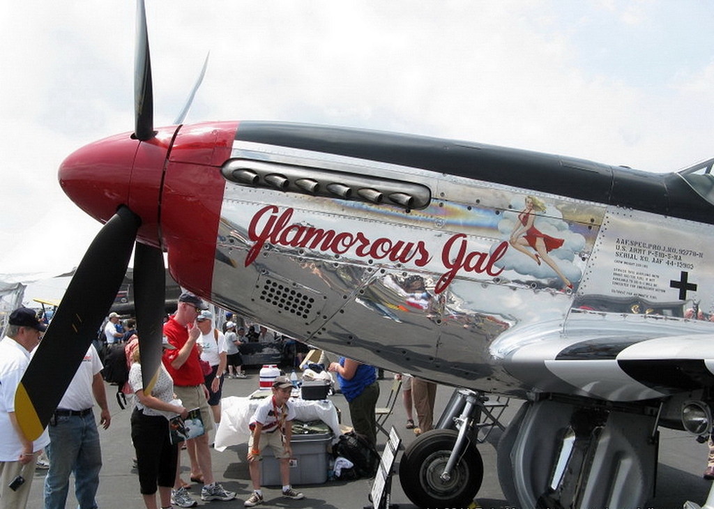

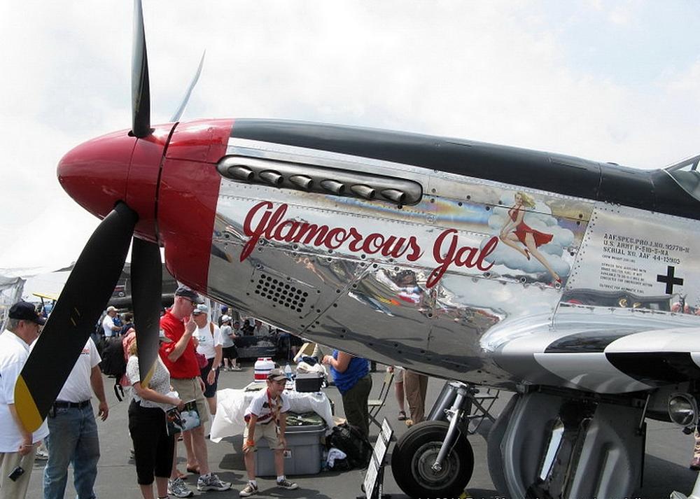

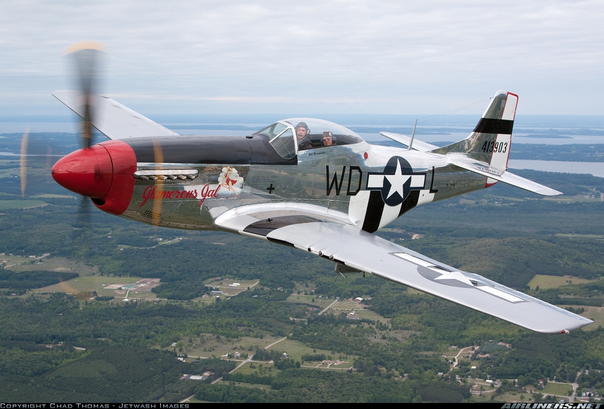

                            Great, thanks Grossman! So my first weathering job will be the exhaust trails from the turbochargers on my P-38. Should be simple enough. Do I use just black or a combo of colors to get a nice realistic effect?
                              • 7434

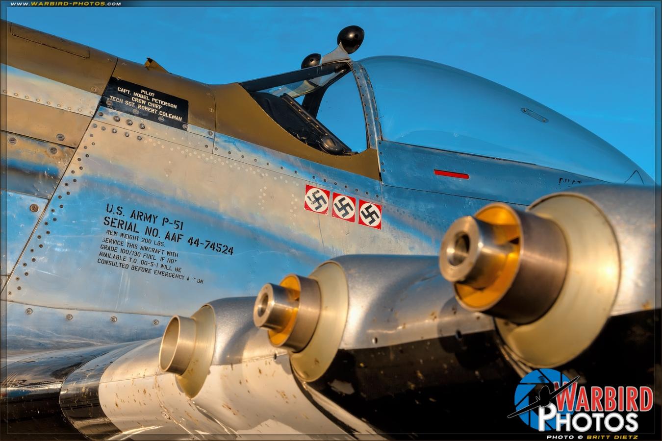

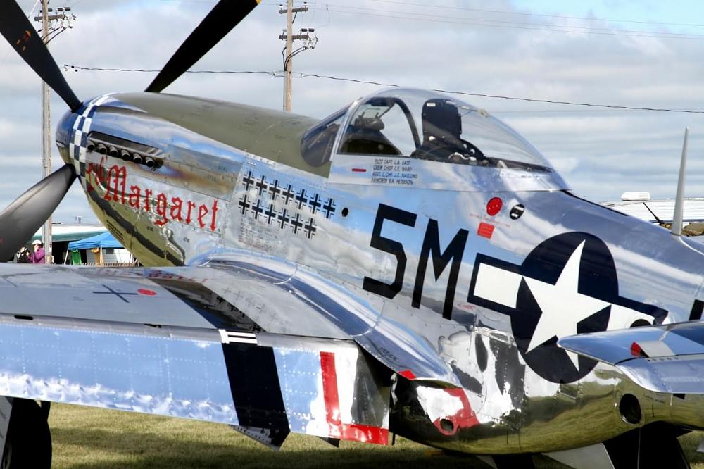

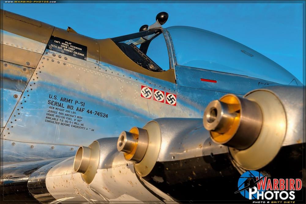

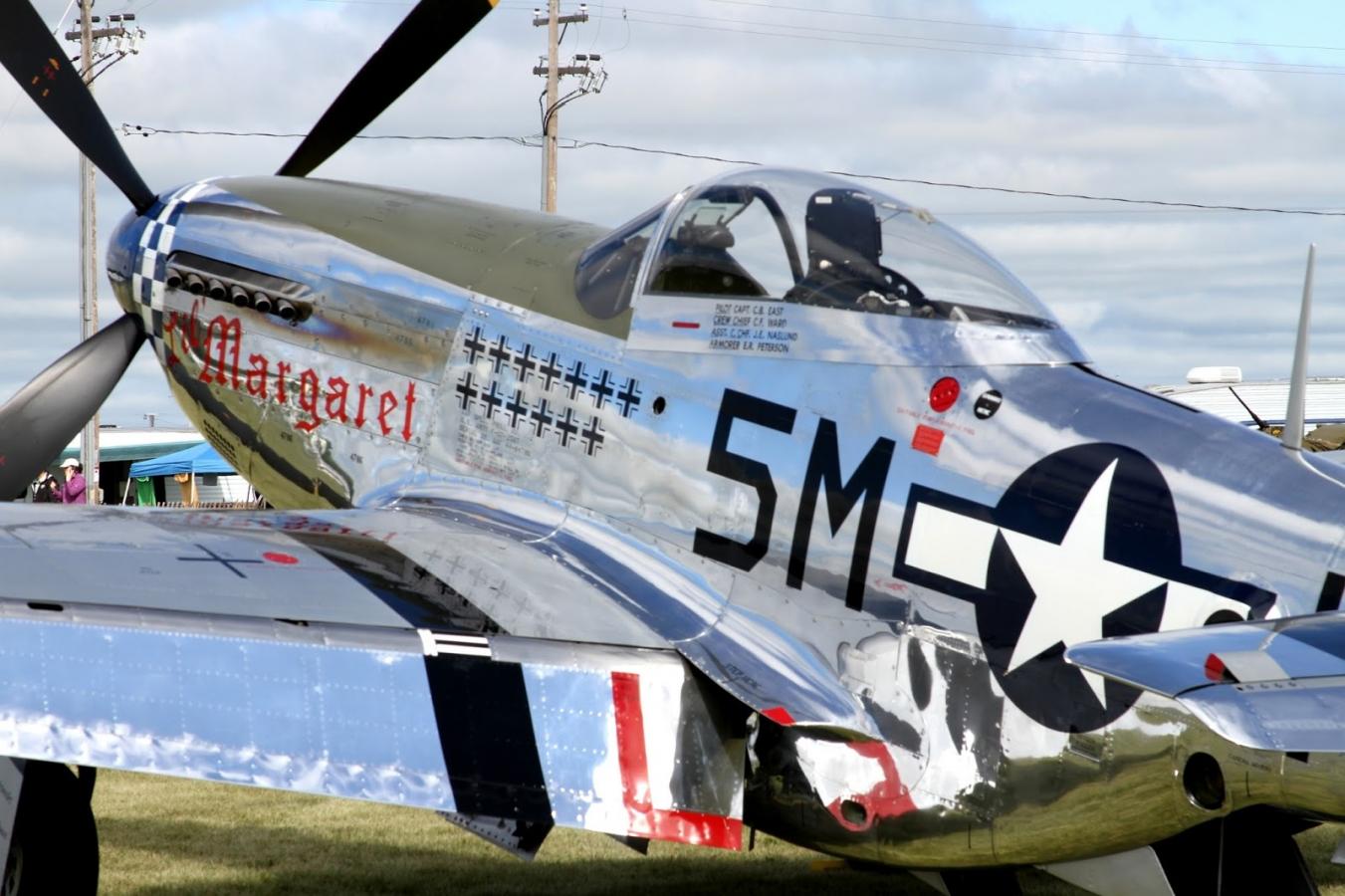

                              For the gun smoke and the exhaust stains I have used black, but extremely lightly and layer it up. I've noticed that a lot of exhaust stains have a rainbow effect, so I'm going to try the Pearlescent paint to see if I can mimmick that.

                                Grossman, mimicking heat staining is tough, but possible with those pearlescents you mentioned. I do layers of Tamiya clear yellow, clear blue, clear purple (mixed), Smoke, all over the brightest chrome I can find (even if the aircraft base color is not silver). That should give you the sheen you want. It's tougher to accomplish on a foam plane, obviously, but with surface preparation and sealing, a shiny and realistic finish is achievable. I agree with you it looks great on the real aircraft.

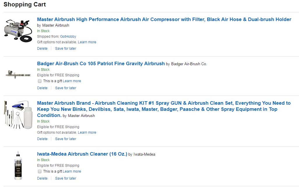

                                    Okay here's what's in my cart for Amazon...How does this look? What am I missing?

                                        Looking good, Aros. Keep in mind, that airbrush cleaner is only as good as what paint you're using.
                                        Two other tips:
                                        1) Buy a REAL respirator. Not a dust mask.
                                        2) Buy a set of 100 paint pipette/droppers. They're less than 10 cents each.
