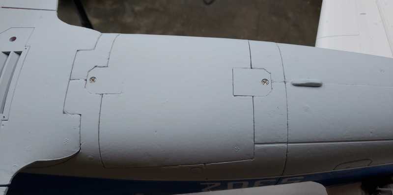

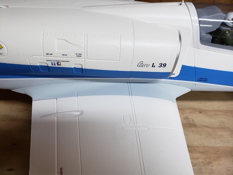

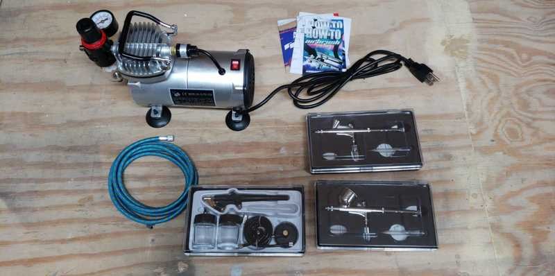

                                    Got my first airbrush finally! It's one of those $89 specials from Amazon. Works great. I have already used it to repaint part of my L-39 following a hard landing.
                                    I used those 50 cent craft paints from walmart thinned with windex and water. The brushes appear to be of high quality.

                                      I got a similar setup and have enjoyed it. I am planning to get a compressor with a tank on it though as the pressure drops considerably if you hold the trigger down. I have also gotten an in-line moisture trap that I mount right on the gun as enough spraying can lead to condensation getting to the nozzle. Not anymore!

                                        Be careful with Windex. The ammonia can have adverse effects on your equipment over time.

                                          #60
                                          I personally believe that the thinners, fingerprints, and even the paint itself are more corrosive than the ammonia. That being said, I do rinse the brush with water. I also run some mineral spirits through it as a final step.
                                          I have never had windex, or one of those clones of it, attack any tool. I have used it for years to clean up plated tools after paint or spackling. None have ever corroded.
                                          Now I don't know if the ammonia or the mineral spirits will harm the o-rings. But o-rings are relatively cheap and easy to replace. You kind of have to expect the o-rings to fail over time anyway.
