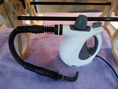

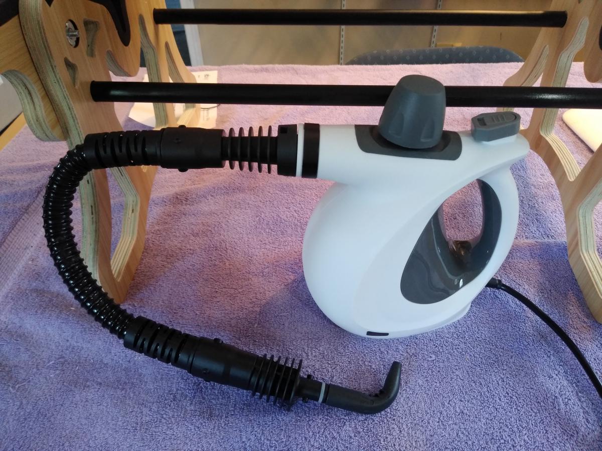

            Two years ago, we picked up a well used Carbon-Z T-28, at the NEAT Fair, for my wife to practice flying larger warbirds. It had a lot of dings and dents, but the price was right. She has since put numerous flights on it.
            Fast forward to now. It's time to freshen it up with a new paint scheme. First the dings and dents needed to be addressed. I ran across the video, linked below, for the best foam fix tip I've seen in a while.
            I now have a new favorite shop tool for repairing foam ARFs.
            Click image for larger version  Name:	Steam2.jpg Views:	0 Size:	120.6 KB ID:	255149Click image for larger version  Name:	Steam1.jpg Views:	0 Size:	182.4 KB ID:	255150
            This thing works great! It comes with several attachments and ran about $30. The bent tip shown on the right targets the steam to a small area so you don't affect the undamaged area. You can control how much steam and pressure is applied. Start a little bit at a time until the foam gets back to, or near, its original shape.
            Many areas went completely back to original. Some will still require some filling before paint.

                      If you are a balsa builder, it will also raise a dent out of balsa, as long as you get the steam to the bare wood. Or help soften balsa for sheeting.
                      But, wait, there's more. It can steam clean window, counter tops, fabric.... I like tools that are multi-taskers.
