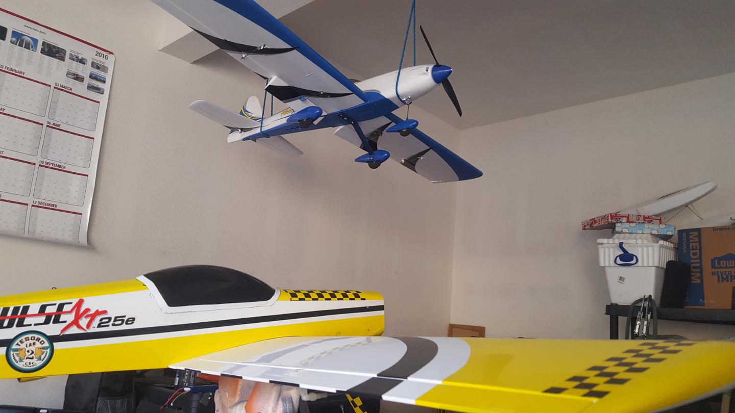

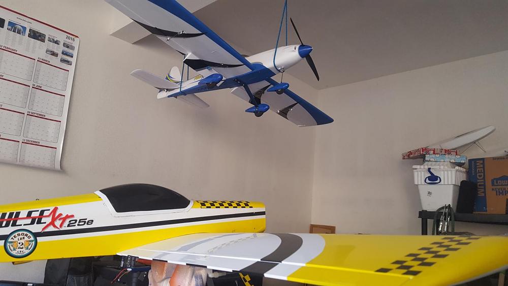

              dont do it , i tryed , motor hot, as well as the esc melting the foam an i used a 2200 4s from motion RC but instead purchase a pulse 25E,,, blown away Click image for larger version
