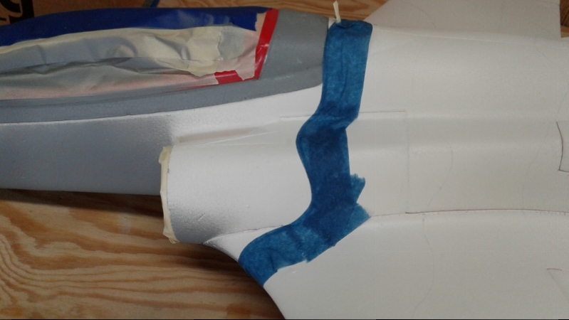

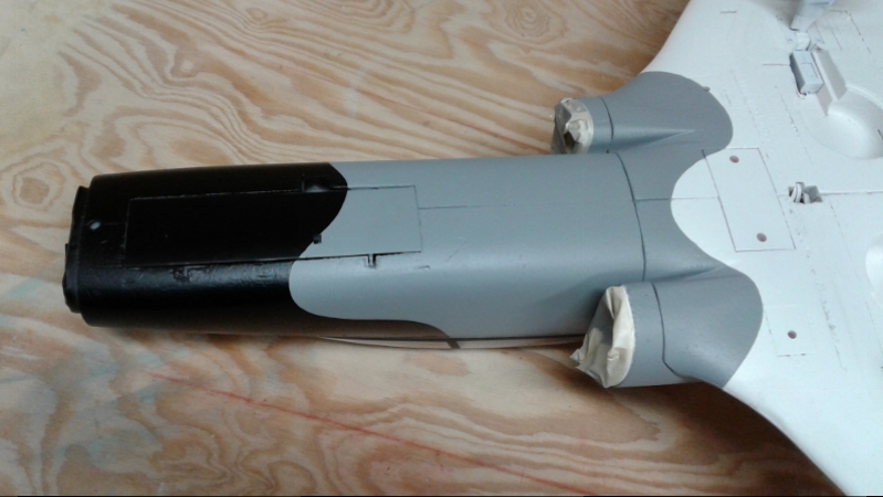

          Click image for larger version  Name:	 Views:	1 Size:	217.6 KB ID:	62452

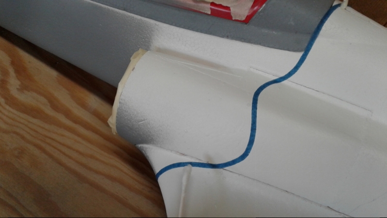

          Getting there step by step. I am using Valspar spray paint from Lowes. The masking is done with wet strips of cut paper shop towels. This doesn't lift paint when it comes up and it gives me a very slightly fuzzy edge.
          Pattern is my own design loosely based on the USAF scheme. I have a set of decals from Callie on the way. I will also be making some of my own decals as well as tinting the canopy.
          Prep work was rubber gloves, acetone, paper towels, and some elbow grease. I sprayed her with a good coat of that Valspar primer (lightly, from a distance) until i got her coated really good. Then I wet sanded with 220 grit sandpaper before assembly and painting. She had twelve flights on her before being taken down for painting.
          I need to find some good pilot figures for her.
          I first cut thin strips of blue shop towels with a ruler, a cutting mat, and a rotary cutter (all gifts from my wife's sewing collection...she gave them to me), wet them in water, then pull them around the curves much like when applying trim tape.
          Next I lay in bigger pieces behind the thin ones. After that it's just normal masking. I do ROLL a dry cotton swab over the edge before I paint and make sure there is no water on the surfaces to be painted.
          I would not try this with water soluble paints.

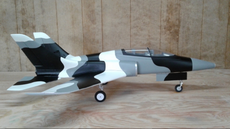

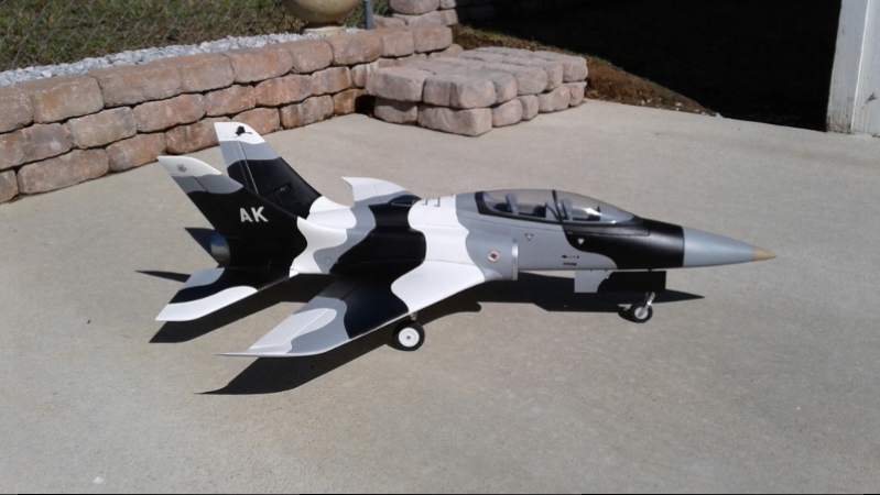

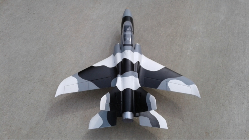

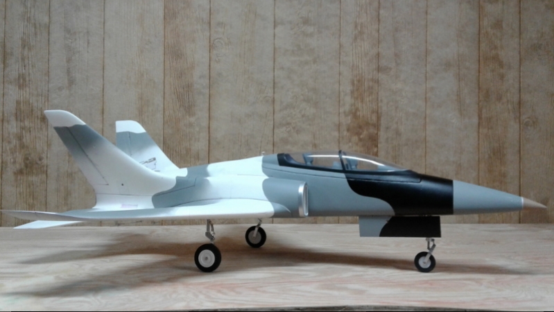

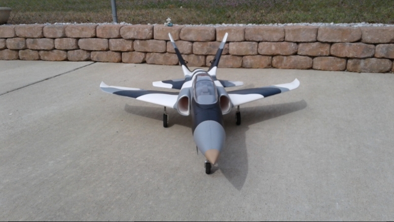

            Got the black painted today. Still have decals and the cockpit to do. I tried tinting the canopy with dye. No success. Edit: well maybe a little success. I am trying different methods. Click image for larger version  Name:	 Views:	1 Size:	205.9 KB ID:	62562
            Click image for larger version  Name:	 Views:	1 Size:	225.5 KB ID:	62560
            Tomorrow I will re-install the electronics and the power system and set everything up for flying.

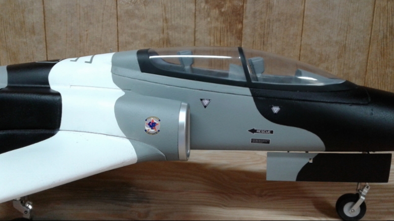

                            Got started with the vinyl decals. These are from Callie Graphics and are of the highest quality. However, I still prefer water slide decals.
                            But with this black I had no choice.
