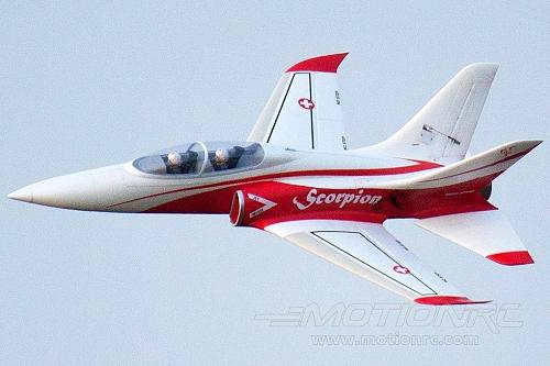

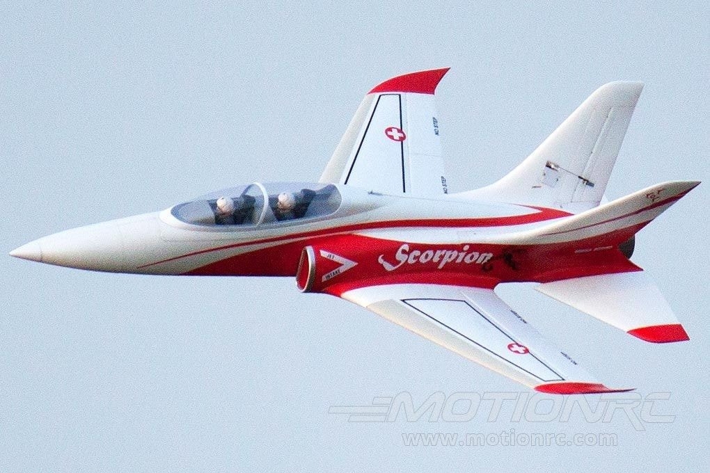

              Hi Boots Whirlygig, here is a photo of the Freewing 80mm Super Scorpion in its stock form:
              The product page on our website contains more photos if that's what you're looking for:
              I agree with Seaviper that on a foam electric EDF jet this size, the weight of a couple layers of paint is insignificant and will not perceptibly affect the aircraft's performance. Traditional methods of refinishing wood planes, be it with dope, sheeting, glassing, painting, clearcoating, and other methods certainly did pose a potential weight increase which depending on the model's size and how extensive the resurfacing was.

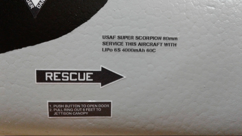

Name:
                  Got the decals finished and satin clear coat applied. Almost ready for flight status. Just waiting on my JHH 1/12 pilots.

                    Hello Seaviper.......you making your own waterslide decals?? If so, what brand decal paper ?? The "service this aircraft with.............." decal. :Cool:
                      • 8223
                      #30
                      Nice touch, I like that! I may have to "borrow" that idea for future use. :)

                        It's the clear inkjet decal paper from Bel USA (decalpaper.com). It works great. This time I used Valspar gloss clear to spray the decal paper. The decals came out a bit stiff. I had to wet them with denatured alcohol to get them to stay put.
                        Next time I am going back to the Krylon Crystal Clear for spraying the decals. I have had good success with Krylon before.
