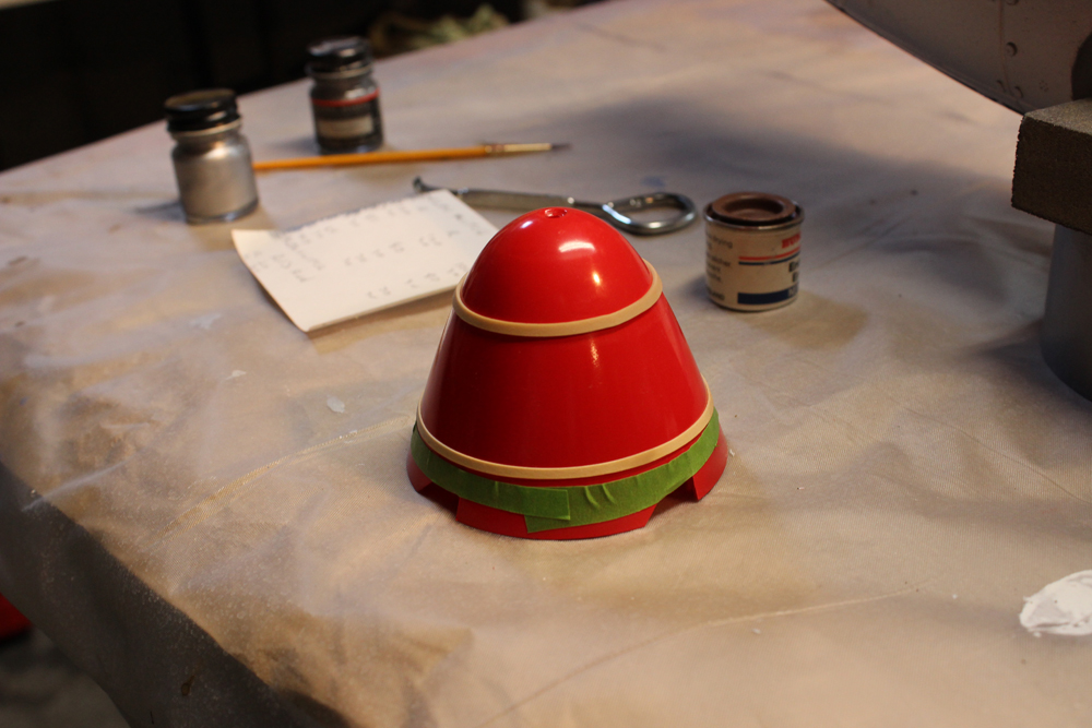

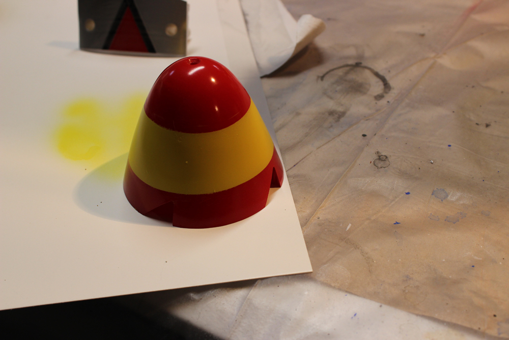

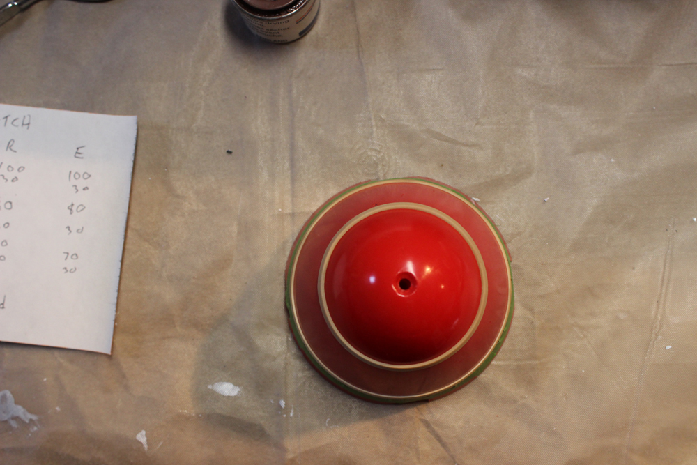

                  If you missed it, I had the challenge of painting a stripe in the nose cone of my 'Old Crow" which I converted from a Freewing Iron Ass.  After trying different methods of taping, all to no avail, I came up with this...
                  By using two elastic bands and lining them up from the side and from the top, I was able to create a great even stripe around the nose, I just taped off the rest, from the top of the rubber band down to the base of the cone.

                        Yeah, I seriously thought of that too, or at least scribing it, but what a mess if you don't get it right the first time!  I would suggest getting the wide flat elastic bands. getting the lowest one on first and putting the cone together, then supporting it with a paint brush handle or something that will fit through the motor shaft hole.  Then you can spin it and fine tune it .  Then do the same with the top one.  It also helps to look straight down on it as you can see in the picture.  I was just sitting on the couch playing with tape, with no success when the light went on.

                          Did you hand brush it or airbrush? Do the rubberbands leak paint through with the hand brush?
                          • #33
                            RE: Painting Foam Airplanes
                            Actually, I airbrushed it, thin layers at a time. maybe three or four if I remember right.  What you can do if you're worried about paint bleeding through is to coat the area with a clear coat first to help seal the area.  I found that with the air brush, I didn't need to.  The biggest problem I ran across was pulling paint off when I removed the masking tape, even after sticking it to my shirt a few times.  Frog Tape has a delicate version that seemed to help a lot.  When I did the Red White and blue on the Pandora. (First pics of her when the painting was done, has been modified and cleaned up since then, I replaced the gear and left it white, I like it better)

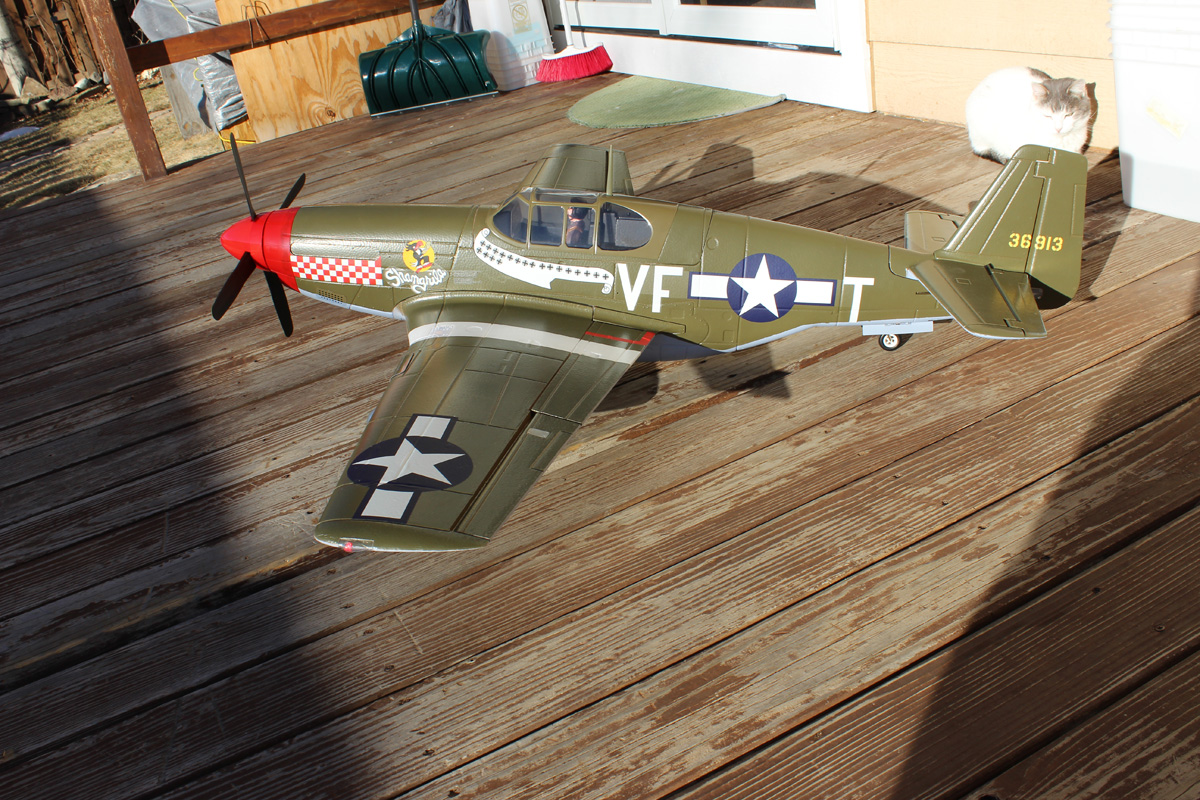

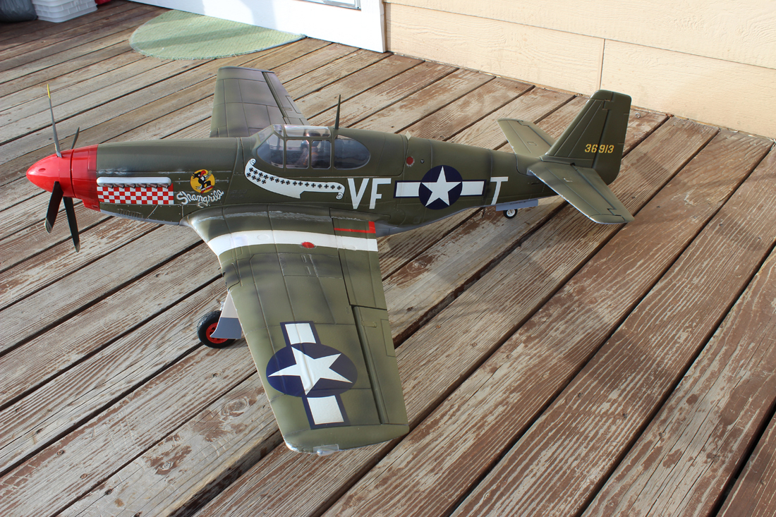

                                Thanks Pheonix, but believe it or not, the Pandora was my first experience ever with an airbrush.  I went on You Tube and found a few tutorial videos and took it from there.  Its a lot of fun when you get into it.  The second was Shangrila which I decided to age and weather, the difference was amazing.  I've had people comment that she must be pretty old and shocked when I told them (at the time) that she was less than a year and had never been in the air!
                                With her, I went to Ace and got them to color match the grey and the green.  Then airbrushed all the body lines with black paint (light coats!) then played around with the paint color, adding some white to give it the faded look, and maybe some yellow here and there because green will fade to yellow.  For the grey, same thing but stuck to adding white,  then in the end, if it wasn't faded enough, I'd go straight white, but really thinned out, it looked too much at first, but when it dried it was perfect.  If in doubt, grab a piece of card board or an old wing or other spare part and try it out.  I was extremely hesitant at first, and getting the consistence of the paint right was a challenge (like milk is where I started) Ace or Walmart both have small tubes of Acrylic craft paint and they're great but you can't beat the deal you get if you get a sample matched to your color.  One time, they were on sale and the girl mixed it up and charged me a buck!
