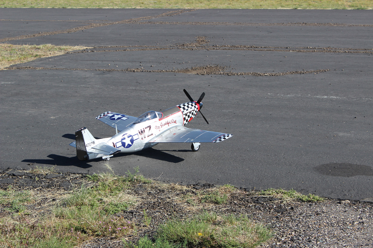

                      I have airbrushed Minwax on and its okay, but I really like the results I get with a foam brush.  When I'm through painting, I let the paint dry and set, maybe three or four hours (acrylics) and then brush on Minwax.  Depending on how many layers you want to apply, you can either wait for it to dry or carefully use a hair dryer at low temp to dry it quickly, just don't heat the foam!  On low temp, if you keep it moving across the surface its fine.   With My aluminum colored Mustangs, I have maybe four coats on them and they shine like they've been waxed.  On my Camo version (P51B) I used the satin finish Minwax and it works just as well, just without the gloss.  Also, you can use Minwax as a glaze.  Mix it with a small amount of color to vary the tones in different panels, by doing that it pretty subtle but it looks great!
