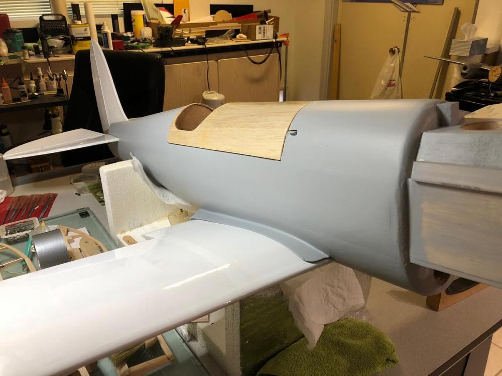

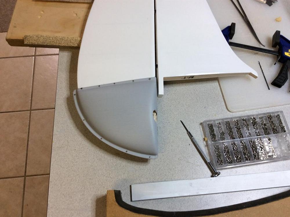

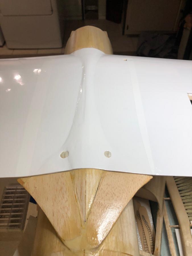

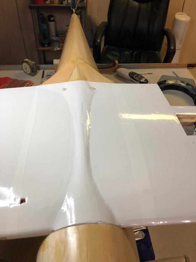

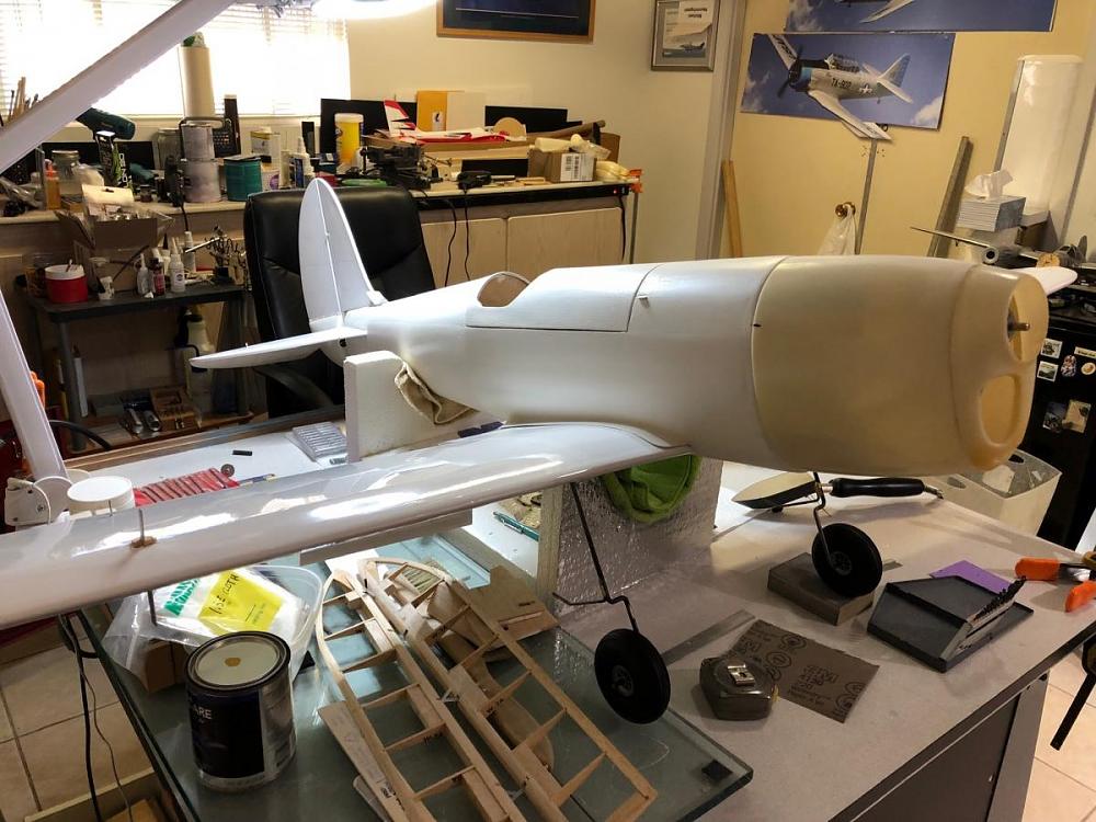

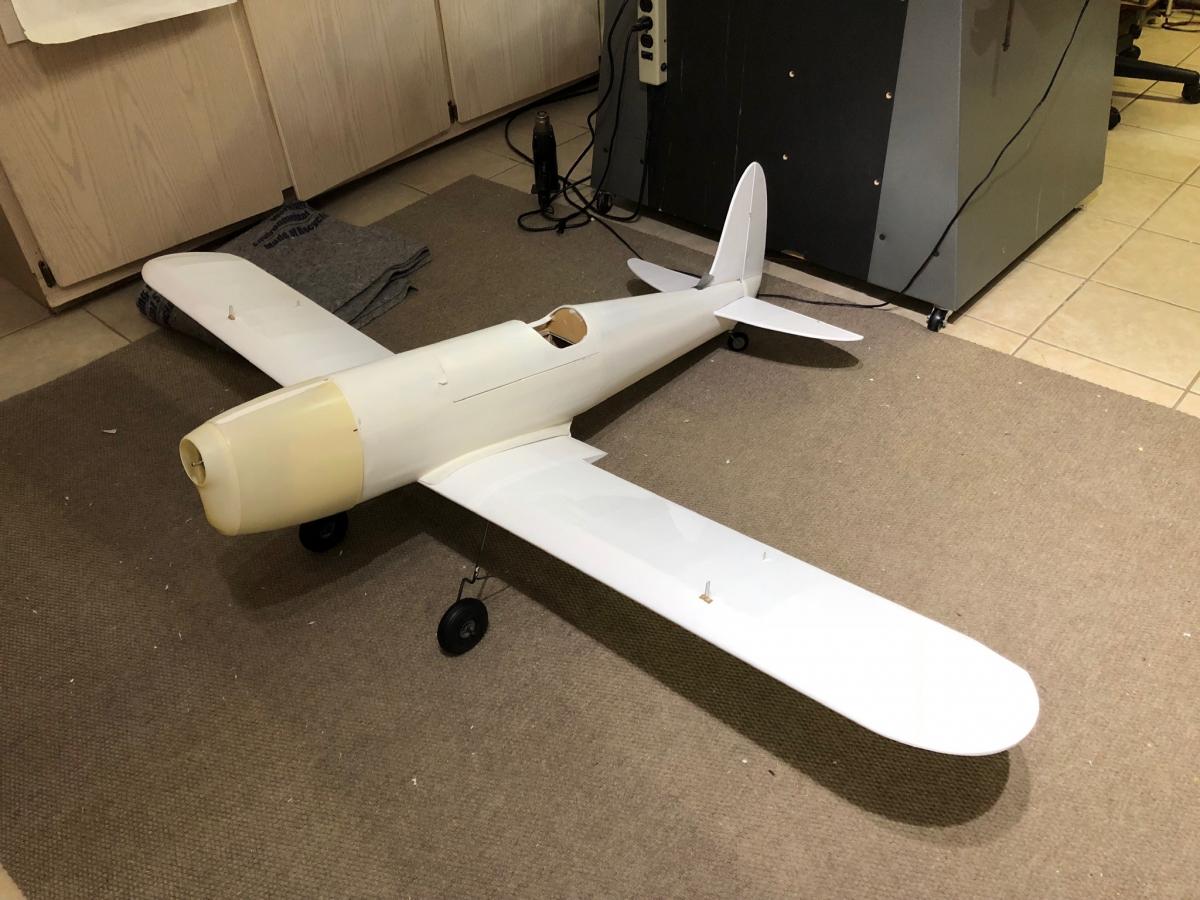

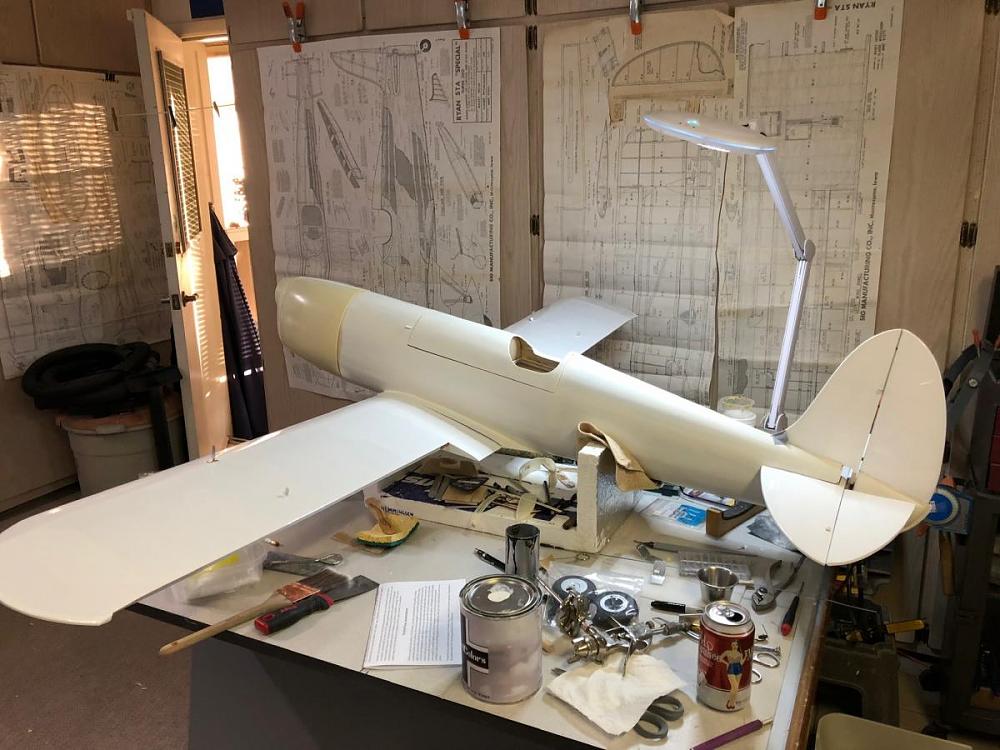

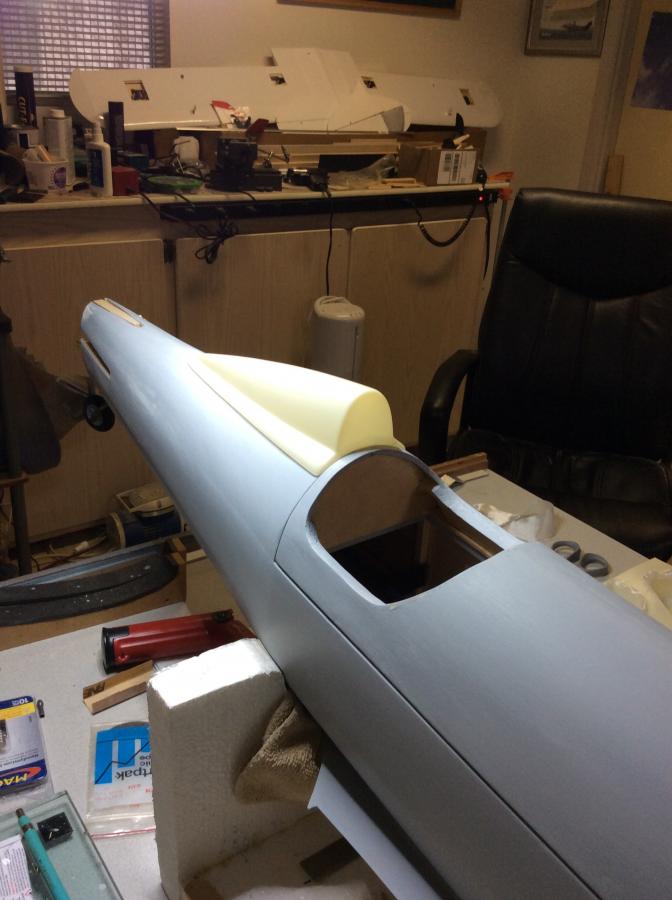

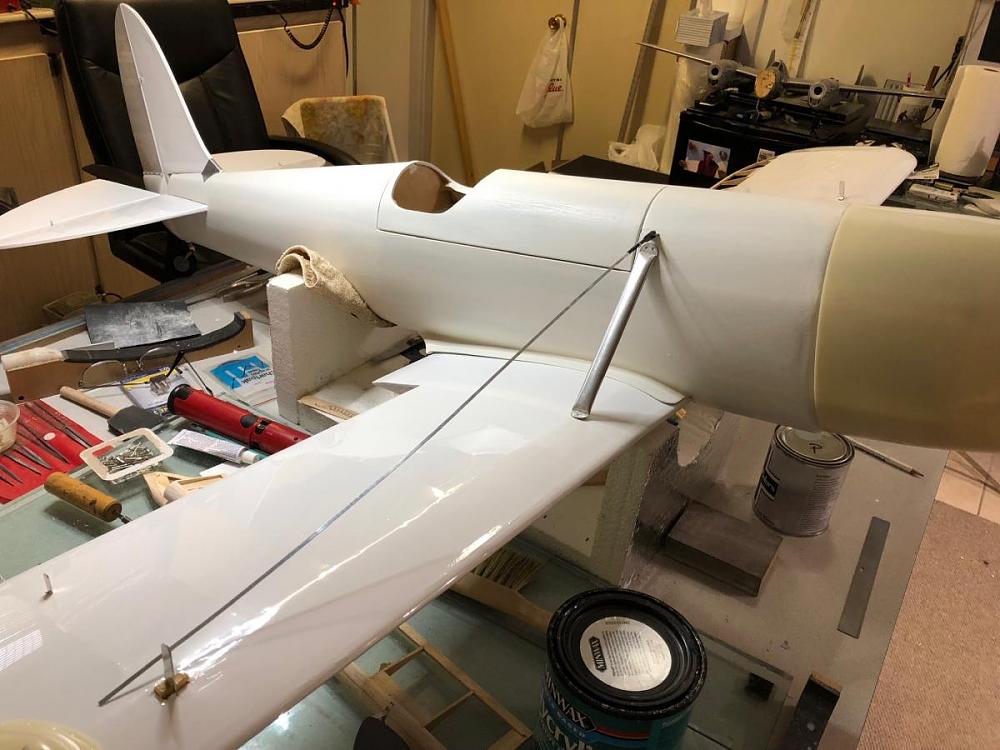

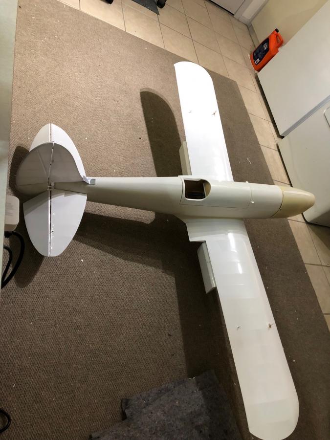

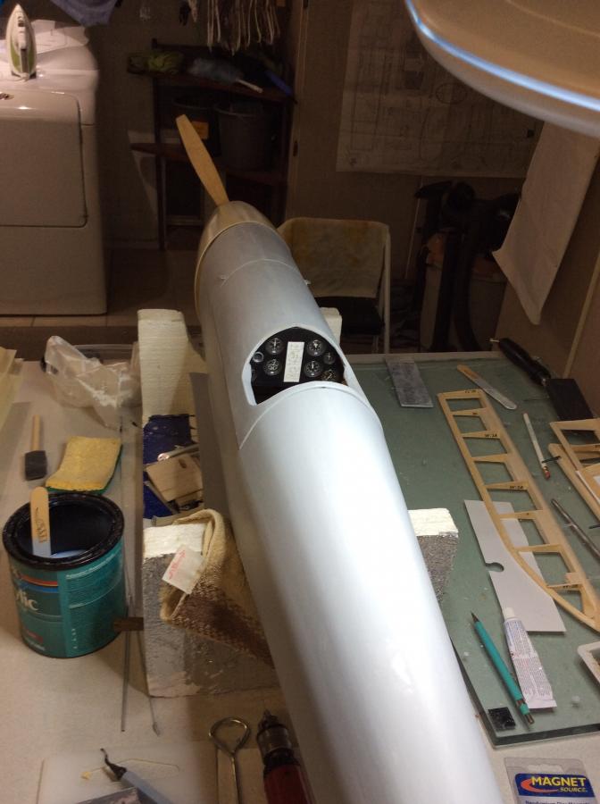

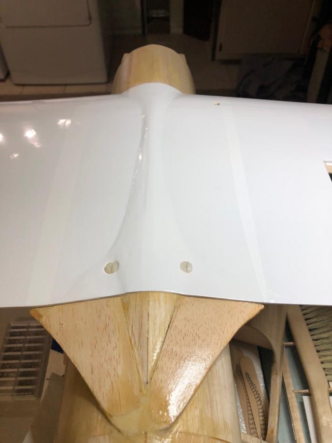

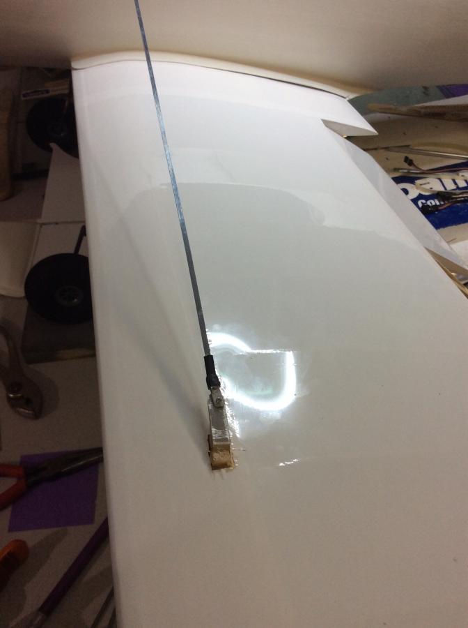

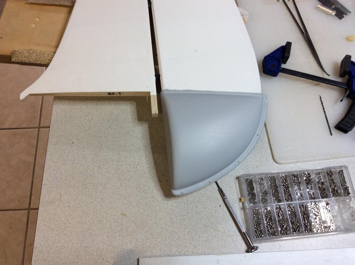

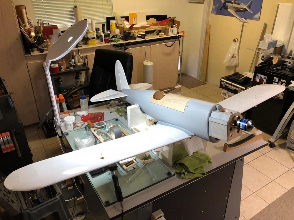

    Primer going down and wing is covered. Click image for larger version
ID:	153197Click image for larger version
ID:	153198Click image for larger version
ID:	153199Click image for larger version
    • Woodcock
      Old Returning Pilot
      • Apr 2018
      • 830
      • SoCal
      #122
      Nice! Woody
        #123
        Looking great!

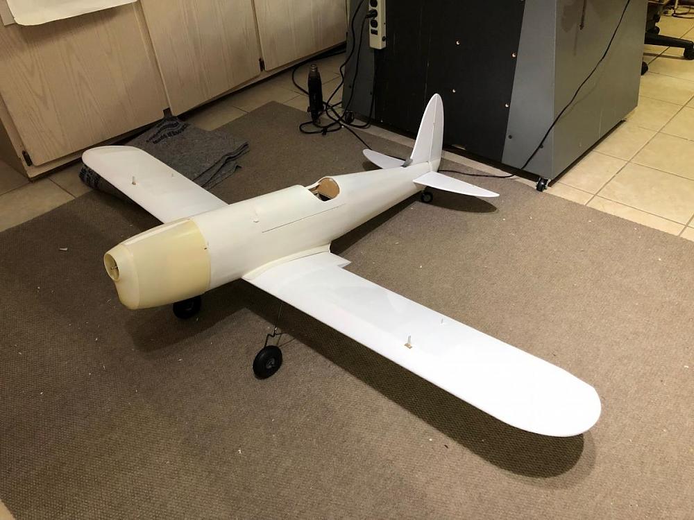

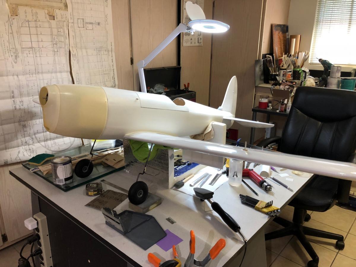

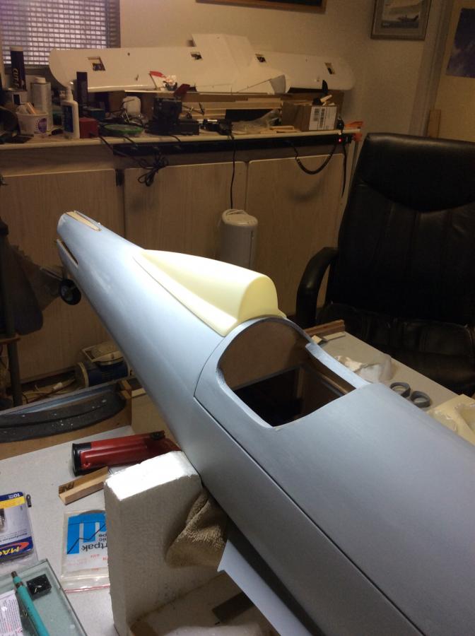

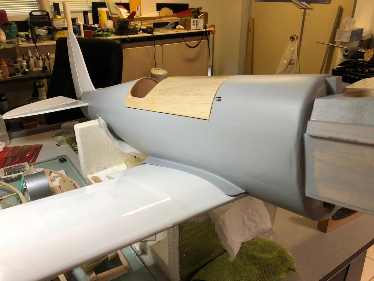

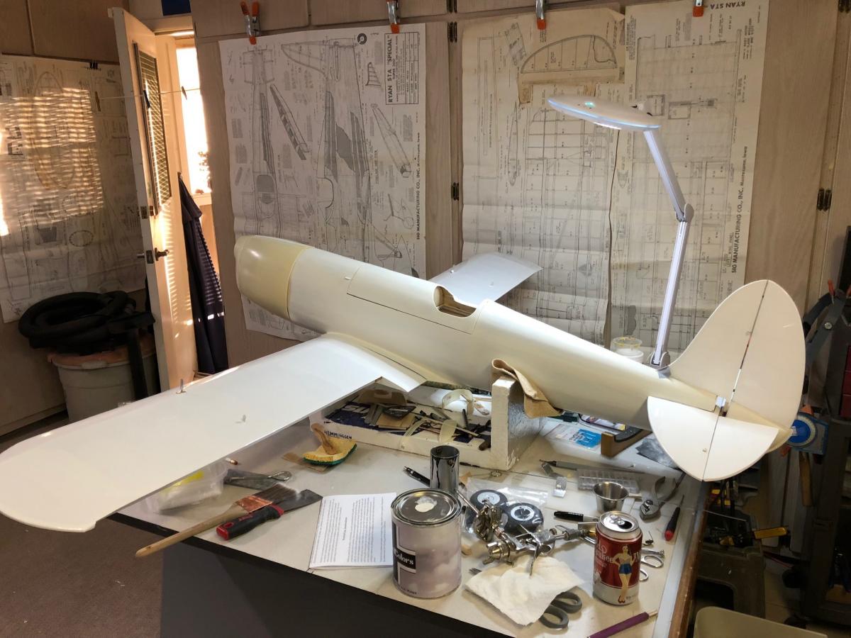

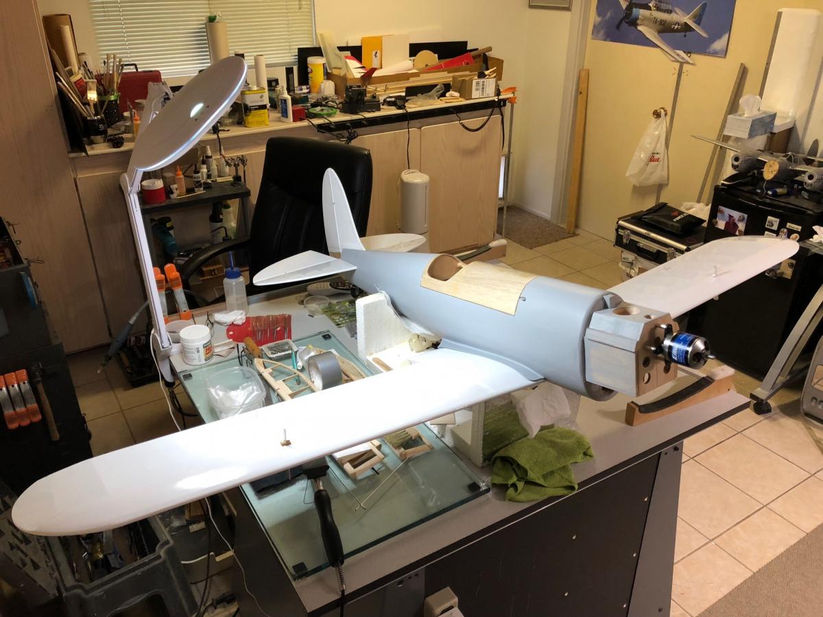

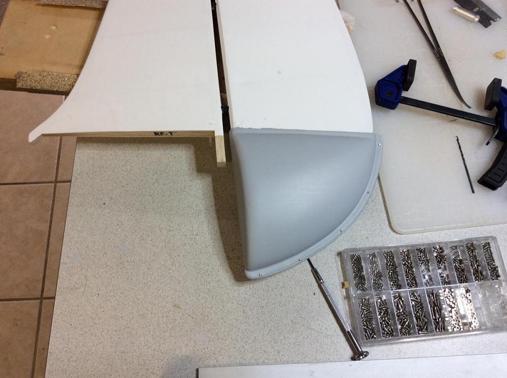

          A little visible progress between primer coats and sanding.
ID:	153499Click image for larger version
            #125
            What is this primer substance you speak of????? :Drooling::Confused::Silly: Looks great Bro!!! Spray, sand, sand, sand, repeat..... :P
            • F22trainer
              Piper PhD
              • Mar 2018
              • 1484
              • Sun City, Az
              #126
              Don’t even need a sprayer - using a disposable foam brush! I will spray the clear after Graphics go down, just to give the depth I want.

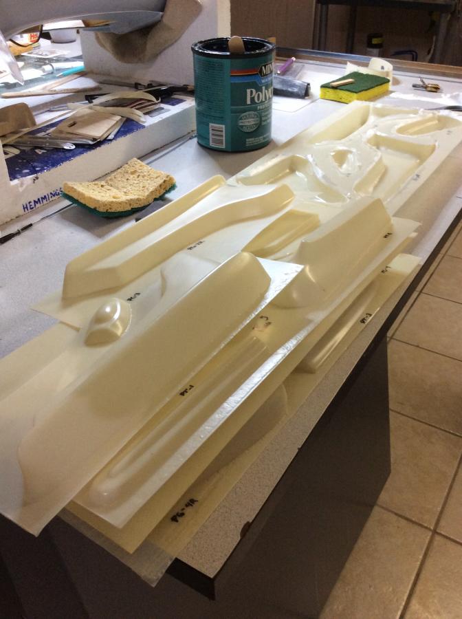

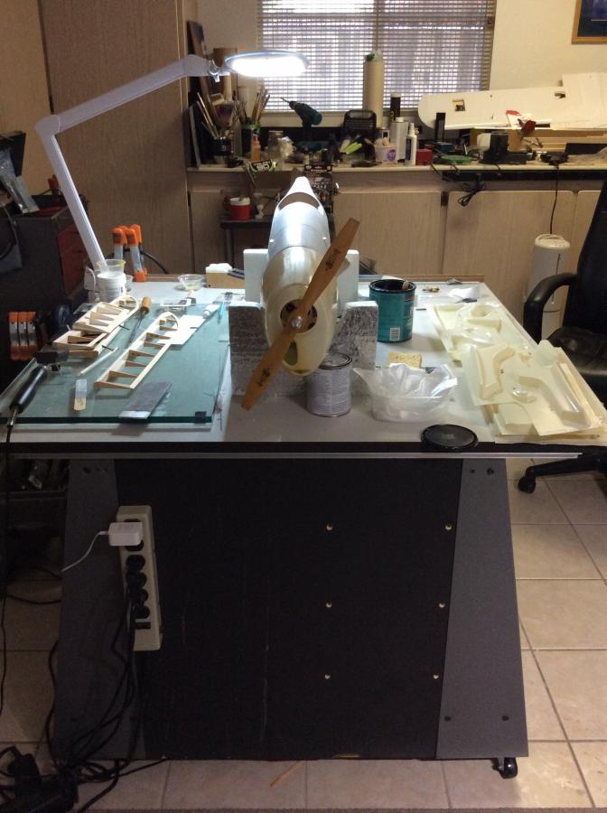

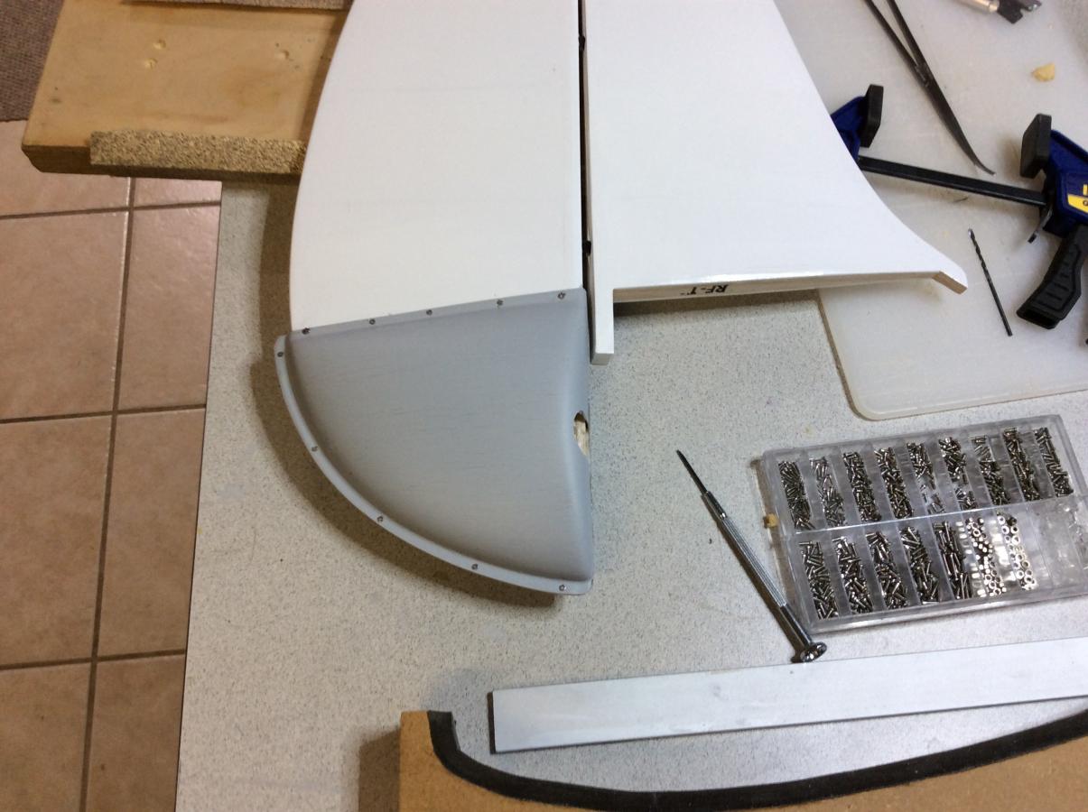

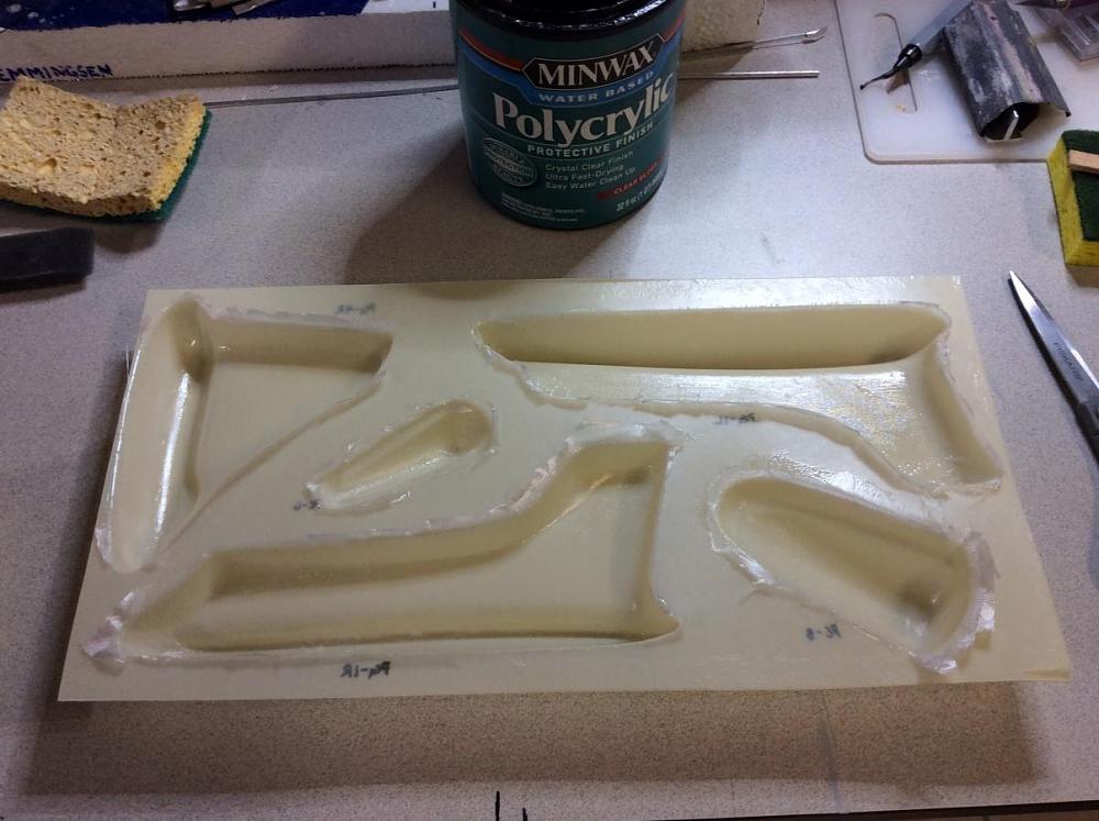

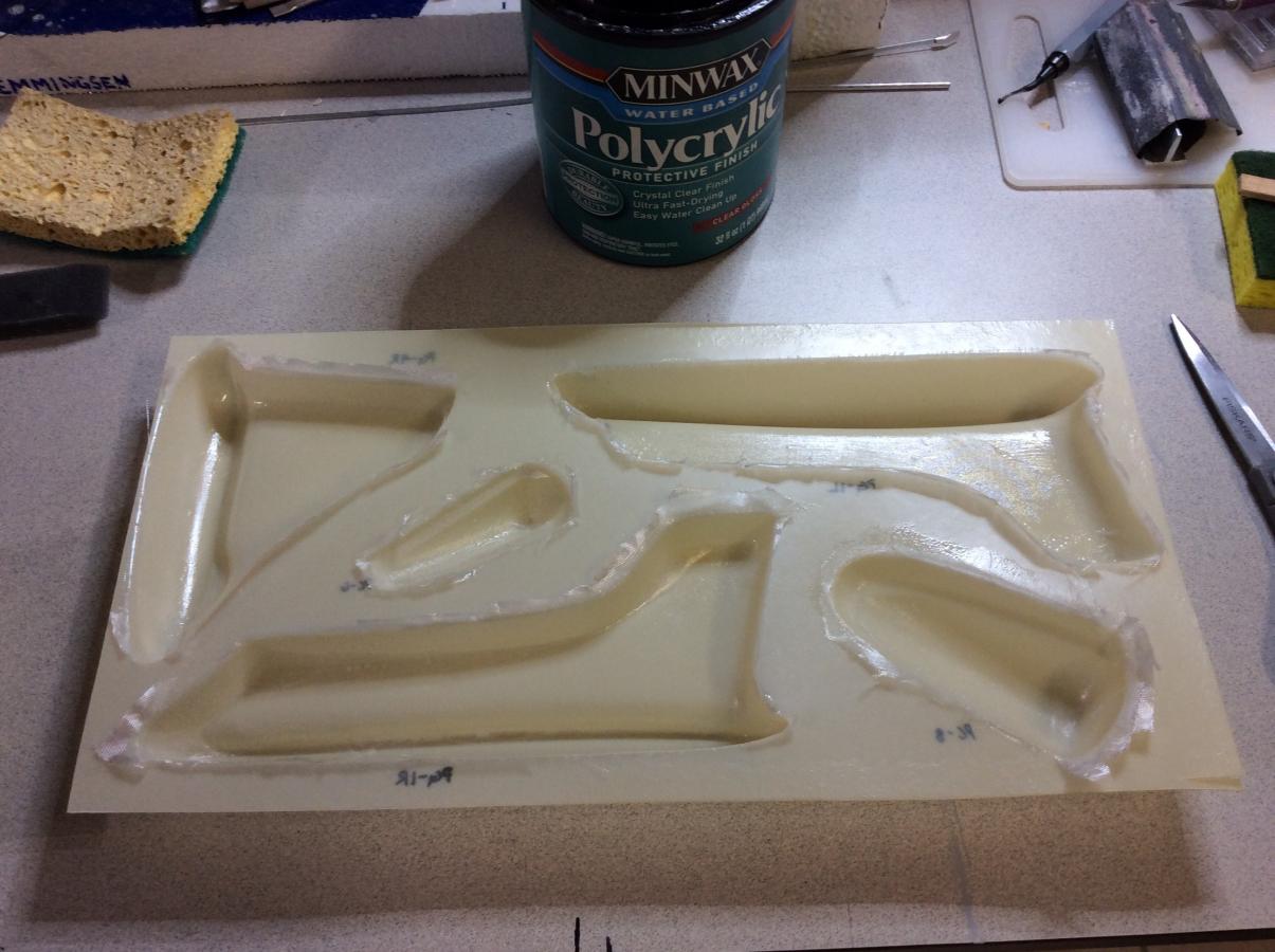

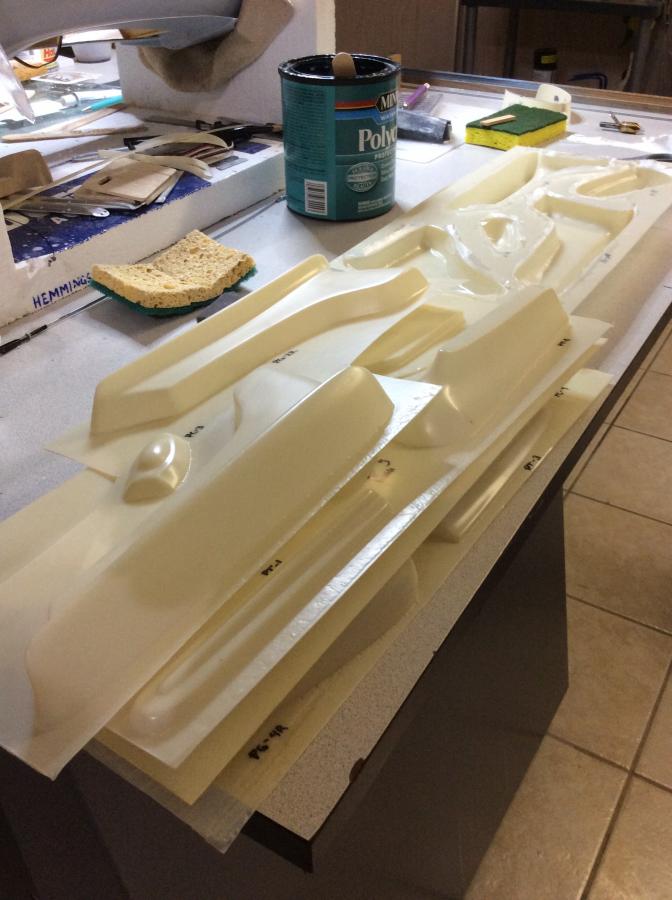

                Time to bump this thread to the top again. Couple of pics of the coolest new technique with the Polycryllic and glass cloth. Because these are parts for the landing gear and pants, I used some heavier cloth - 1.5 oz as opposed to the 0.5 oz used over the fuselage. Plastic parts take on a whole new level of strength. No split edges, no fractures around drilled holes, reduced flex yet still easy to trim and fit. Click image for larger version

                  #128
                  Nice! I cant wait to see the colors
                    #129
                    The only way I glass parts.....Been using this stuff since 2007-2008.
                    Bye bye epoxy or polyester resin

                      #130
                      :Goodbye: my models were all stored away and my life was about to take left 90 and a right 270. I’m still finding new techniques everyday. But the last time I had cut any balsa, an EDF was the running joke and Astro-Cobalt was pretty much all the choice

                        #131
                        I do similar but I like using silk instead of fiberglass cloth.
                        I grew very fond of using silk in the 1970's.

                            #133
                            I could see that working well also, especially with really thin plastics. I’ll remember that!

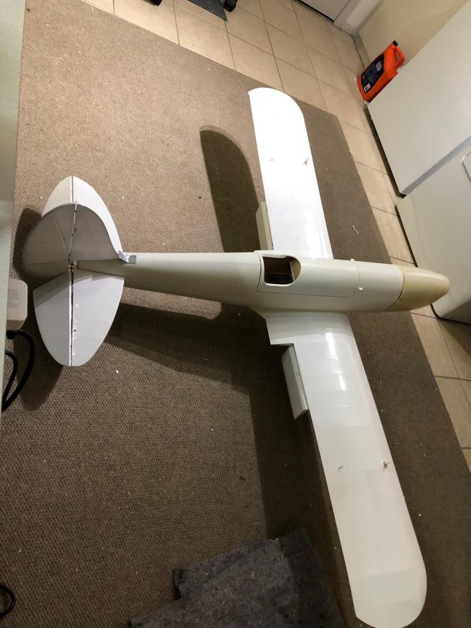

                                  #136
ID:	155335Click image for larger version
ID:	155336 She has some color, only 2 coats now, but it stands out so nice. I think I will spray the next 2 coats along with the clear. Measuring wires and starting that bit of tedium...

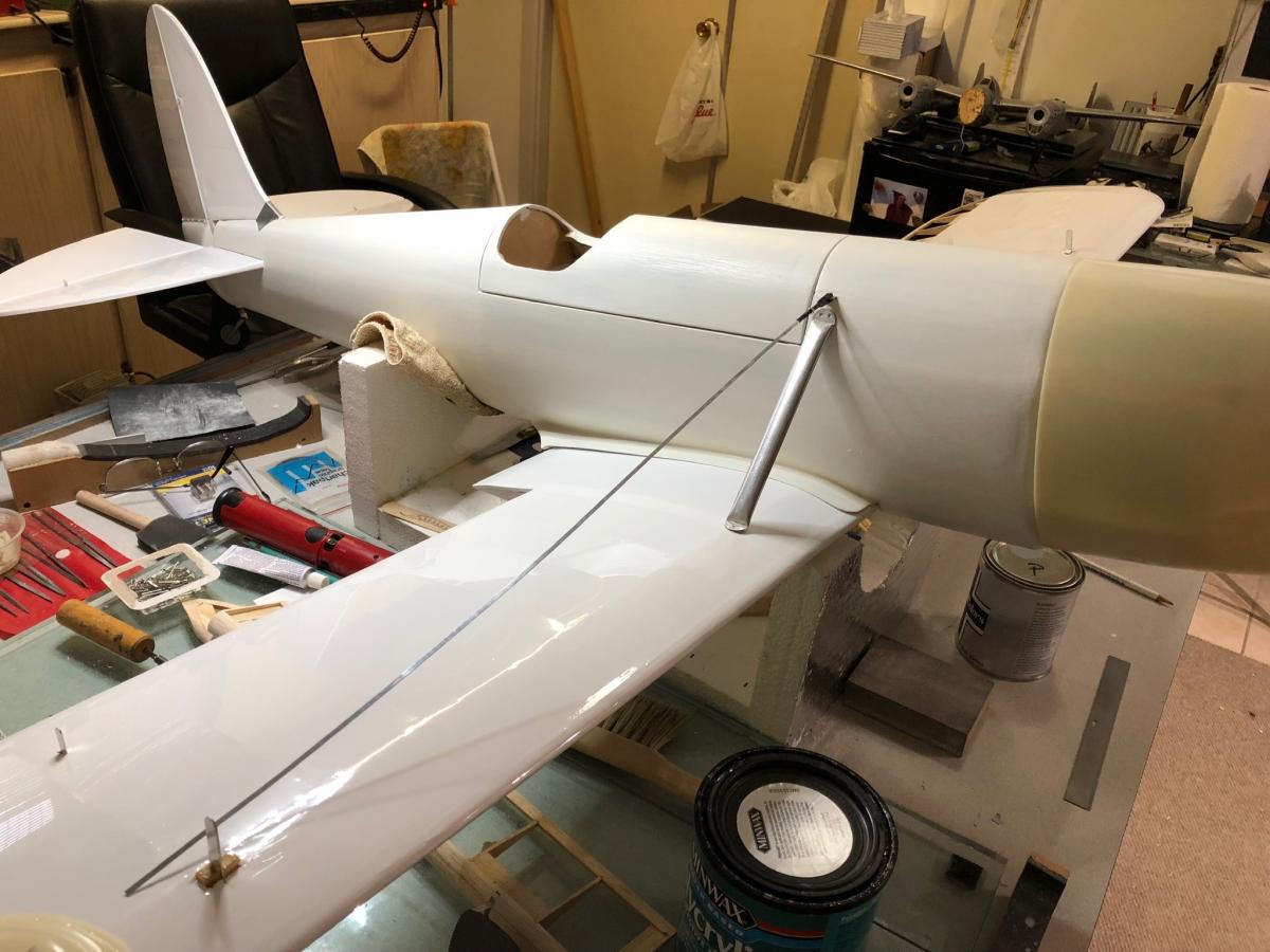

                                          #140

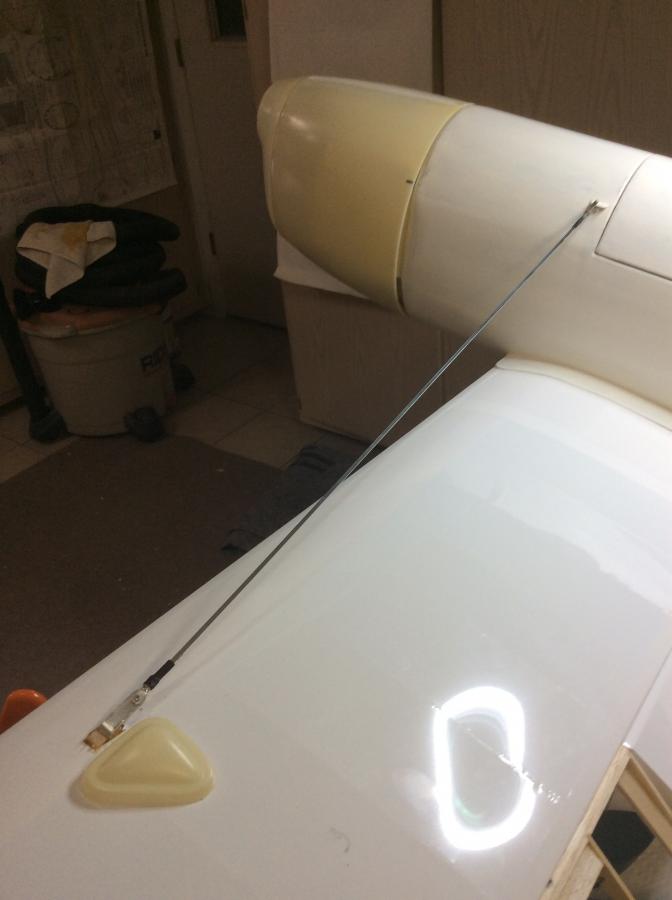

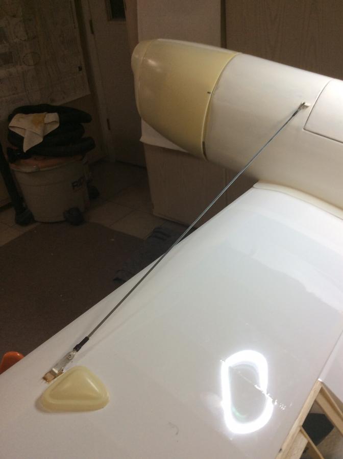

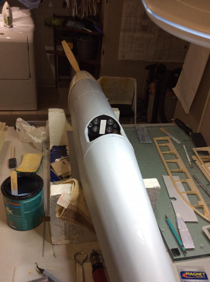

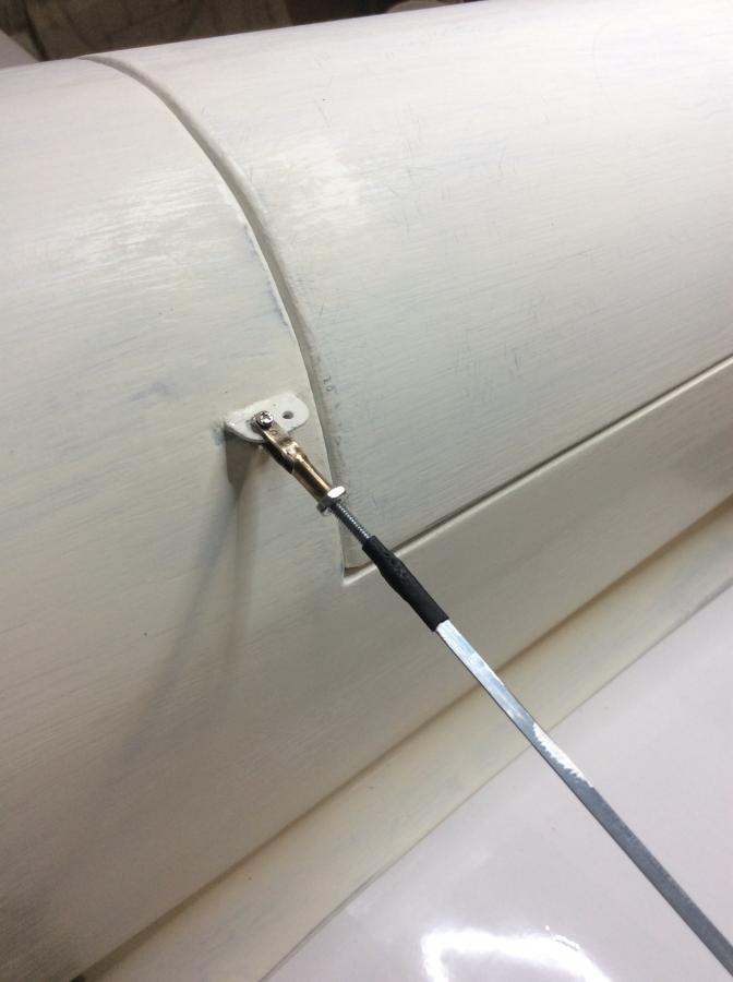

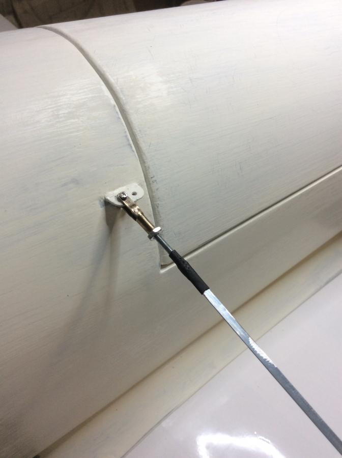

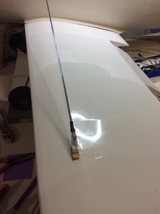

ID:	156313 Wanted to do some spray today, but rain was the order for the day. Lots of sanding and fitting. Flying wires now inevitable, so to work I went. Click image for larger version
