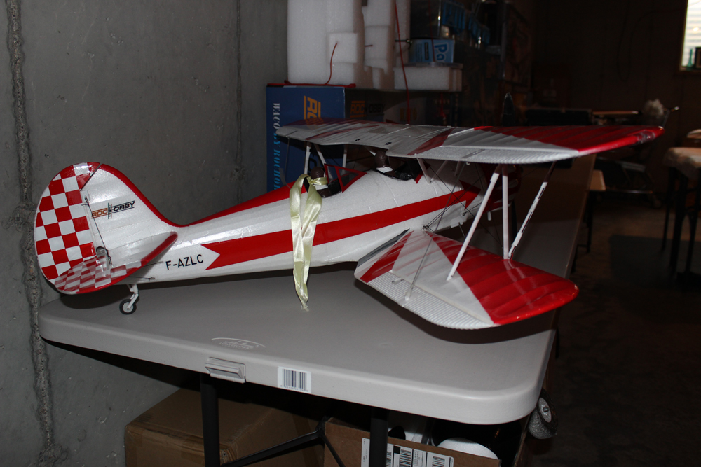

                        Bills right, she does like to fly.  For the fun of it, I put a long piece of ribbon around the rear pilots neck so he has a scarf blowing in the wind, it looks way cool!
                        By the way, she doesn't like to keep her pants on!! did a mod that I covered in All Us Newbies. and it was semi successful. I combined it with some Elmers Rubber Cement on the upper end of the pants that touches the fuselage. It looks good, just waiting for the weather to clear to try it out

                          In hind site I neglected to ask Boomer if he ordered the yellow or the red and white.
                          I'm glad you inserted your beauty in the avatar so he could get a look see.
