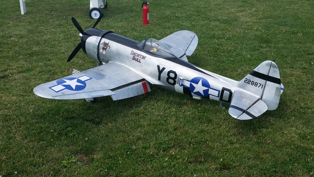

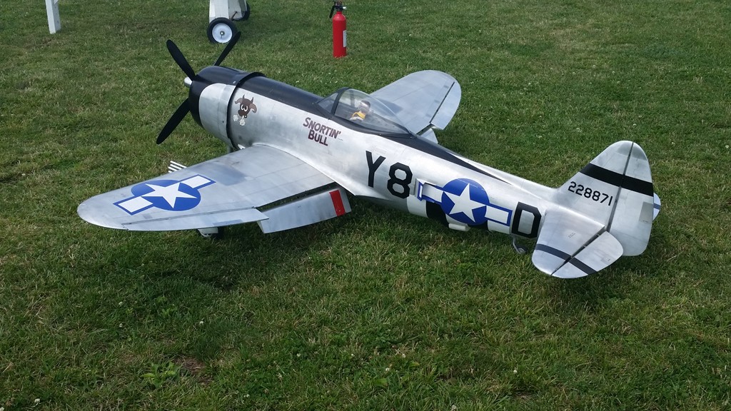

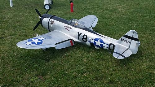

                    ROFL, Not all the airframe will have Nashua tape.(AKA Duct tape). The lower parts of the fuse will have monoKote. I say" Do A good range test always on the ground before first flight." I've used this tape and Flight metal many times with good results.
                    My 86 inch P-47 covered in Flitemetal
                    Link To Flitemetal: http://www.flitemetal.com
