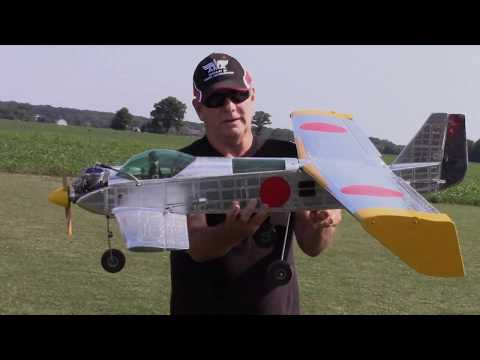

    Test flight was bad, I mean very Bad. 10 seconds maybe of crashing. Tail heavy for sure and not much to do but cut power and watch it come back to earth. I've took today to look over the set of plans and I talked to Art after the crash at the field so I'm working out the C.G. again. Started the repairs today as well not really a lot wrong. Just some time and I'll give this one a go again. Crossing fingers that I find the right C.G. Back to work!

                      Yes that is some good info, I've read a lot of the canard C.G. calc. but this is not a b
                      asic canard CG: has as much as 3 times the area in front stab, front stab is also 2 deg. off from side to side. The model also has built in washout of 2 inches on the wing tips only and the ailerons don't follow the washout. This is a as I built it and not even what some of the plans called for. Plans called for 4.1/2 inches in front of the main wing root and that is tail
                      heavy. I'm sure if I move it forward 1/2 inch to 3/4 inch it will fly. But I'm still working on the C.G. slowly before I do anything with it.
