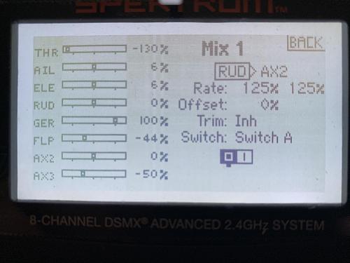

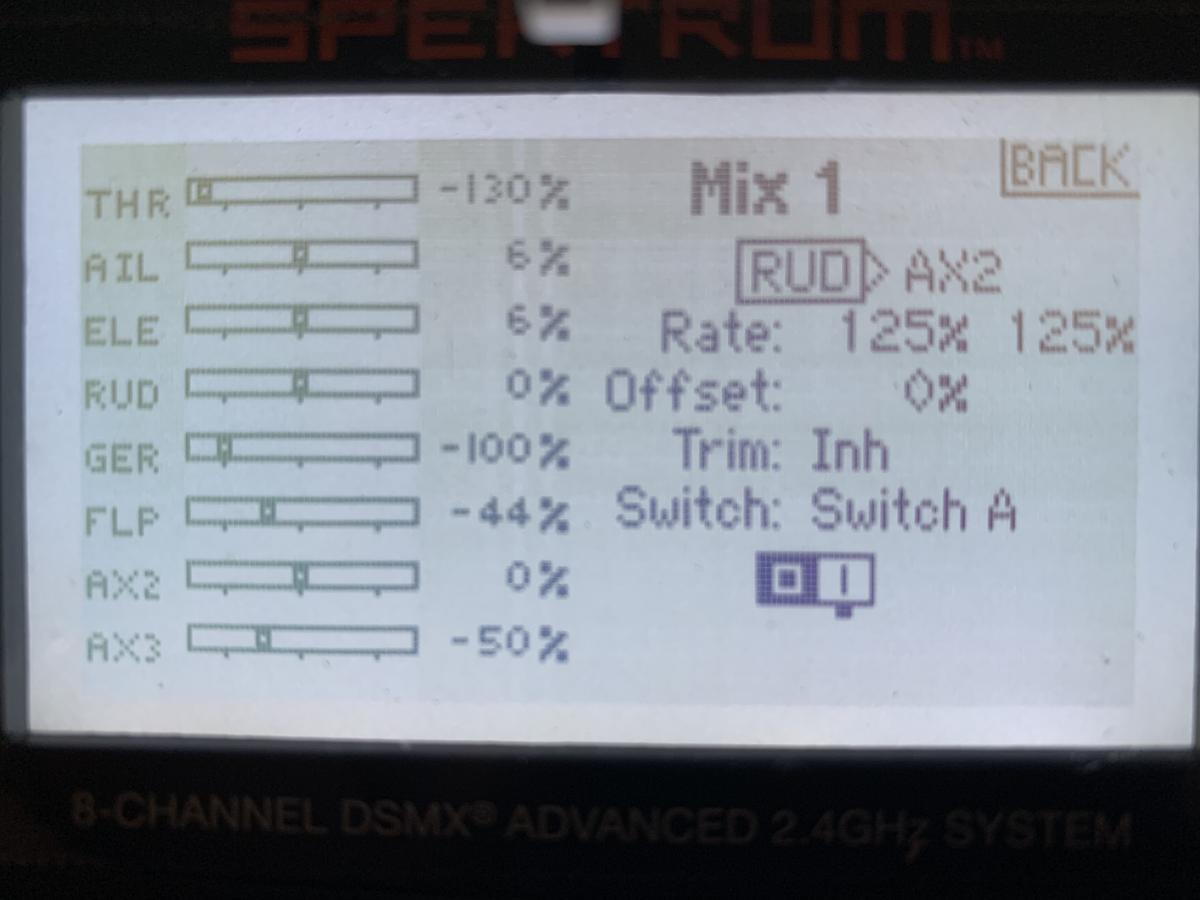

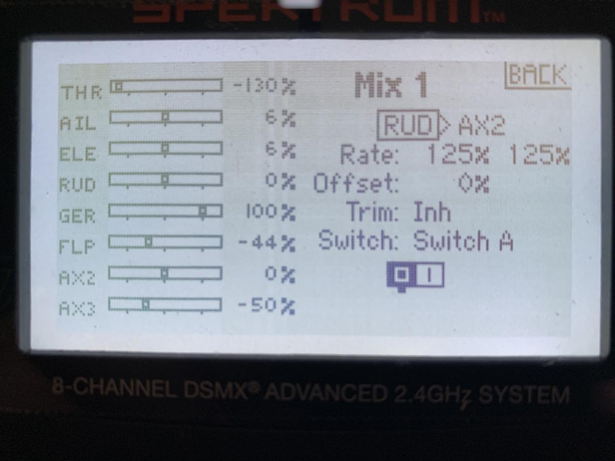

Maybe something is getting lost in translation. Here are 2 photos of my mix screen. Remember, this is on a DX8 and with my A-10. The principle should be the same.
The first picture shows "gear UP". Note the little dot under switch position "1". It's "white". If you move the rudder stick, you will NOT see any movement on the monitor for AUX2.
In this next picture, you will see "gear DOWN". Note the little dot under switch position "0". It's "blacked out". If you move the rudder stick, you WILL see movement on the monitor for AUX2.

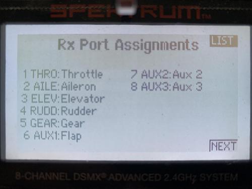

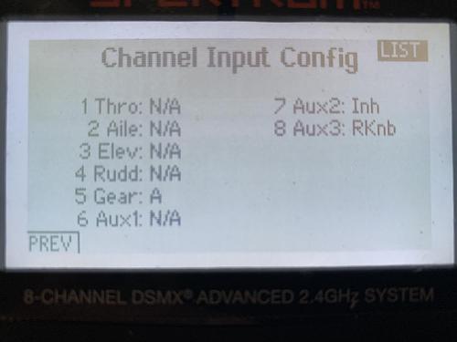

Now, just in case there are more missing information, here's 2 more pictures. This is in "System Setup", "Channel Assign". 1 is of the "Rx port assignments. Note AUX2 (for you, it will be AUX5). Next is of the "Channel Input Config". Also, note AUX2 (AUX5 in your case).
As far as I know, ALL of these settings must be this way in order for this to work. Miss one and it won't work.Comment
Thanks again xviper. Everything seems the same but the last two screens are different on the IX12. Still tryingMaybe something is getting lost in translation. Here are 2 photos of my mix screen. Remember, this is on a DX8 and with my A-10. The principle should be the same.

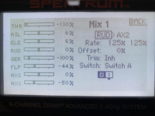

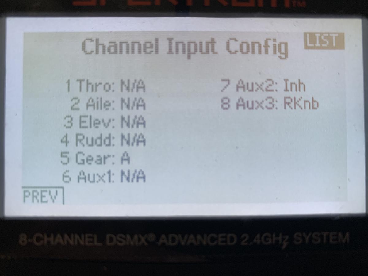

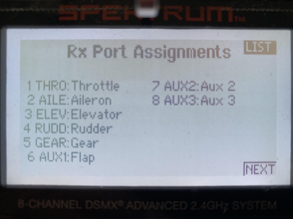

Thanks fhhuber. Like xviper said it's an IX12. Was already planning on low vs high expo for rudder and nose steering. I use expo exclusively vs dual or triple rates. BTW the screen for mixes on this radio show me what's responding and not responding when I mess with rates etc. If I think I've made a breakthrough, then I take the trany out to the garage and initialize the plane to verify. Right now, since there is no cockpit installed to block the nose wheel from steering in the retracted position, I can test it a little in the up position to verify workie- no workie. These are stock retracts provided with the kit as an option. Then I sent them to Down and Locked to have them converted to electrics with a controller that is programed to handle the gear door sequence. Anyway,I'm thinking I have missed some little detail that I've overlooked....maybe on another screen.....but haven't found it yet. Currently, I have six other planes I fly with this radio with no problems, although this function is usually handled by the blue box. But this one little detail has me stumped.:Thinking:Comment
