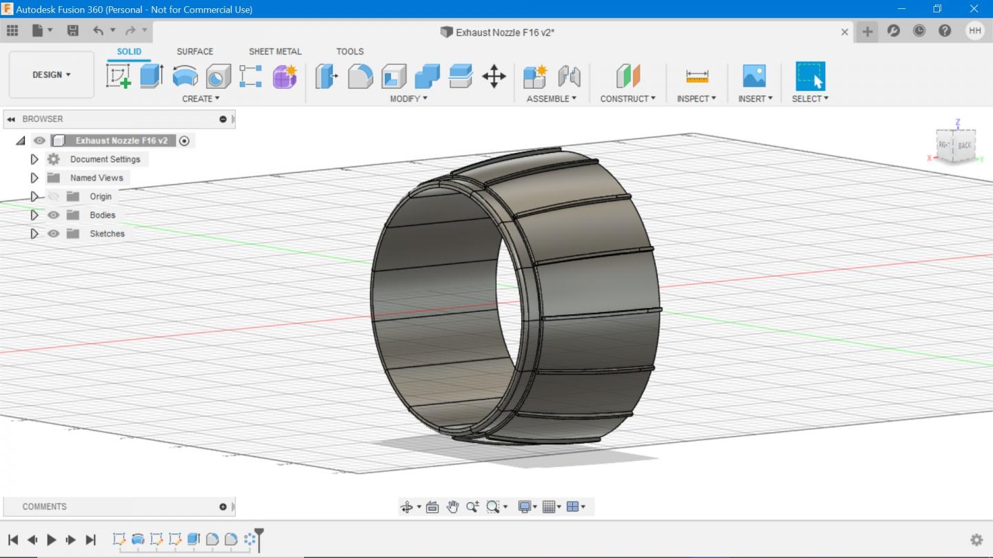

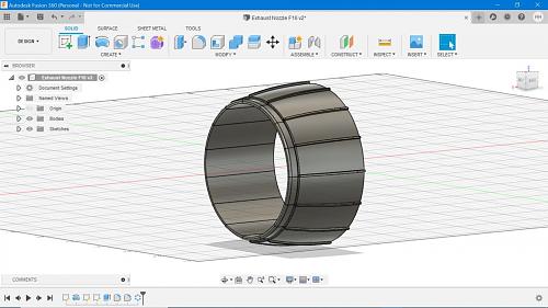

                #47
                Okay, thanks Alpha! I'm still messing around with it to see how I can ensure it allows me to design on the surface select. When I select it, the program doesn't automatically snap to the axis view once I select an axis at times. Maybe I have a setting incorrect, but is likely my fault in the procedures.
                From an art standpoint, I tend to think in a non-3D way, so I'm adjusting that. Ha-ha
                Be gentle with the comments, the picture below is of the first 3D Model I have ever made. It's decent. I didn't do anything special like figuring out how to taper each side of the pedals, make the pedal shape different on one side versus the other, create detail, etc. because I haven't figured out that part yet.
                Click image for larger version  Name:	3DM Ex.Nozzle.jpg Views:	0 Size:	124.1 KB ID:	268548

                    #49
                    T-CAT For your first 3D model I will say it looks like you have a future in creating 3D models! Well done my friend! Looks great to me!
                      • 2137
                      • On planet earth....right
                      #50
                      Thanks Aros! Alpha is an excellent instructor.

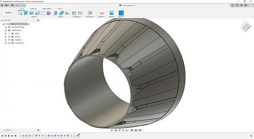

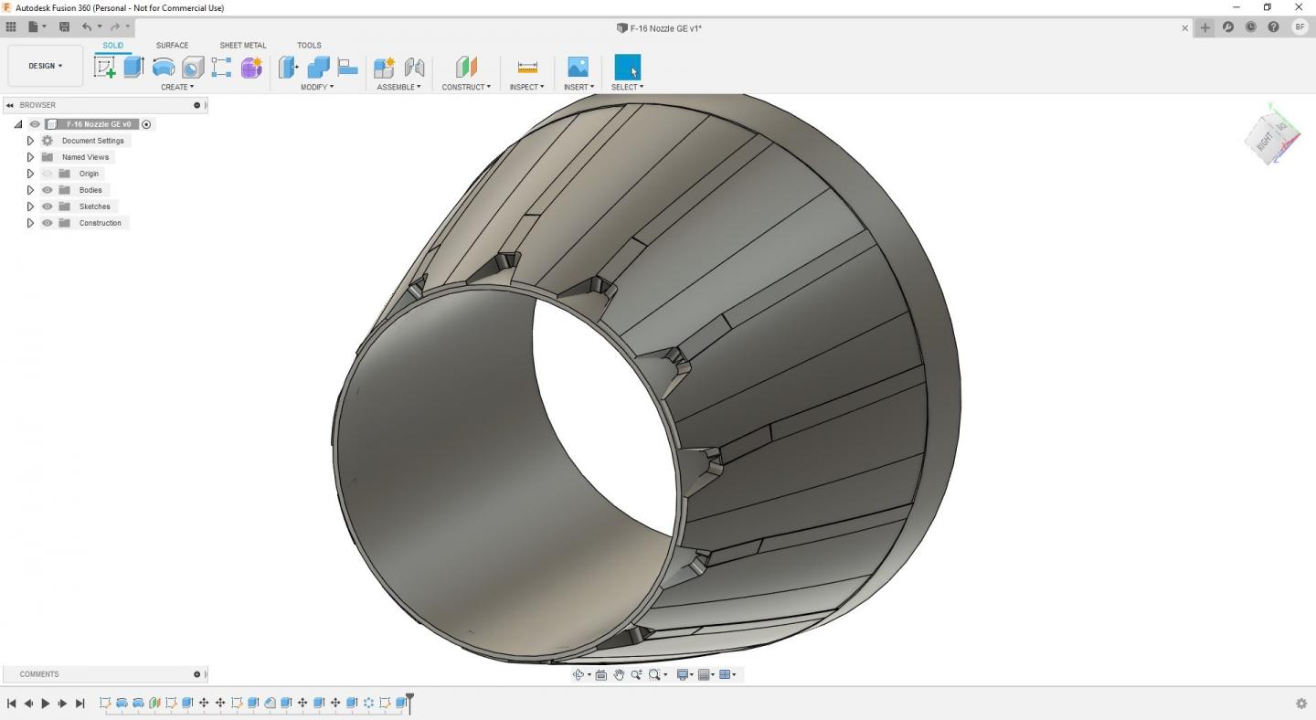

                            #53
                            Practising as well. Limited success, but I managed to make overlapping panels...
Name:	F-16 GE Nozzle.jpg

                              #54
                              Looks awesome!
