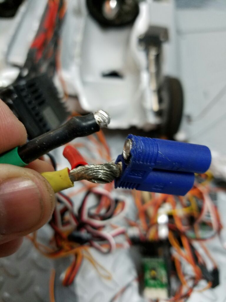

You need better solder joints and/or heavier/better wire
I've gone to high quality copper wire and 5% silver solder for my high current applications. Aluminum wire will not handle the same current as copper any you need considerably heavier wire if using aluminum.

Wire looks to be the max gage that will fit into the solder bucket of the EC-5. Silver bearing solder (less than 10%) is a good idea if one can supply the added heat (it doesn't melt at too much higher heat than 40/60 solder but it is higher) ("Silver solder" 12% [some text start at 15%] or more really is a brazing process and takes more heat as the silver content is increased). I don't see why aluminum wire is mentioned. The wire in the photo looks to be properly tinned. (Are there reliable aluminum to brass solders?)Originally posted by fhhuber View PostYou need better solder joints and/or heavier/better wire

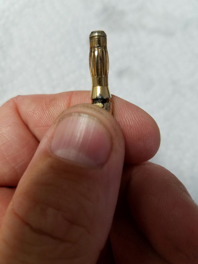

i dissasembled "killer" connector and inspected it closely. it's got alot of spark damage on it. i think most likely that was the cause of the heat increase in this connector.

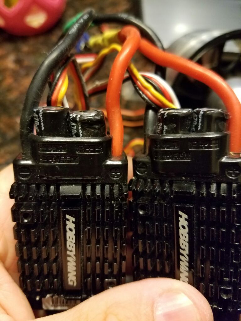

also wanted to ask you guys: on ESC there are two resistors on each. they are a little bit mangled after crash. i test controllers and they work fine. what those resistors do and will it affect perfomance of the ESC?
Resistors? I suspect what you are looking at are Capacitors (caps). A photo would help a lot. But any physical damage to the caps (Low ESR electrolytic Cap) means they should be replaced. To learn what those caps do you might want to look up "Ripple Current in ESC's". The short of it is, that the caps protect the delicate switching transistors (mosfet)
To be honest the connector does not look too bad, not great but not really bad. The issue that the sparking cause is it places deposits on the contacts. I bet there are some deposits on the inner diameter of the battery's female connector. These deposits can be bits of the connector and or carbon from the burning spark. More and more deposits after each insertion causes a higher and higher resistant connection between the ESC and battery.

If you can't change out the Caps at the PCB level. You might want to look at replacing them with after market cap boards. Almost all the high end OEMs( YGE, Kontronics, Castle Creations etc.) have these. They are easy to add to the ESC's battery leads.
http://www.castlecreations.com/produ...-cap-pack.html
But you will need to cut off the damaged Caps at their leads. You don't want the damaged caps shorting out later.
Don't know if the repaired ESC with the Cap blocks will fit back into the SU 35. So you might want to repair these ESC and save them for another project.
Now here is where I usually get my low ESR (Equivalent Series Resistance) caps. (note there is not an industry definition of low ESR but look for electrolytic caps that claim to be suitable as switching caps).

Thank a lot for detailed info. i added a picture how bad my caps looks. mine ones are made by Rubycon and i found them online. but to replace them that's another story. they are attached between two circuit bords and to get access i need to separate those boards by unsoldering 16 bridges which connect them.Originally posted by KJD View PostI know this is getting too technical for Hobby Squawk so I apologize, but here goes.
