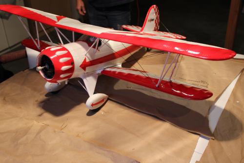

              OH YEAH!
              I forgot to mention, I have an e mail in to MotionRC regarding the landing gear fairing problem and Matt replied.
              He's getting ahold of Ryan and Mike to find out what it was that they did to secure the fairings on the Demo ones they built used in the video. This in itself would make a great video
                • 7438
                #67

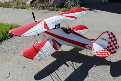

                Re: All us newbie pilots, lets share..

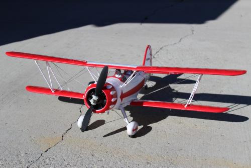

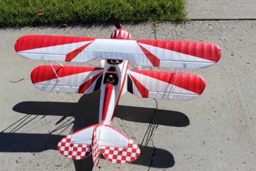

                Took her outside in the sunshine, yes the snow melted, got up into the 50's today
                The next step will be Minwaxing her
                By the way, there's no glue involved yet, not even the rigging, although, I'm thinking that it may need it at the cabans and struts, Retired Flyer was right in thinking that they may need a little more grip

                  #68
                  Greetings G56,
                  Are you kidding me??
                  That Waco looks even more incredible in the sunlight!!!!
                  I'm really liking the Red And White more and more with each photo you post.
                  I just might have to..."No, Bill....Don't you dare ckick on that Add To Cart button"!!!!!.....Yes, dear..... <smiley image="smiley_sad.gif"/>
                  Can't wait to see her all waxed up!!
                  I'm also hoping that Mike and/or Ryan get back on the covers application. If they've come up with a sure-fire method for keeping those things on I'm all for giving it a try.
                  I'm off minwax shopping in the morning......

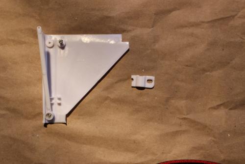

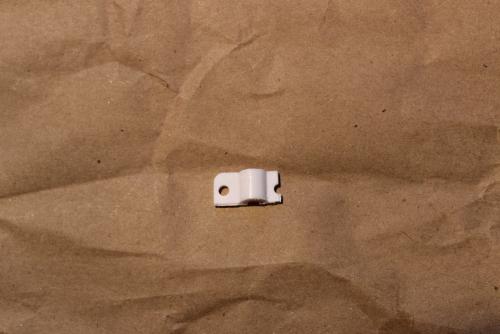

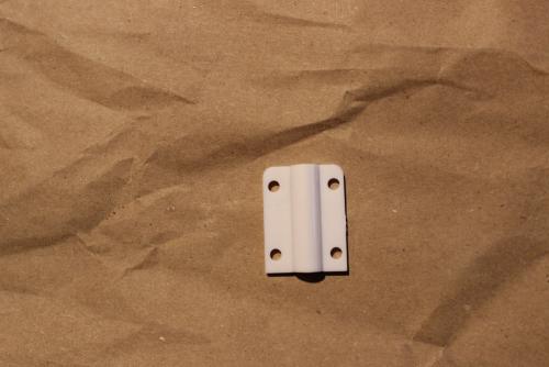

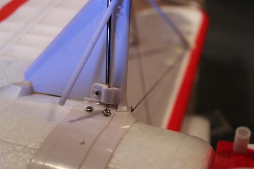

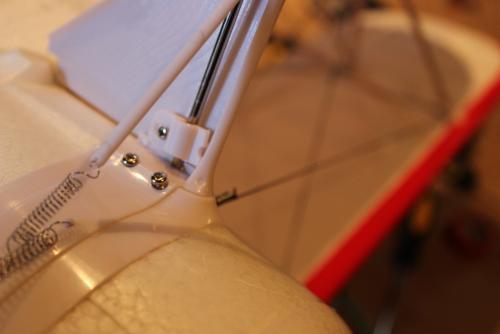

                              Ok guys,here it is, the lost step in assembling your WACO. Firstly, who own a Pandora (note the terrible Chinese -English translator)
                              I DO I DO!!
                              And have left over parts?
                              ME ME!!
                              Finda dis part in spare part leftover container
                              Ok now verry carefully cuta dis part like so

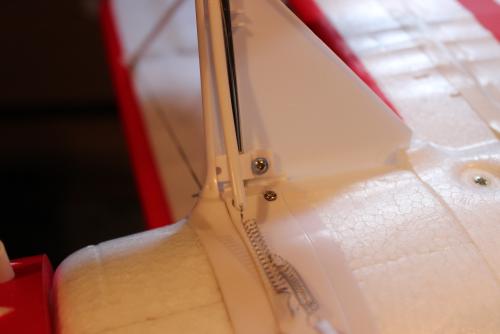

                              Now, look at fully assemble landing gear fairing. See the useless screw points we install at top?
                              Well, see how fit spare screw into useless screw point, becoming very useful. Elongate original hole in spare Pandora part so part fit into very useful screw hole and over landing gear strut at same time.
                              Now take spare screw and assemble through spare Pandora part and into very useful screw point, making sure to file and adjust Pandora spare part to fit like so
                              Verry Nice!
                              Very Nice!!
                              And so ends the mystery of the lost Waco landing gear assembly step. by the way you can tell its the ORIGINAL STEPS because A) the Pictures are clear and B) They're in color!
                              Hope you enjoy. Of course, some of you are undoubtedly better at fabbing parts than I am but this works and it took longer to post this than it did to actually do the step
                              Secure Fairings!!

                                #75
                                Way to go McGiver !!! You did a great mod . My Wife is looking at this and the Steadman for my Christmas <smiley image="anim_jump.gif"/> I know where to turn for help .
                                I have really enjoyed the postings you have put up on the build.
                                What are the springs for on the bottom of gear for ?
                                    Well, I have the Waco all repaired except for the prop which is on its way. I'm pretty sure that it was a motor mount problem, but you can guarantee I'll run it through every test I can think of. Maybe she just thought she was a 3D airplane?!
                                    Oh, and the springs are what holds that plastic strut to the fuselage, I think they're more decorative than anything else.

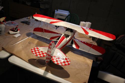

                                        #79
                                        Thanks Bill, it means alot!

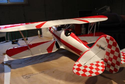

                                        Now, I'm assuming that you've read the Minwax tip, here she is!
                                        She has the wet look
                                        I haven't painted the undersides yet
                                        But so far, she looks great!
                                          Very sharp looking there Gman !
