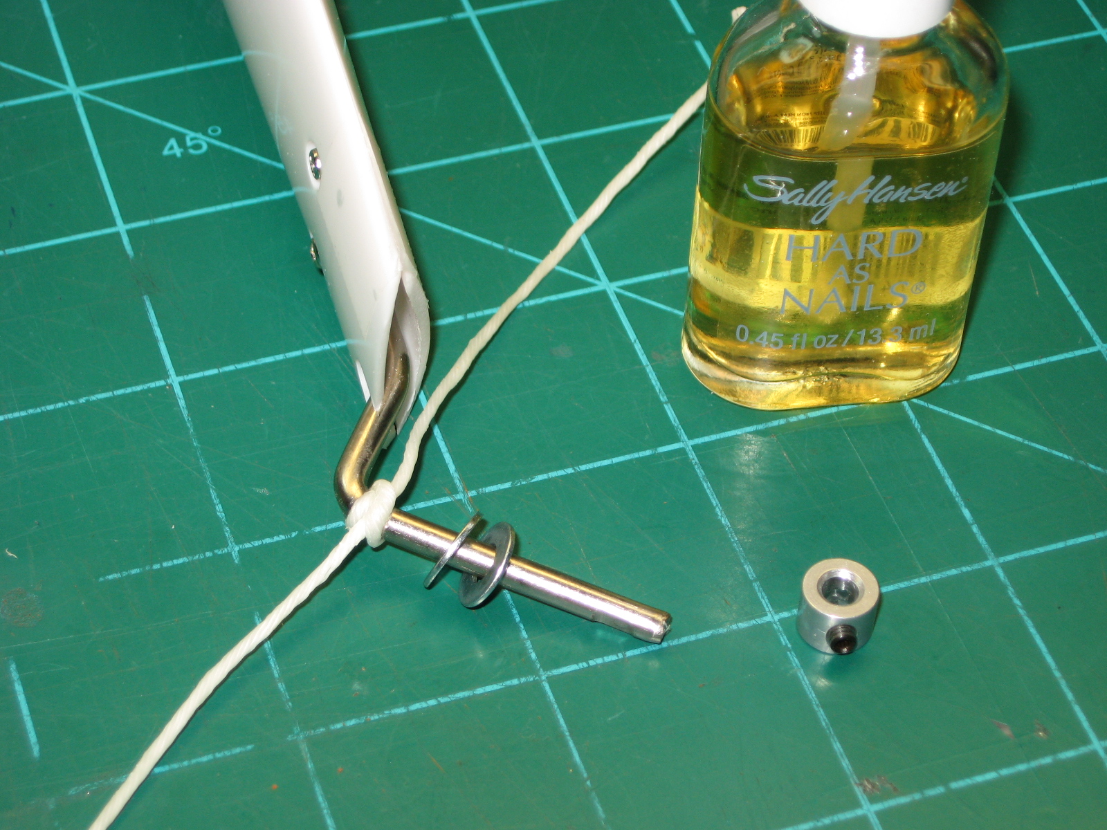

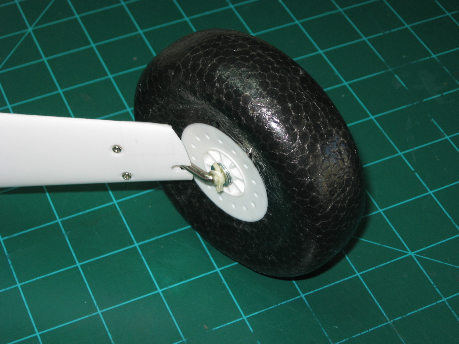

                  The 4" foam wheels on my tail dragger landing gear did not always rotate as freely as I would like. They would bind a little where the axle is bent. There is not enough axle length to put a wheel collar on both sides of the wheel to help it spin freely.
                  My fix was to tie a thick piece of string twice around the axle, and add 2 small washers to make a little wheel collar. I put some clear nail polish on the string to hold it in place.
                  Now the wheels spin perfectly.
