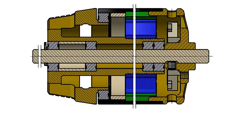

        Found the motor, and I was in error. The motor is NOT a "can in the can" design, unlike the MVVS motor. I really like all that bearing support for the rotor! The rotor is supported at both ends. This helps a lot with the gyroscopic loads these larger props place on the shaft and rotor.
        http://www.espritmodel.com/axi-35-28...radian-xl.aspx
        Per the OEM (AXI) there are four bearings set. Per the drawing there are actually 5 bearings, the small gray boxes (see attached). Love the large ring bearing. This adds a lot to the cost but it is worth it for rotor stability!
        For more detail on why the ring bearing is so good see this link.
        Like that it also has a tail stub for a bearinged rear motor mount support
        Normally I like to prop with more pitch (14x9.5, 13x11). But with the weight of the RXL that might not be the best course of action. Have you experimented with other props?
