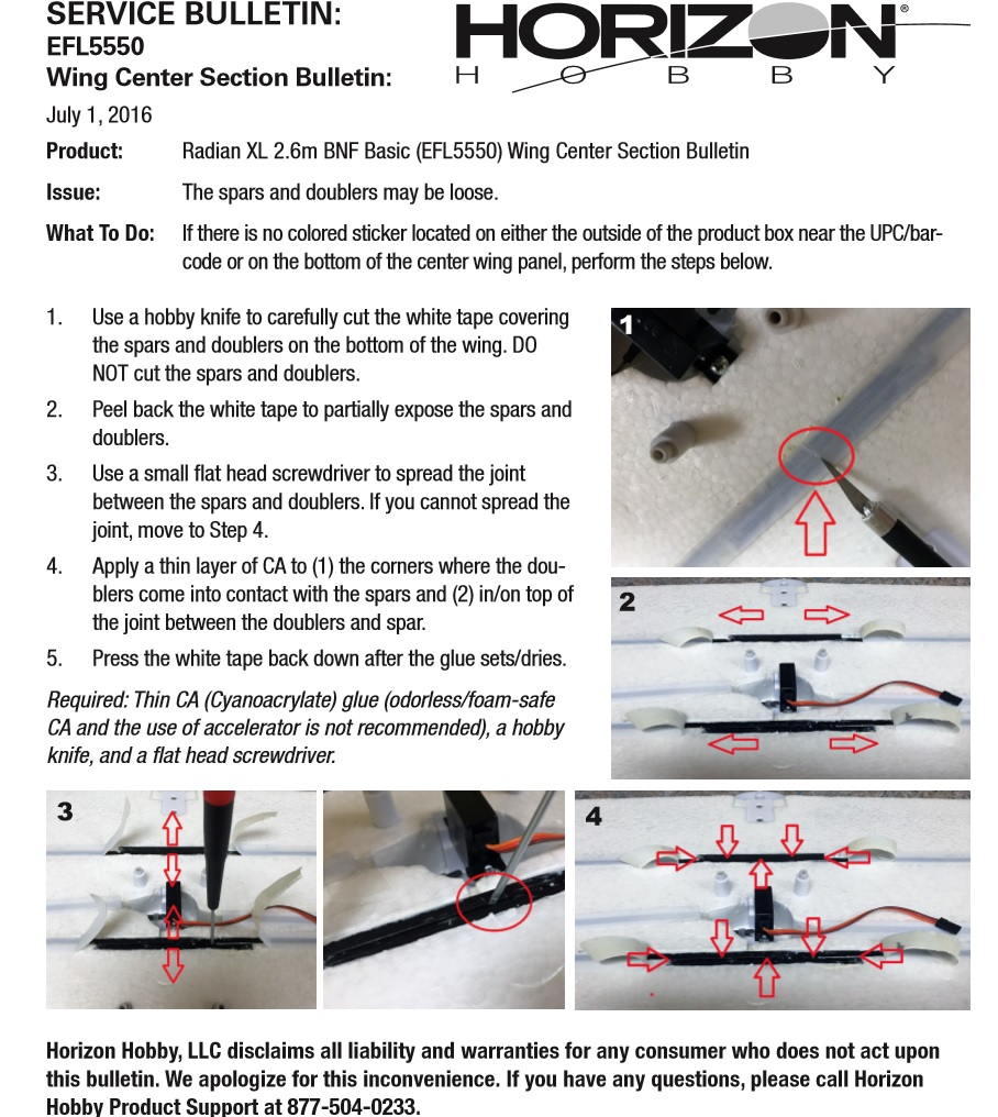

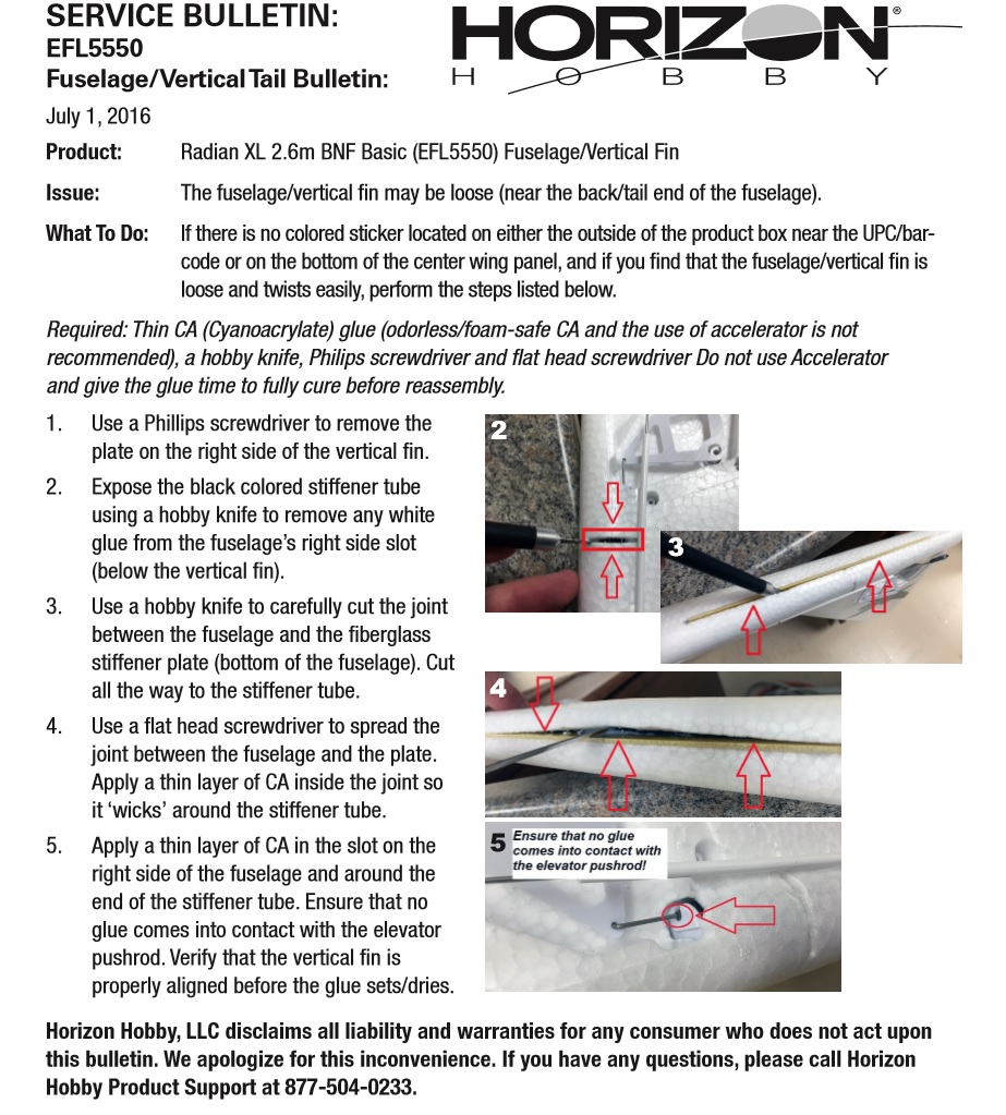

                              In post #12 and #20 I seem to have nailed it. There is a manufacturing issue with the tail boom of the E-Flite Radian XL. (See attached) It looks like Horizon is falling short of great customer support. The Radian XL is marketed to the PNP/ BNF crowd. They have paid a premium for this simple glider, not to have to "build" it. To have this kind of customer have to rework their glider so as to maintain the warranty is ridiculous! I commend E-Fite for issuing the SB but they have fallen far short of great customer service.
                              They need to issue a revision to these SB's. There should be a "Buy Back Program" for the Fuselage. To expect the target customer to perform this kind of rework is not realistic. There is far too great a risk that the repair will fail as a result of control binding (glued push rods from the over flow of CA)!
                              There also needs to be a Customer support program issued (mentioned) Like a $30 coupon for the cost of the glue and the loss of product value from the marred components as a result of the repair (most likely will not look like new). And compensation for the customer' times, for those that do perform the repair.
Name:	Eflte Radian SB 1.jpg
Name:	Eflite Radian SB2.jpg

                                  "TSB's" or Technical Service Bulletins in the car industry does NOT include a "buy back" option. TSBs are for products that "might" have a problem which the customer can, if he/she wishes, return the vehicle for repair or for checking. This is an under $200.00 BNF model airplane. You're dreaming if you think HH is going to do a "buy back" on a cheap toy or reimburse people for their glue and whatever few minutes it takes to implement the "fix".
                                  OK, KJD, not wanting to sound mean or impolite, but this has gone on ad nauseum. It seems to me that you are trying too hard to justify NOT buying this plane. All your calculating and the digging up of posts that have already been posted on this forum and all over the internet (SB) isn't going to create mass rejection of this plane. If you don't want it, don't buy it. There are many who have bought it and almost as many who like it, even love it, in spite of all it's so-called "deficiencies". There is so much more to buying and loving a product beyond calculations, wing loadings, weaknesses (remember the K car?). You can't quantify or qualify aesthetics, desire, curiosity for a new product. Many don't care if it doesn't compare to the original Radian. They don't care that it won't glide as well as some other sailplanes. They don't care that's it's too heavy or too ugly. They don't care if it's under powered. They'll buy it anyway and deal with that later. They don't care if it won't do well in ALES competition. 95% of sailplane owners don't do that. But, they just want it.
                                  HH just markets this product and they make it look as good as they can. That's their job. They didn't create the "hype" any more than any company does for any new product, be it a toy model or a car. It was and continues to be the clientelle that creates and propagates this "hype". Don't blame HH. In the "other" forum, there is currently an ongoing battle between Tundra fanboys and Timber fanboys. I'm not a fanboy of any kind. I like and dislike products from different manufacturers and I don't feel the need to constantly try to convince others how bad something is just so I can feel good about my decision to NOT buy it. In the same token, I don't have to put a product up on a shrine to make myself feel good about having bought it.
                                  The bottom line is, you don't have to work so hard to dissuade others from buying the XL. We know you don't like it. We know you won't buy it. You can feel perfectly at ease in your own conscience and justified to NOT buy it. Are you even in the market for another sailplane? If you are, then just get one of the others you've point out. If you aren't, I'm afraid your point of all this just eludes me. It's OK, I won't buy the RocHobby V-tail thing because it's just not my kind of plane. I don't care that it might be a better product. I've had the Fox Glider. I didn't like it. I thought it was garbage. I gave it away. However, the next guy does like it, but maybe it's only because I gave it to him free. Funny he hardly flies it. My buddy with the Cularis. He dosn't like it nearly as much as we like our XLs. Again, it's OK. Different strokes for different folks. You don't have to try anymore to convince us that the XL is a terrible plane. They will still be purchased and they will still be liked.

                                    In my industry aviation, there are Customer Support Programs for SB even more so for those that have FAA AD's attached (flight worthy issues).

                                        The only real repetitive thing I've noticed in my post history is that I made 3 SB post. The first questioned motion RC about putting a link on their sales page for the RXL to these SB. Second I posted the SB's here in my 2.6m class foamy thread. And third I started a thread to discuss the nature of those SB's as it pertains to customer service and expectations.
