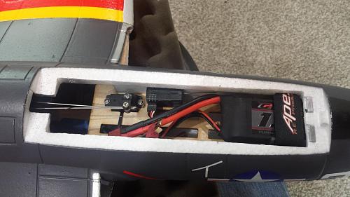

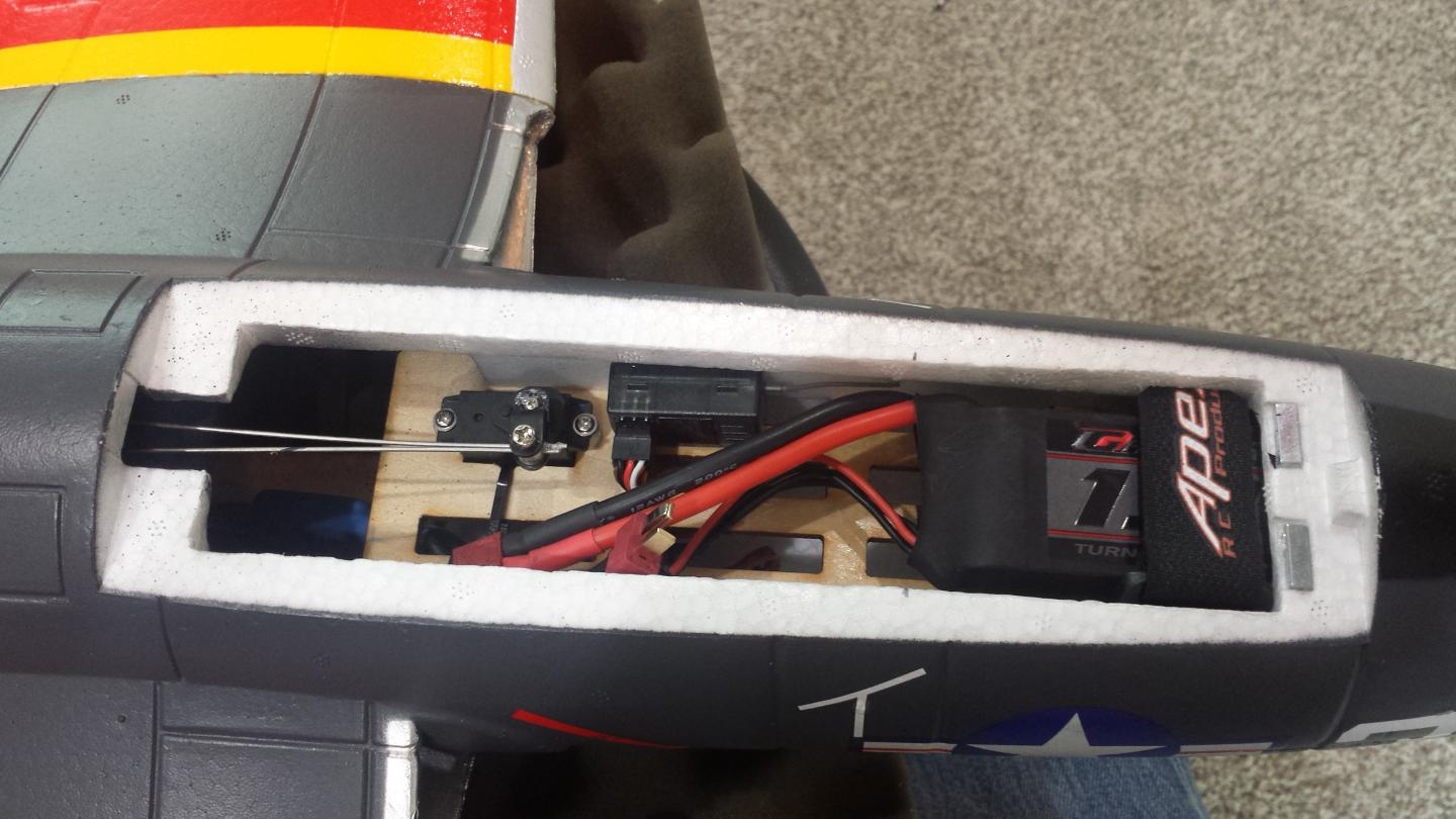

Hey Frank,
I actually have developed a special fondness to my Freewing F9F. How did you manage to fit a 4S battery in that plane?
Woody
Hey Woodie,
Cut the front 2 tabs that connect the wood tray to the fuse and the tray will be "spring hinged " Makes it ez to push down a bit and slide the 1800 4 cell pack forward to make cg ( I have it close to the servo wire track ). This plane is the most fun you can have for under 100 (OK a bit more with the upgrade, SO worth it) Sorry for the off topic, gives us somethingto do while waiting for foil.
