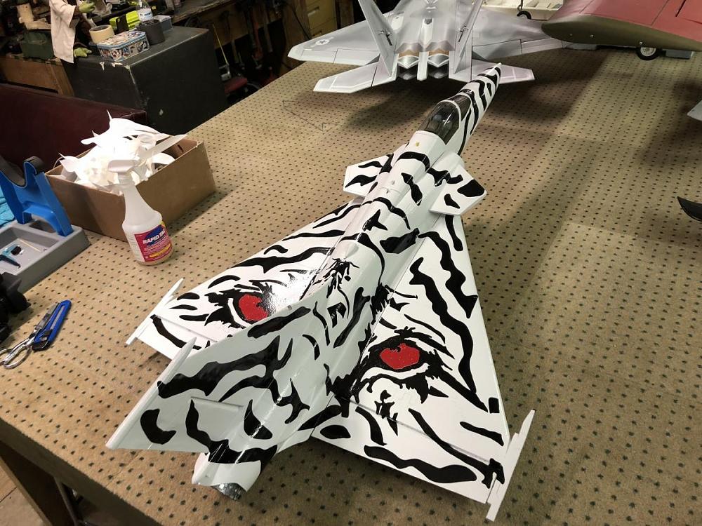

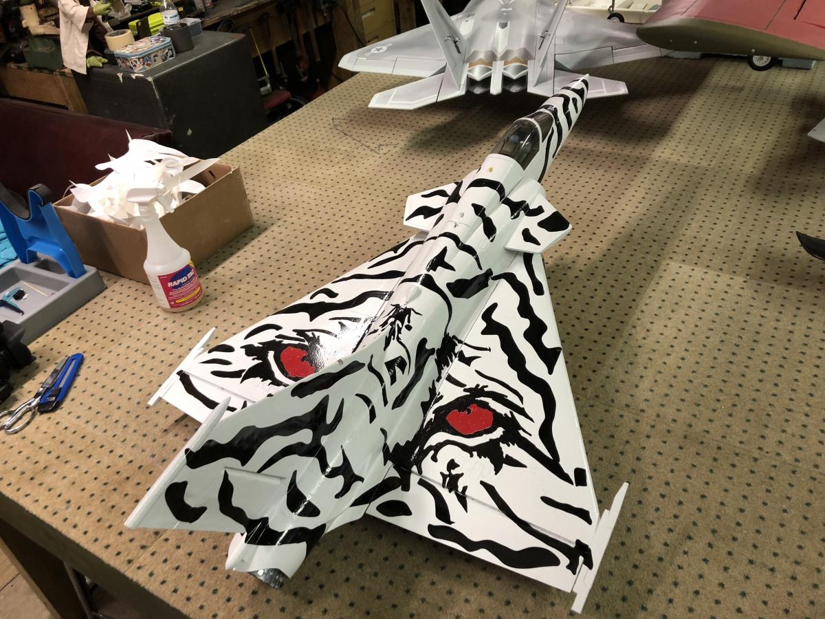

            Not sure if anyone still flys this plane. I love mine and just painted it. Was looking rough from years of flying it so I gave it a face lift. 😀

                  Welcome to Hobby Squawk! I made those graphics from a picture of the actual plane and sent them to Callie, I'm hoping Alpha will get us a Rafale to do up like this :Cool:

                    I left it stock. Just for weight. It looks fantastic in the air and a very good flyer. 😀 I wish they would make a EPO. Darn the luck! It was a great plane

                      wow, this looks fantastic. May I ask (as I have never done a paintjob to an EDF flyer before) how you colored it? Did you use a primer first, then a color and then a final transparent color? Can you recommend colors? Did you make use of an airbrush pistol?
                      BR and thanks for any answer,
                      Harald

                        Yes I primed it with rust oleum primer. Then painted with acrylic paint thinned for airbrush gun. You can pick up an airbrush set up on Amazon cheap. You can also buy any color you like on Amazon as well. Just do a search for airbrush paint.
