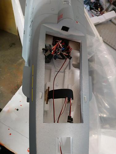

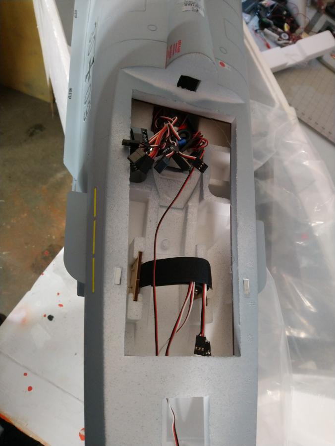

This is what I am trying to get across, its NOT a V1, it has actual servoless landing gear, but does have a 6 blade 1750KV 90MM EDF. It does have a foam NLG door. It does have the awful Pilot. It has glue on drop tanks, it does have no MLG doors. It does have the plastic canard bell cranks. It has the early, more magnets forward located, canopy. Lets call it a V1.5!!!You will likely be doing yourself an ill favour if you get rid of the V1. It may not have as many bells and whistles as the newer V2, but it had a much cleaner duct and was lighter so it flew better for the most part. You just need to upgrade the 'annoying parts' (change old servo actuated retracts by 'e-tracts' if it's truly a V1, get better actuator arms for canards, replace servos motor and esc, etc... mostly pretty minor stuff!).
Oh and it has the weird, slanted battery compartment for two three cells with Deans connectors. This model in my opinion should go to a collector.
EDIT, it also has NO carry through spars, none. This has the glue into a molded channel on the bottom of the wing, that does insert into a small portion of structure in the wing root area.

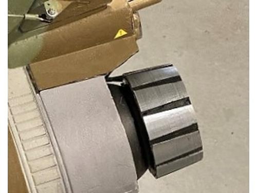

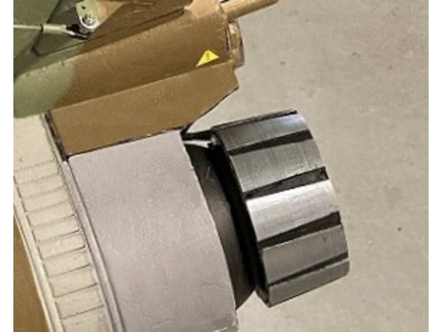

Push-on 3DP overlays for the ugly foam VT nozzles. They are thin so be careful when printing and fitting them. Also be sure they don't interfere with the VT range of motion.
This is a push-on overlay for the rather unattractive thrust vectoring (TV) nozzle on the V2 Freewing Eurofighter Typhoon. Print as light as possible since it does not bear any load. The cut-outs accommodate the ball joints for the TV pushrods. It's a fairly tight fit so ensure that there is no flash on the print, which will prevent it going on all the way. It's thin, so you may need to adjust your slicer parameters accordingly.If using the TV moveable nozzle make sure that you still have the full range of movement on your TV nozzle.There's a slightly thicker one available if your slicer/printer won't handle this one. It is athttps://www.thingiverse.com/thing:4101139There is also a replacement nosecone. It has a cut-out for installation of a magnet to hold it in place instead of gluing it on. I printed it with 1 wall and 5% infill to keep it light..Comment

Well, the V2 doesn't get much love any more, so I made mine some improved push on "skins" for the exhaust nozzles. They are very light and just push over the nasty looking foam nozzles. I am biased, but I think they look a whole lot better.
STL files at: https://www.thingiverse.com/thing:4091983Comment
