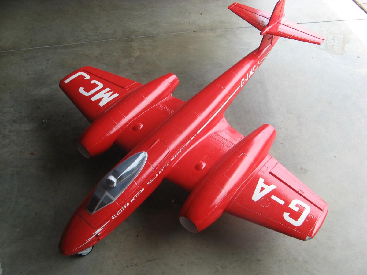

          #24
          Let's revive this thread
          • killickb
            • 118
            #25
            Yes, back to the Meteor !
            • Icarus the 2nd
              • Aug 2018
              • 164
              • Pajottenland, Belgium
              #26
              nice good looking & very visible scheme!
