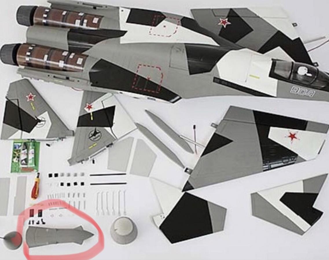

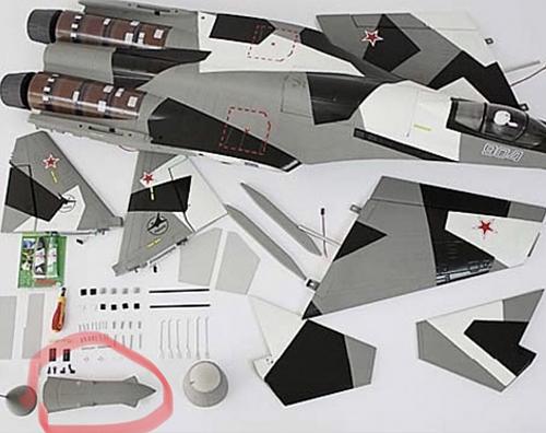

    Originally posted by fredmdbud
    Saw this on social media
    My God, I am all over this. I really want more info. Unfortunately it looks like the 2 seat version (judging by how huge that hump is). I really hope they consider selling a 1 seat version too. The giant hump just isn't doing it for me...
