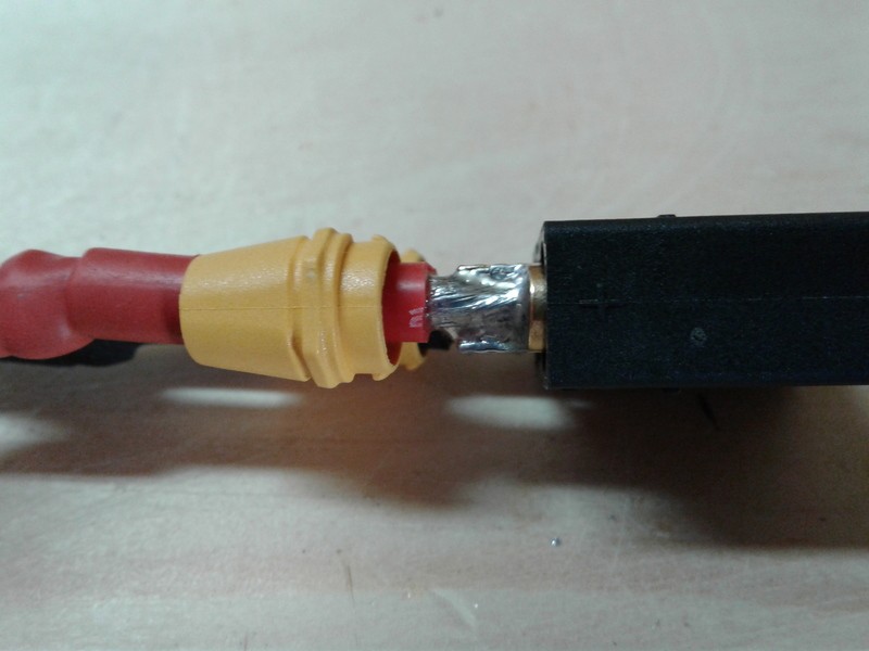

          As for the Deans, yeah I can see that happening. I will be using XT90 connectors. I used XT90's with the FMS 90mm Fan/YEP 150 ESC with no problems. The XT90's never even got warm, even under full power. I am sure that this bird will be fine with them.

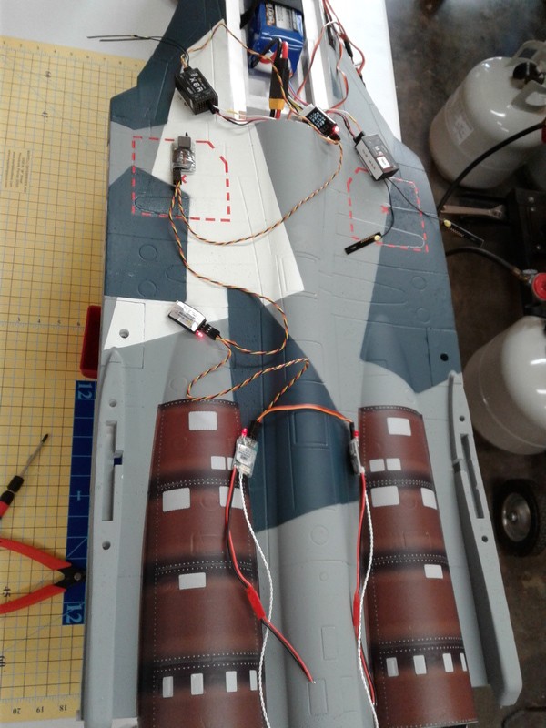

              I will also have battery voltage, RPM, esc temp, battery temp, altitude, and pitot airspeed sensors (FrSky sensors) which can be programmed in the mix. Those sensors allow for programming things which might happen at certain airspeeds and altitudes. This is essentially automatic flight mode switching. My old T-28 had all these sensors onboard. So I know they work reliably. And I can get all kinds of warnings from low rpm to high temp and low voltage. The possibilities are pretty amazing. I am sure this bird will provide a lot of bang for the buck.

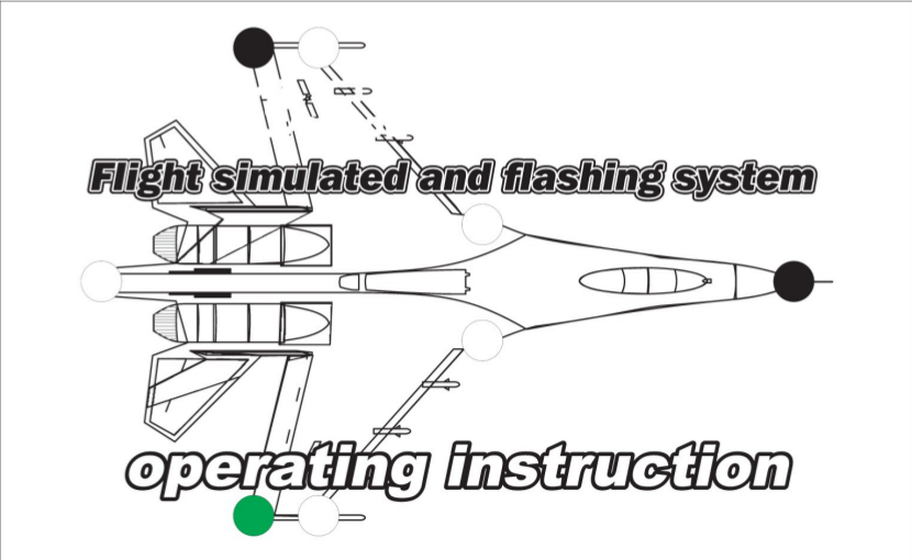

                I am using this lighting system from Hobby King
Name:	Screenshot from 2018-09-09 12-23-41.png
                [ATTACH]n150812[/ATTACH]

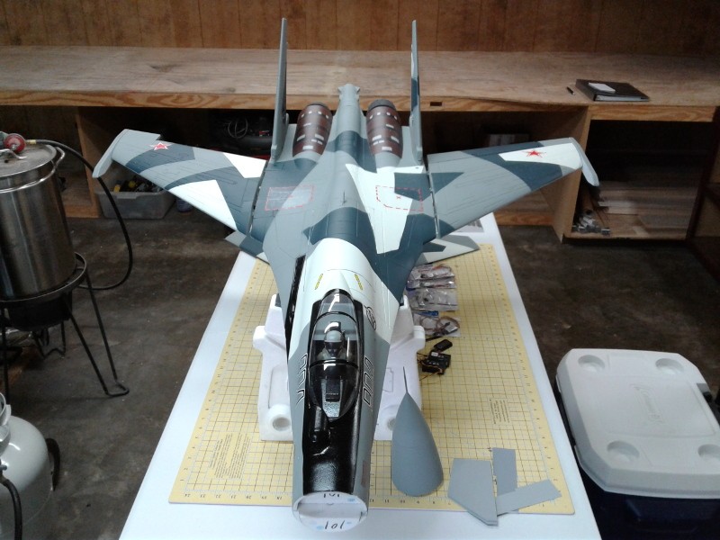

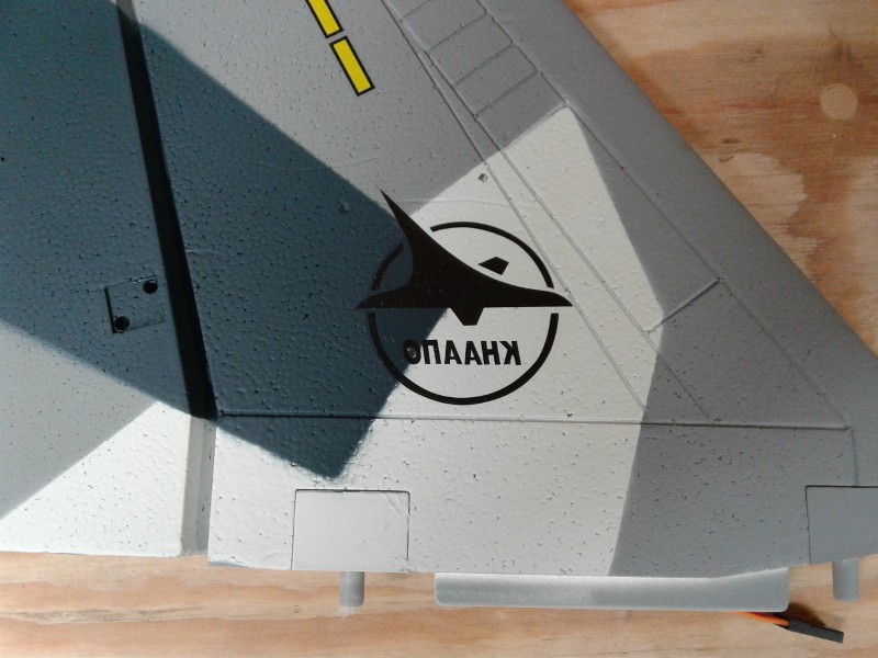

                          Mine arrived today. I really like the look and feel of it. The gear seem to be pretty darn rugged at first glance. Everything came intact. There were a couple magnets loose on the hatch and a reversed Knapo decal on the tail..!@#$% I guess I will just wait and see if anyone at the field notices.
                          She is not small.
                          Question...should I use epoxy or foam tac on this EPS foam?
                          Click image for larger version  Name:	20180913_165923.jpg Views:	3 Size:	109.9 KB ID:	151517Click image for larger version  Name:	20180913_164800.jpg Views:	2 Size:	100.4 KB ID:	151518Click image for larger version  Name:	20180913_165858.jpg Views:	2 Size:	86.5 KB ID:	151519

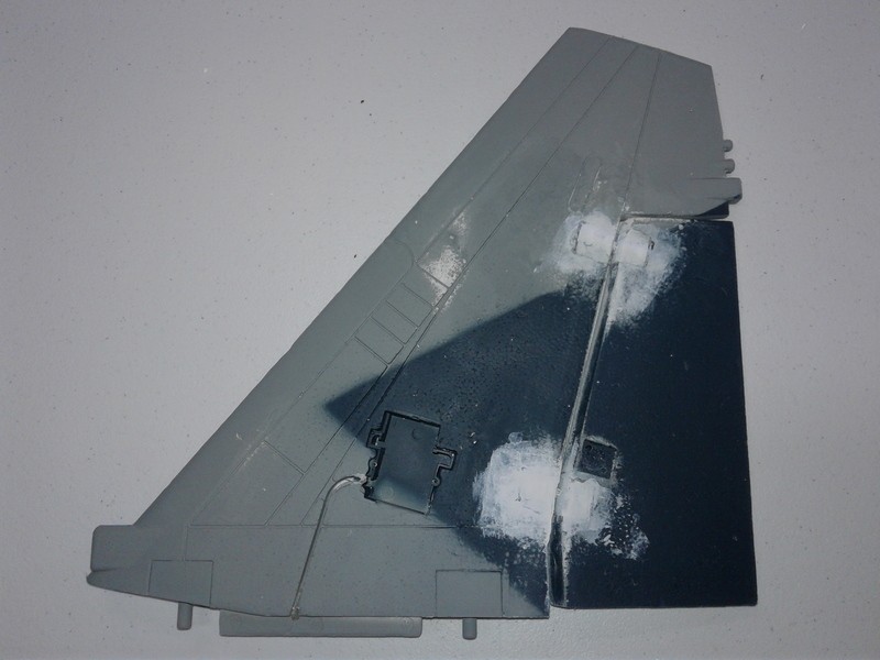

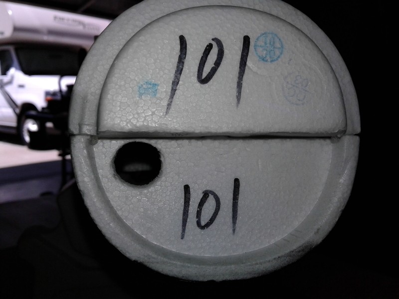

                              And the answer is.....just use epoxy. I had a couple of loose rudder hinges. Re-did them with foam tac and now I have two rudders on order. Also melted a hole in each wingtip pod when installing my lights. Luckily, its on the back so I can patch it with some EPO foam and epoxy.
                              It will take a week for my rudders to get here. So I cut out the hinges, put in some EPO blocks with epoxy, and rehinged with the original style hinges. Now I just got to make them look pretty again.

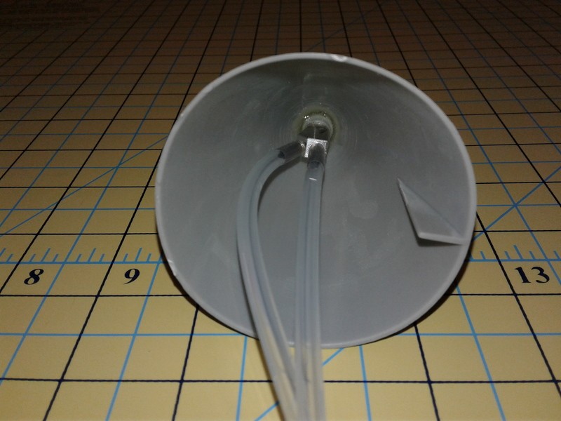

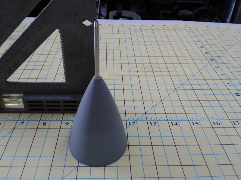

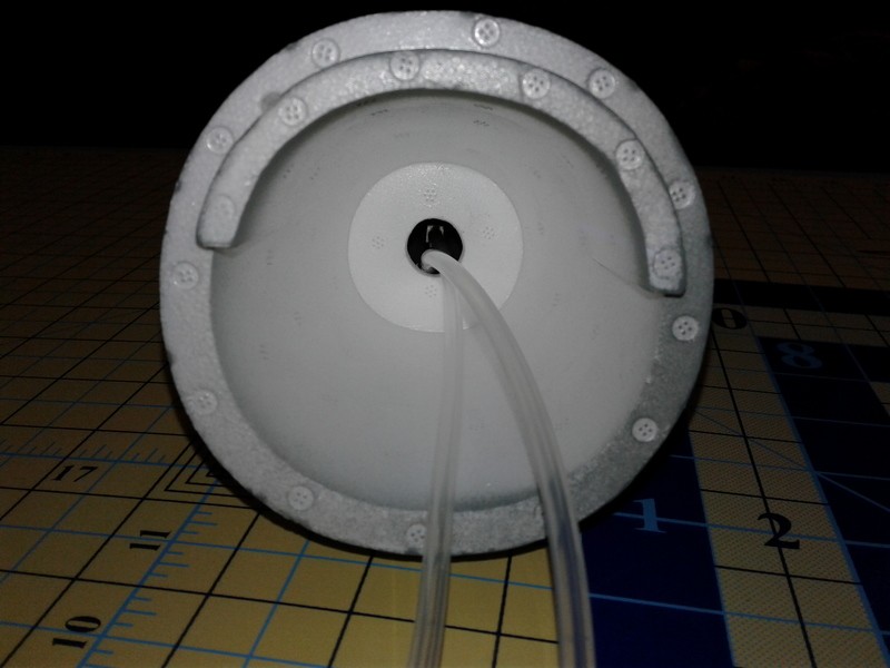

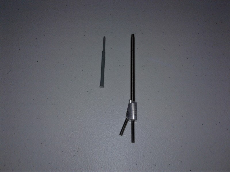

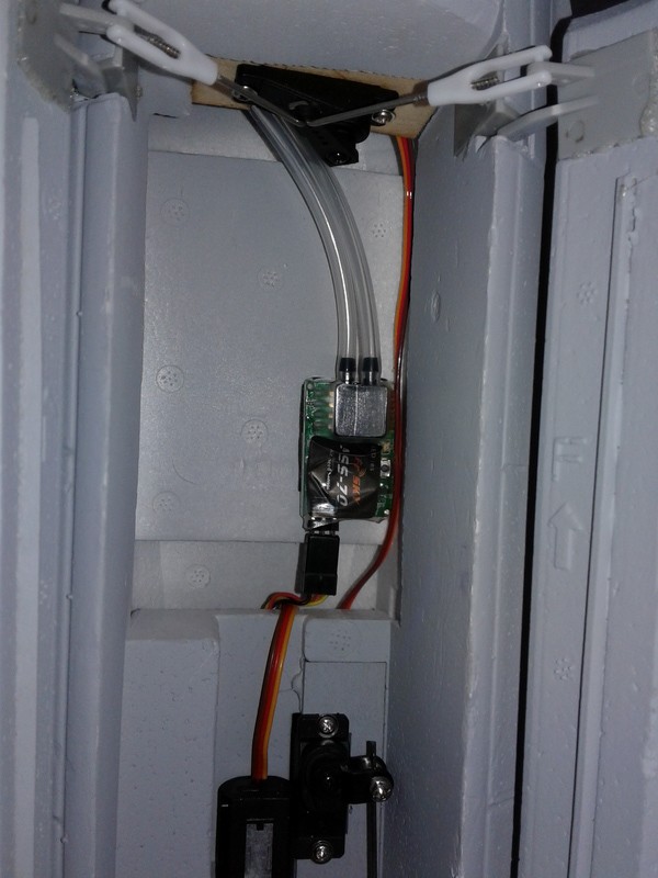

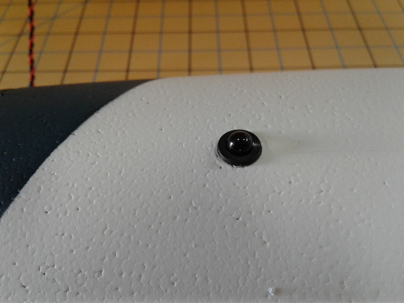

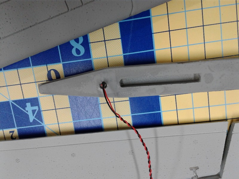

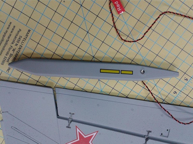

                                Yesterday I got the pitot installed, fixed all the parts that got MELTED by the foam tac, and installed the lights in the wingtip pods and rudder. Sensor suite all works well.

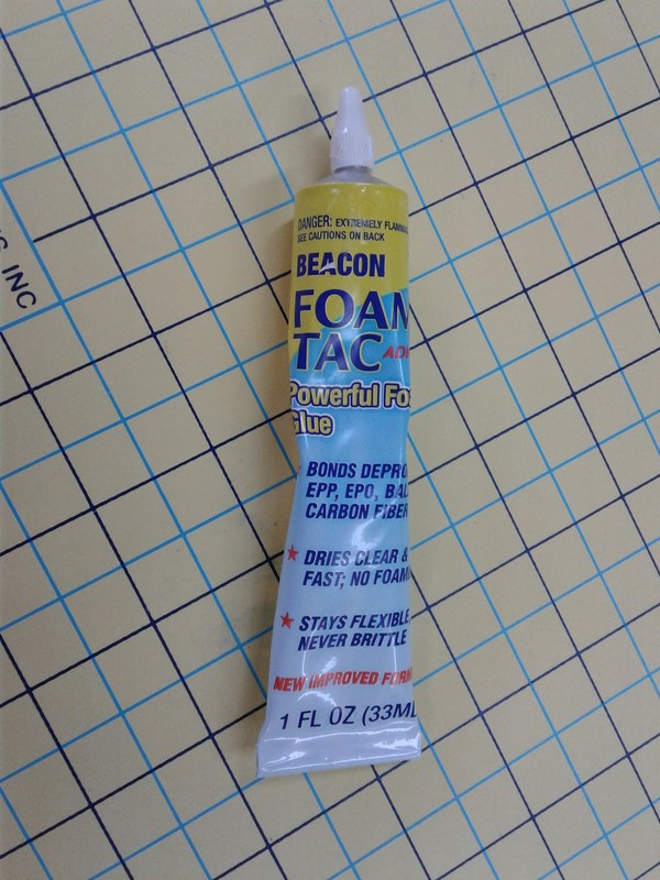

                                It all started with a loose lower hinge on both rudders. Added a little foam tac. It ate a 10mm hole in the foam on each. This was not readily apparent as the foam has a skin which hid the problem. Also, while the rudders were drying, I added a drop in the wing tip pods where the LED's are mounted. Again it ate the foam but not with any signs of a problem on the outside. When I noticed the rudders were looser than before, I found the issue. Then I pulled the LED's from the pods and found an even bigger area eaten away on each. The solution was to cut out blocks of foam and replace with more foam and epoxy. All is well now. moving on...
                                  • 8835
                                  #17
                                  Wait! FoamTac melted the plane's foam? I've been using FoamTac for years and it's never melted any type of foam I've had come across my hobby table. Are you sure you were using this FoamTac?
                                  Or were you using the glue that was included in the kit? That's not FoamTac.

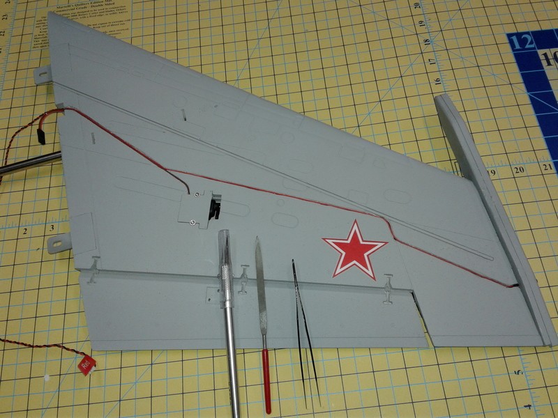

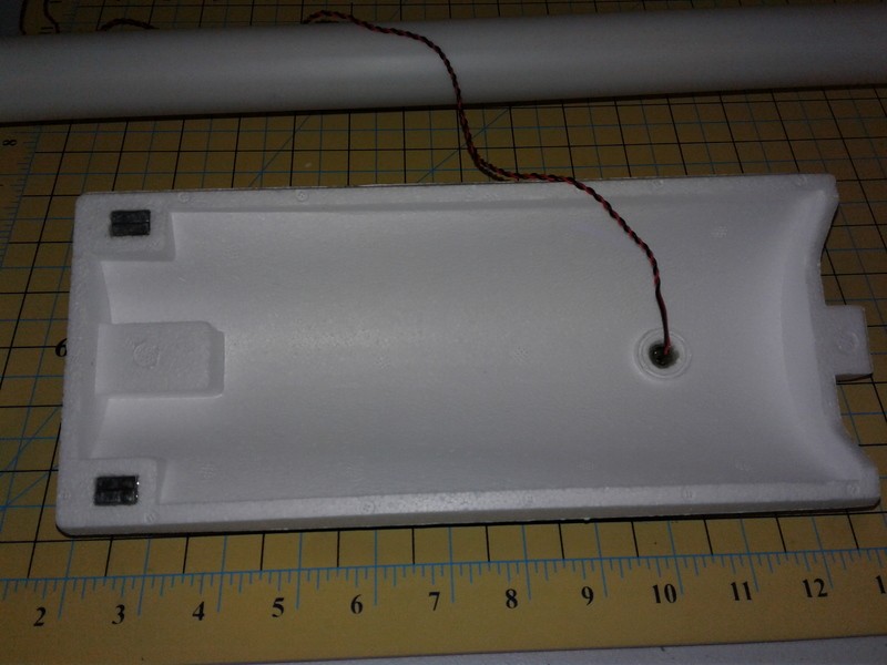

                                    Here are some shots of howI ran the wires in the wing and the tools used. Trench is 5mm deep made by one pass with knife, then two passes with file. I put a strobe on the top hatch. I know it's not scale, but I did it. Also below is a shot of the airspeed sensor mounted in the nose wheel bay.
                                    Yes, I believe it is Foam Tac, purchased from MRC in the tubes. Epoxy works fine. The thing is, this foam has a hard skin. You won't see the damage until you inspect it or the part falls off. I all but ruined both vertical stabs and the wingtip pods. It's only due to perseverance, luck, and a handful of marginal modeling skills that I brought her back.
                                    And the glue in the kit is epoxy.

                                      That IS FoamTac for sure. Very surprised it did that. Will have to watch out. Mine is still in customs, so I don't know what glue comes with it. Now, I know.
                                        #20
                                        Foam-Tac is not EPS friendly...use Bob Smith Foam-Cure, great stuff.
