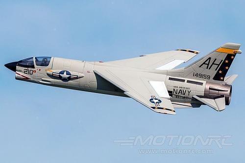

When it comes to the F8, look at this picture:
The linked ailerons are in the wrong direction. The elevators are trying to increase the angle of attack on the wing, while the ailerons are lowering the AoA, just look at the angle the elevators are at to make it fly. If the ailerons where moving in the other direction they would actually help. In a roll though, they should look like that on one side and opposite (down/down) on the other side.
So for turning tighter with airspeed: Ailerons down / elevators up and vice versa.
For rolling all speeds: Aileron down / taileron down and aileron up / taileron up.
Backflips: Ailerons up / elevators up
