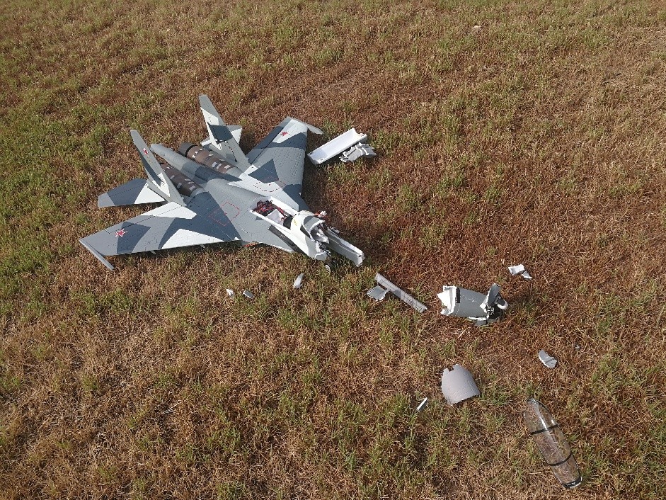

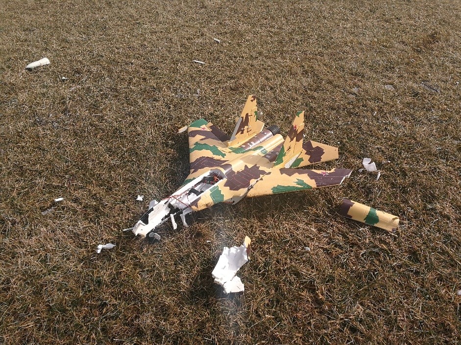

      Well, two crashes, two years apart, same field, same mistake. No more Su-35 for me. I've owned almost every other Freewing jets but somehow just can't handle the Su-35 properly. I know when to call it quits .

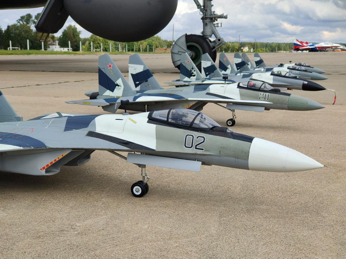

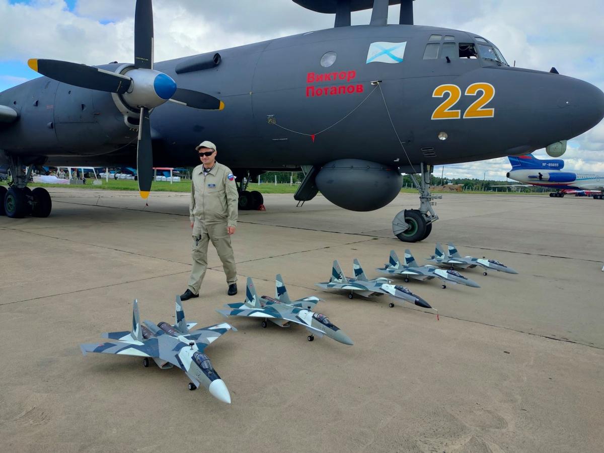

                              #254

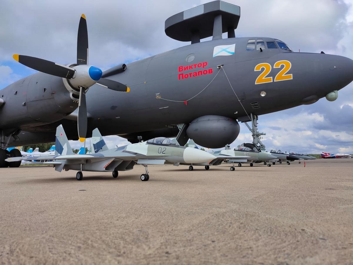

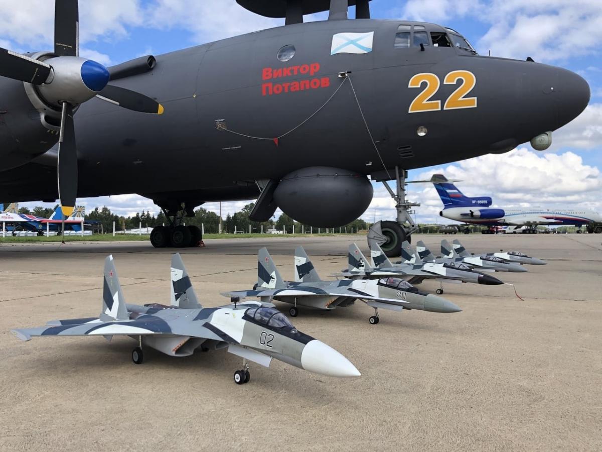

                              This is beyond amazing...
                              Context: Team of pilots flying the Freewing Su-35 in FPV at the international 'Forum Army 2020' public event in Russia this past week alongside the fullscale jets!
                              The FPV images being broadcasted in real-time tothe public.
                              Merging traditional aviation and model aircraft... We need to see more of this around the world!

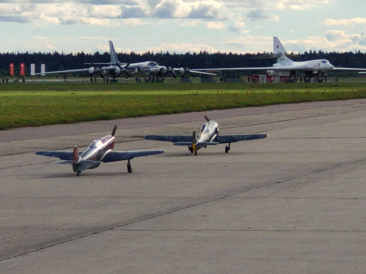

                                And here's some further inspiration...

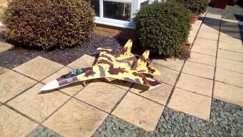

                                    #257
ID:	273032Click image for larger version

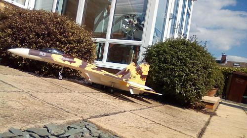

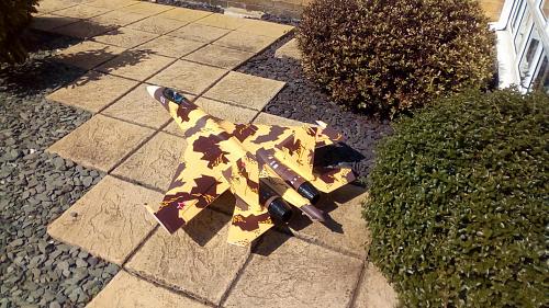

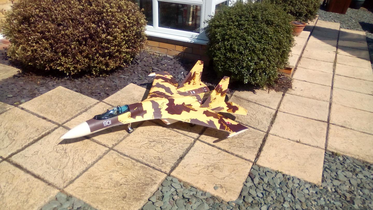

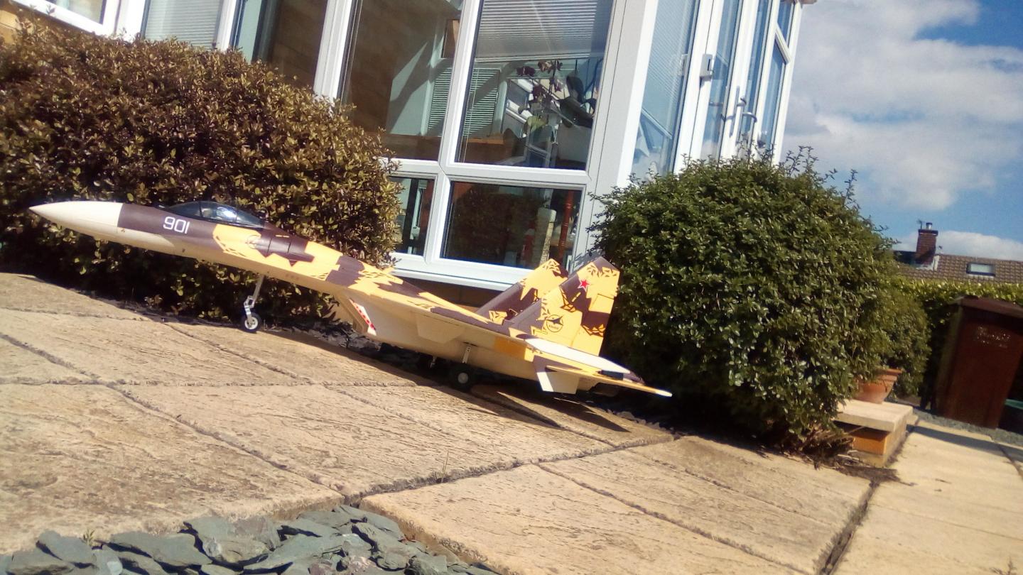

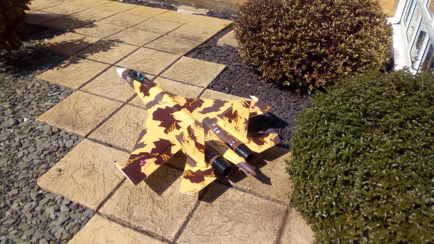

ID:	273031 Impressive. Having been inspired by Air Guardians January Halcyon video I have now completed my Freewing SU35 with twin fms 70mm pro inrunners ( 5.2to 5.4kg thrust on all up flying weight of 3.45kg incl Turnigy 5000mah 60c 6 s battery and with the assistance of one of the my club flying friends have today programmed in the Thrust vectors. I just have to finalise spring adjustment on the oleos and she is ready to maiden.( thrust vectoring will be switched off for the first few flights).. just modified the colour scheme a little as attached. Any words of wisdom for my well manicured grass field take off would be appreciated. I intend to use 8mm of take off flaps and 16mm of landing flaps ( flaperons with restricted aileron throw so as not to max out the servos ) Click image for larger version

                                      #258
                                      That's so very cool!
                                      Glad to see my video inspired you!
                                      Did you also see my build video?
                                      I have an entire piece on setting up the jet, fine tunning and reccomendations:
                                      Regarding take-off from grass, I would rather leave TV on as you may need it to rotate depending on your grass.
                                      Flaperons definitely help too.
                                      Trick usually is to let speed build before pulling on elevator, otherwise they act as massive airbrakes adding to grass drag and the jet stays on the ground... or even worse, you end up producing a cobra take-off!

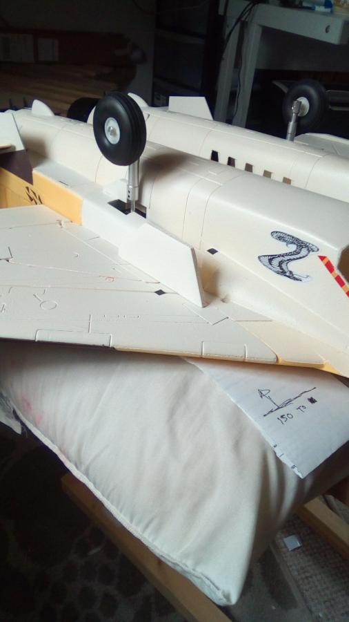

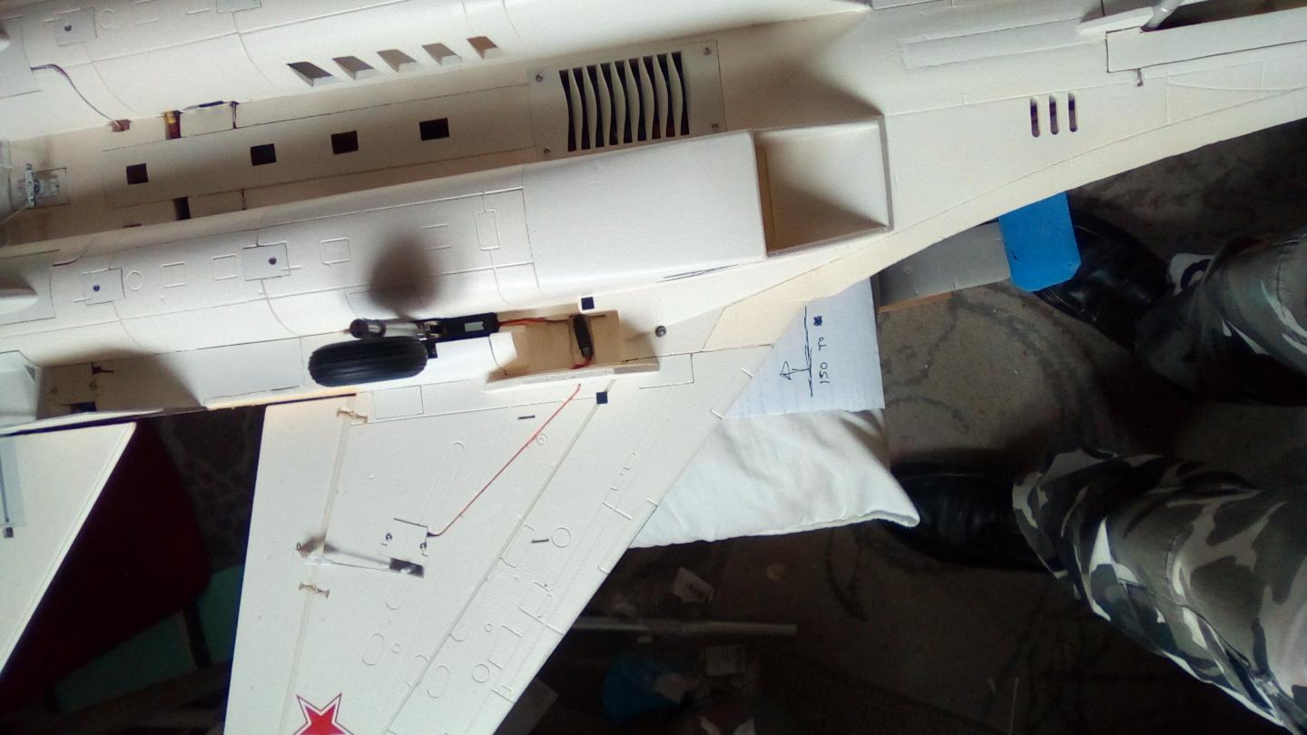

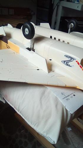

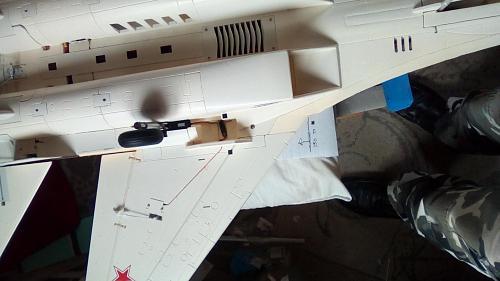

                                        thanks Air Guardian and yes I have viewed the build log many times, reinforced the battery bay, put cf rods in the vertical stabs, added back stops to all 3 Click image for larger version
ID:	273095Click image for larger version
ID:	273096 oleos, set the tail 10mm down from the marking point and set the tvs 2mm spacing to impart nose up/tail down thrust when compared to original FW settings as per your video. Not using tailerons, tv on elevator, rudder and aileron. If using tv for take off I am going low rates for first flight, cg initially set 150mm back from joint on photo attached. Our field is pretty flat and my Hawk and Avanti take off no problem so with a 1.5 to 1 thrust ratio I should soon build up plenty of speed before easing back on the stick for take off. All I need now is a good flying day.

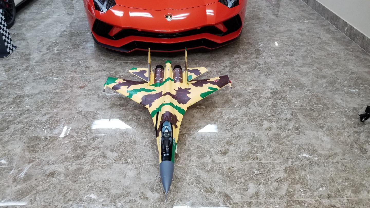

                                          #260

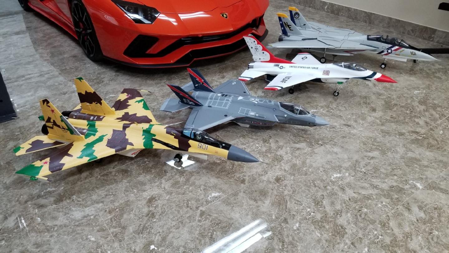

                                          Originally posted by paulrkytek
                                          Having been inspired by Air Guardians January Halcyon video I have now completed my Freewing SU35....

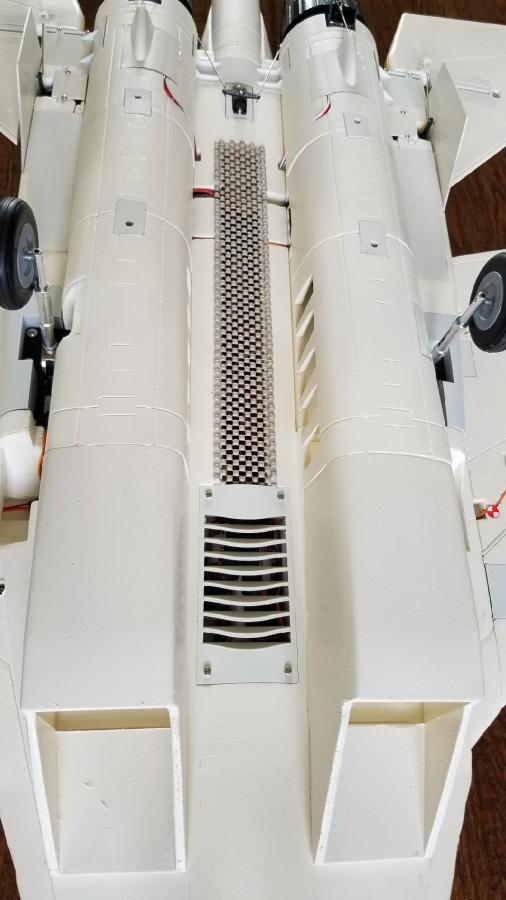

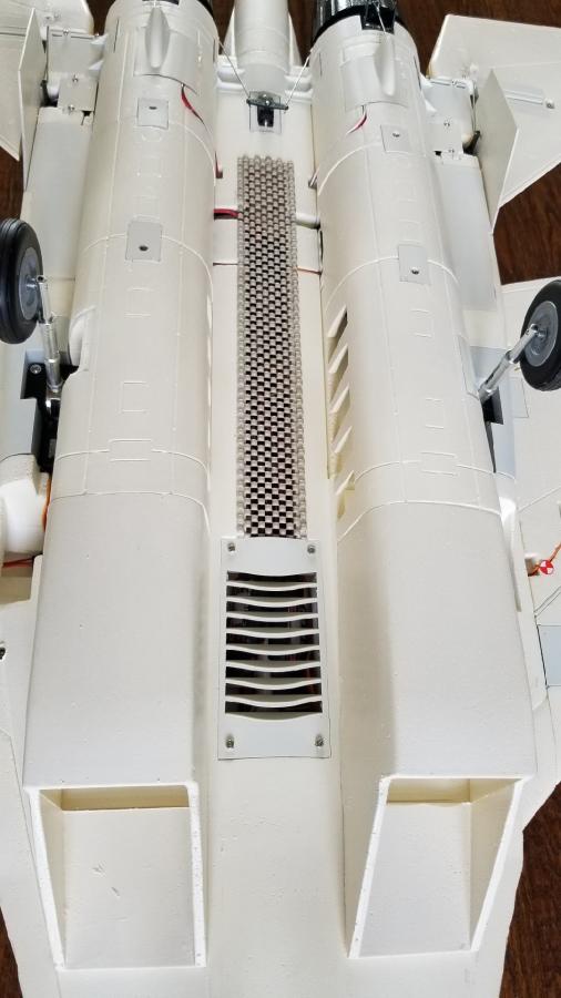

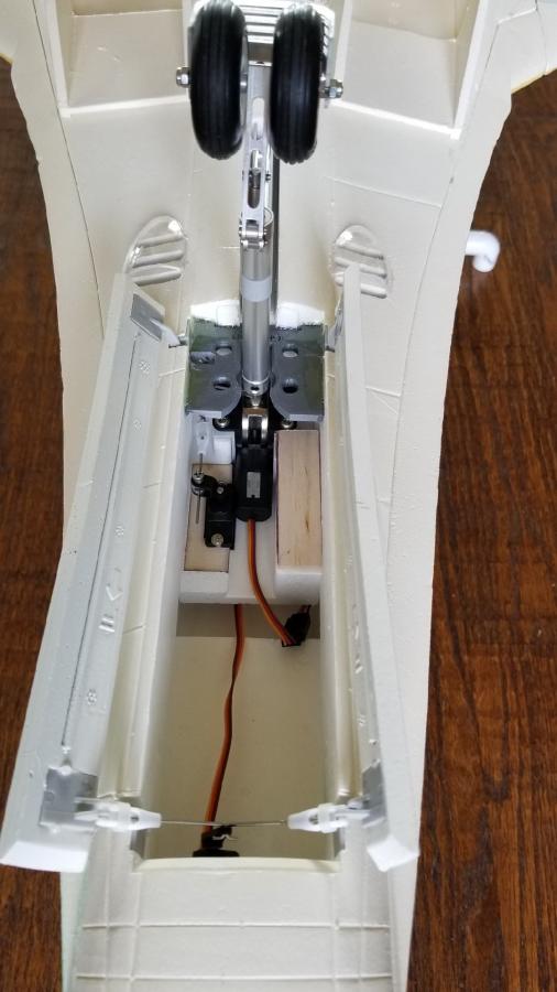

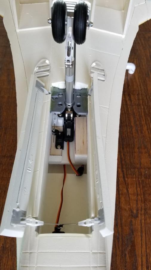

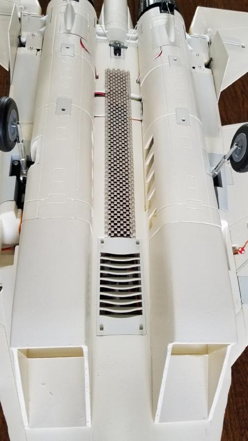

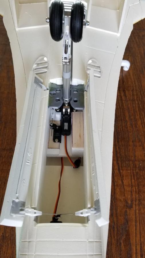

                                          I was also inspired by Air Guardian videos and got a SU-35. A friend helped with maiden flight couple of days ago. I used 6000 mah and she flys awesome! It's very gentle, much easier to fly than I thought. In terms of difficulty, I put it between E-Flight F-16 70mm and FW F-35. I got the desert camo and it looks great in air!
                                          I am using an AR637T 6-CH RX, so no TV for now, once I get more comfortable with it, I plan to use Admiral 10-CH RX and A3S3 Eagle Hobby gyro. I also installed the nose gear brace from Wildvortex. The brace is a life saver. I have similar brace on my F-35 and it has saved the front gear/retract many times!
                                          I noticed the ESCs get too hot and although there is an air vent right on them, there is no way for hot air to scape, so I removed the long narrow plastic and replaced it with a mesh to improve ventalation.
                                          Here are a few photos that show the nose brace, air vent and my other EDFs.
