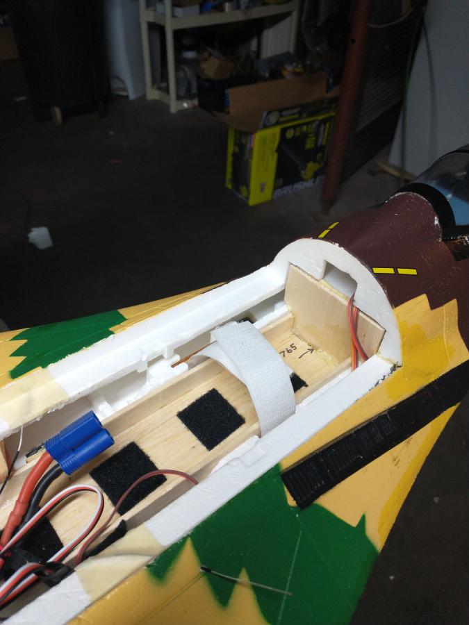

                          • Most importantly, need to glue a balsa wood planck to the front of the battery compartment so the foam that houses the nose gear doesn't break as easily.
                            It may even break after this mod, but if you then glue the thing back in with epoxy, it's not ever going anywhere again :)
                            • This is what I did. Click image for larger version
                              • That's quite overkill... but whatever floats your boat. ( :
                                (With the planck on the front end I think it's more than enough)
                                Also a good idea to install a velcro more to the rear so you can secure heavy batteries (which need to go aft) properly.
                                • Originally posted by Airguardian View Post
                                  I epoxied a layer of glass cloth over the foam at the weak spot.
                                  • That would do it too... but balsa may be more user friendly for most :)
