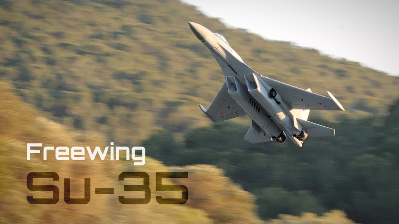

                  And have some more:

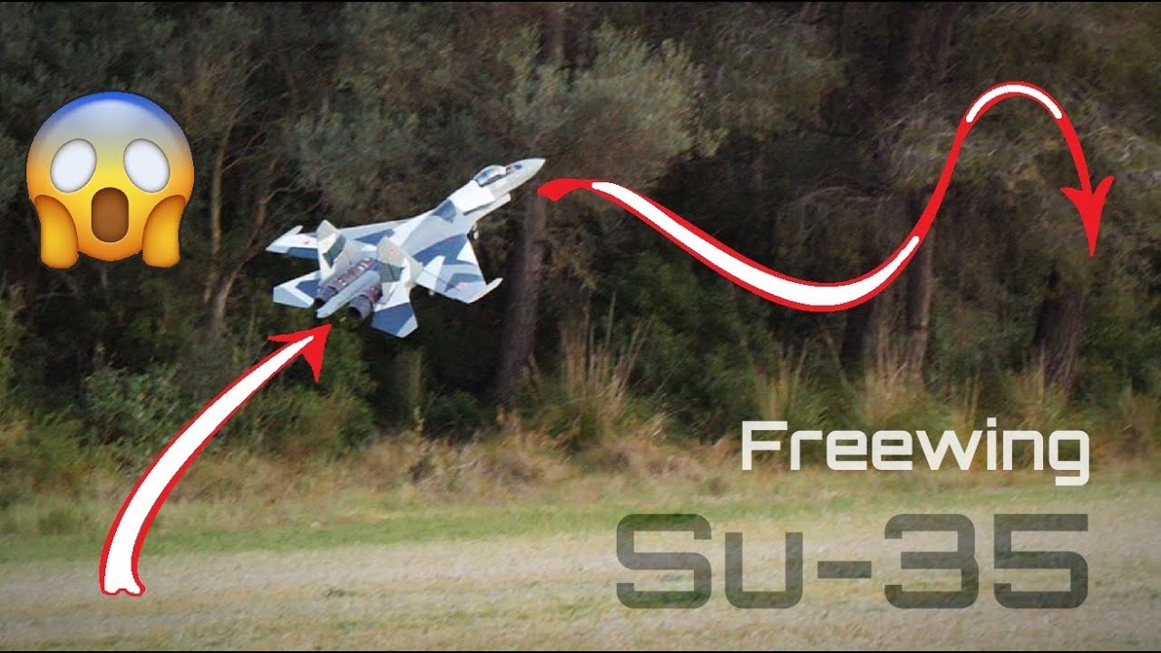

                                I hope the following video serves an educational purpose:
                                These were some flights I made earlier this year, and due to bad runway conditions and not having flown the Su-35 for a while I messed up and got myself straight into a textbook case of PIO (Pilot induced oscillations). In this case, triggered by requiring full throws to take-off at too low speed (forced by bad runway conditions), followed by delay in neutralizing the input, then overcorrecting, and then overcorrecting the overcorrection, and so on, and so forth.
                                Thankfully I was able to eventually pull out of it and keep the plane in one piece but at any point I could just as likely have smashed it down to pieces.
                                The point I want to make here is that my plane is (was) NOT tail-heavy. It is balanced with CG pretty aft, which makes it extra agile-twitchy, but it still has positive longitudinal static stability, that is, the plane is stable. If I take my hands off the transmitter when the jet is cruising, it is going to keep cruising pretty much level.
                                Many would have an episode like this, assume their CG is too far aft and resort to move it forward in an attempt at curing the problem.
                                My footage clearly demonstrates that a well balanced airplane is still perfectly capable of entering a PIO condition.
                                Furthermore, there are documented cases where building too much 'stability' into an airplane (for example a manned cessna or an airliner) is even more likely to have pilots inadvertently get into these dangerous scenarios that are usually hard to get out, and more often than not, end with a crash.
                                Other than the huge scare, you can see that the rest of the flight proceeded uneventfully, and I was pulling the usual aerobatic shenanigans. I didn't even have to retrim afterwards.
                                So that's that. Have it as a word of caution.
                                My take on it is: try not to blame everything on tail-heaviness right out of the box, without more thoroughly investigating the issue and making tests to clearly identify if the plane is actually tail heavy or not by conducting the appropriate flight tests that conclude that. ;)
