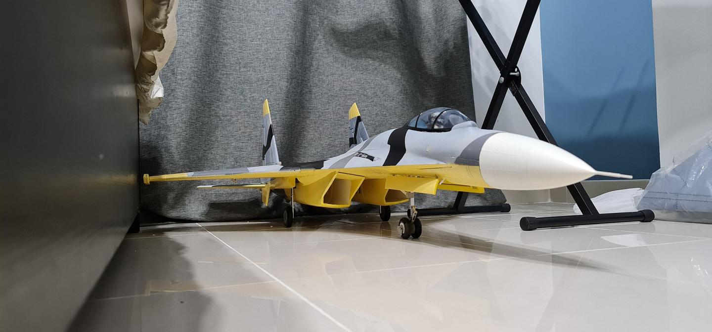

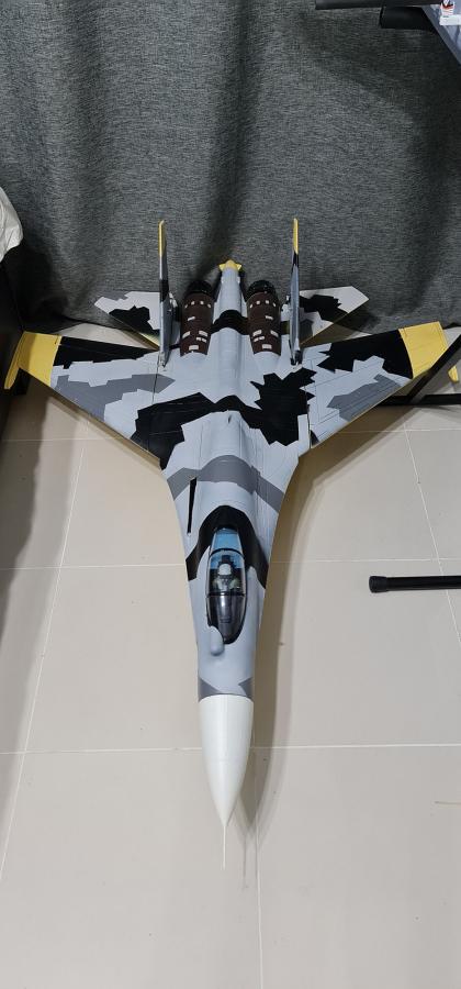

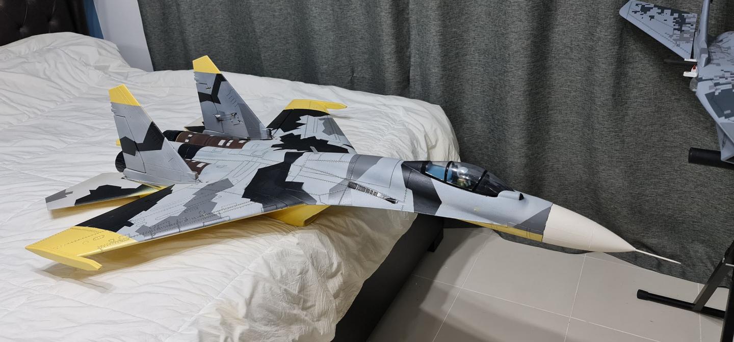

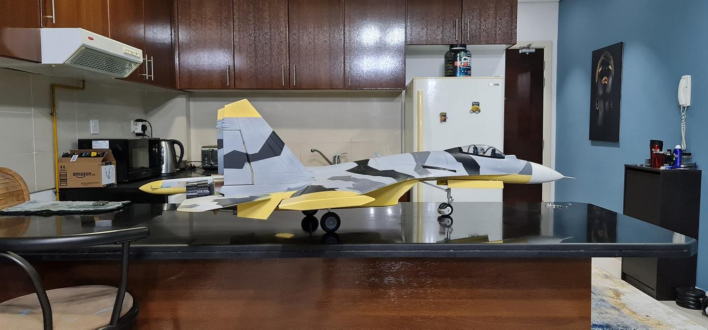

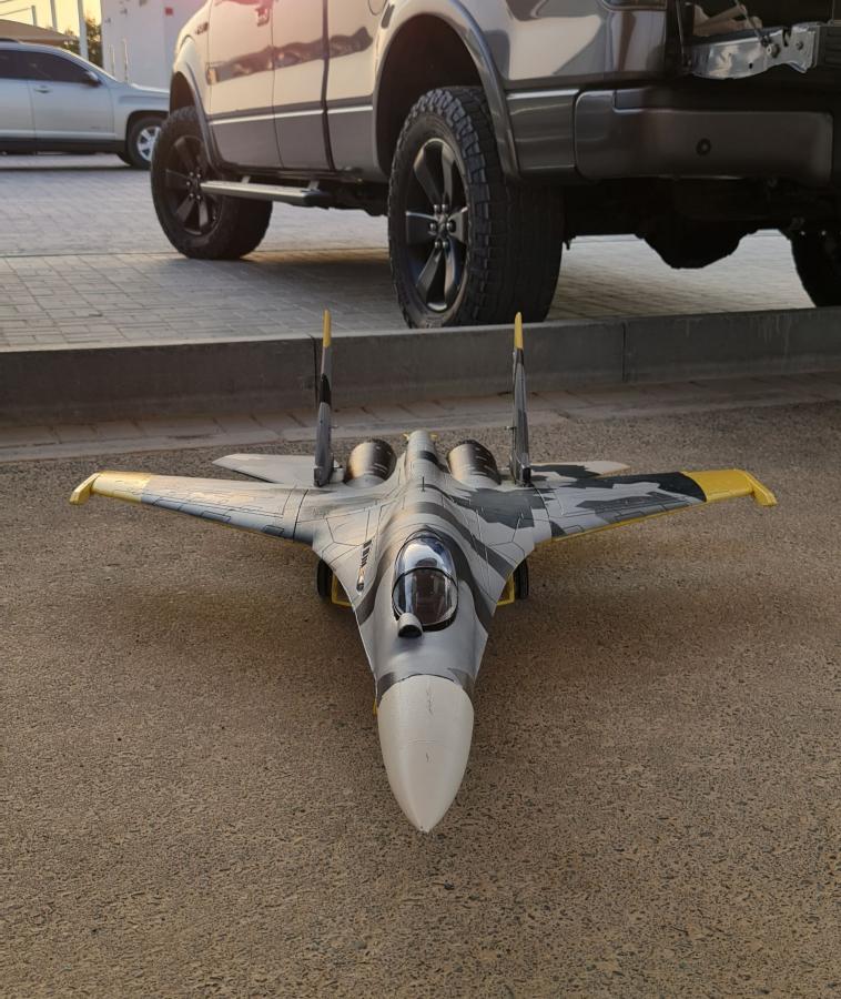

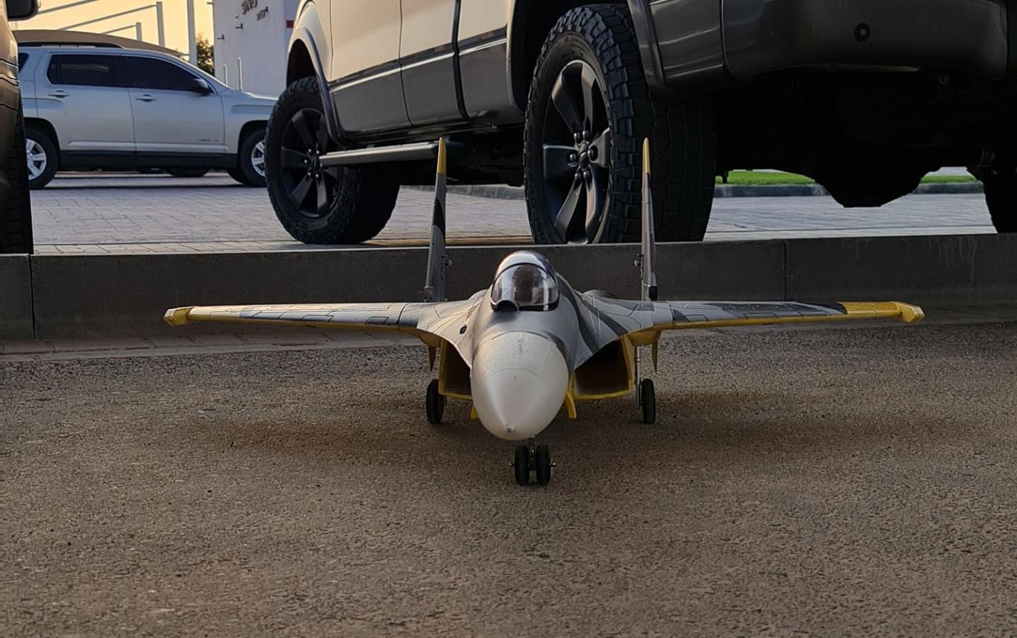

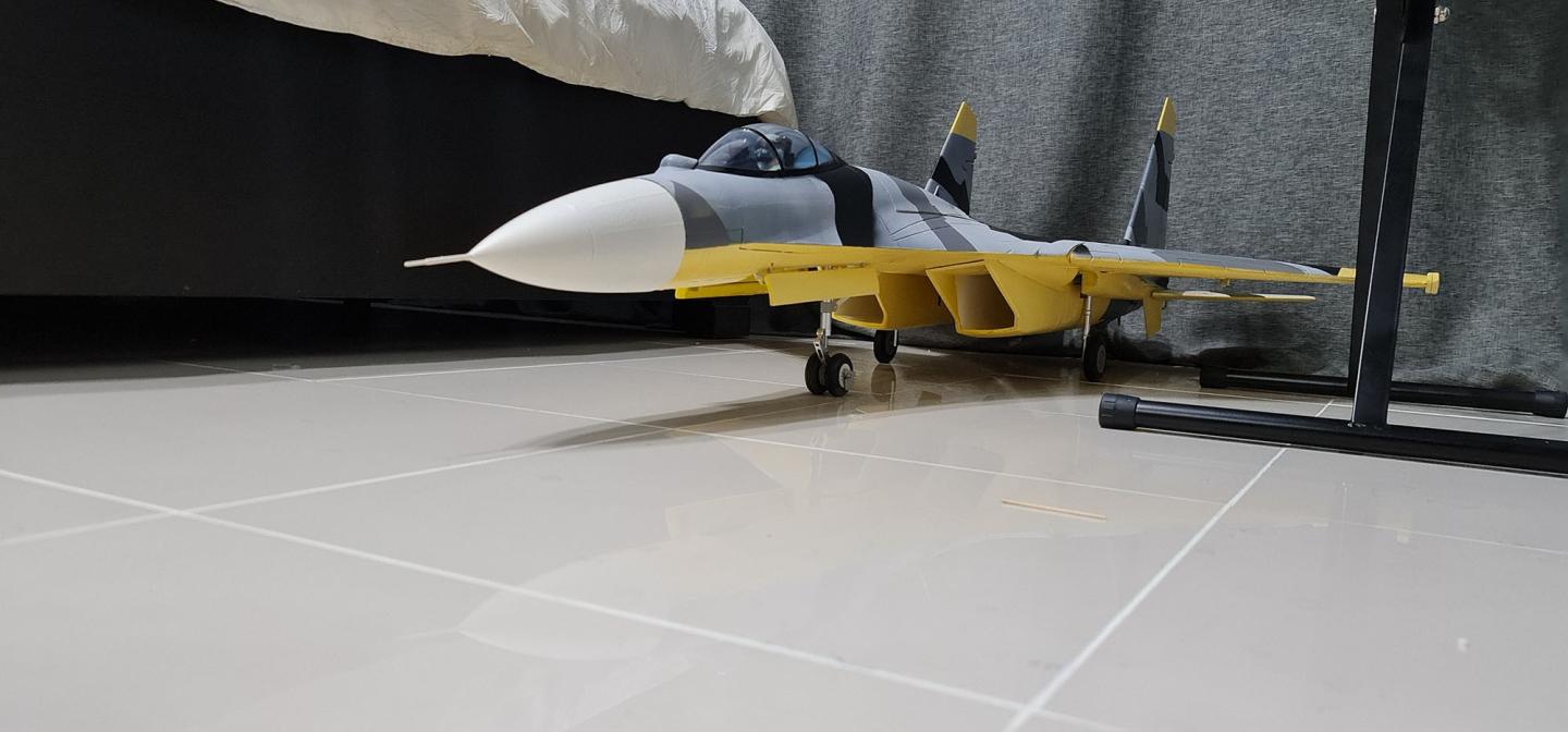

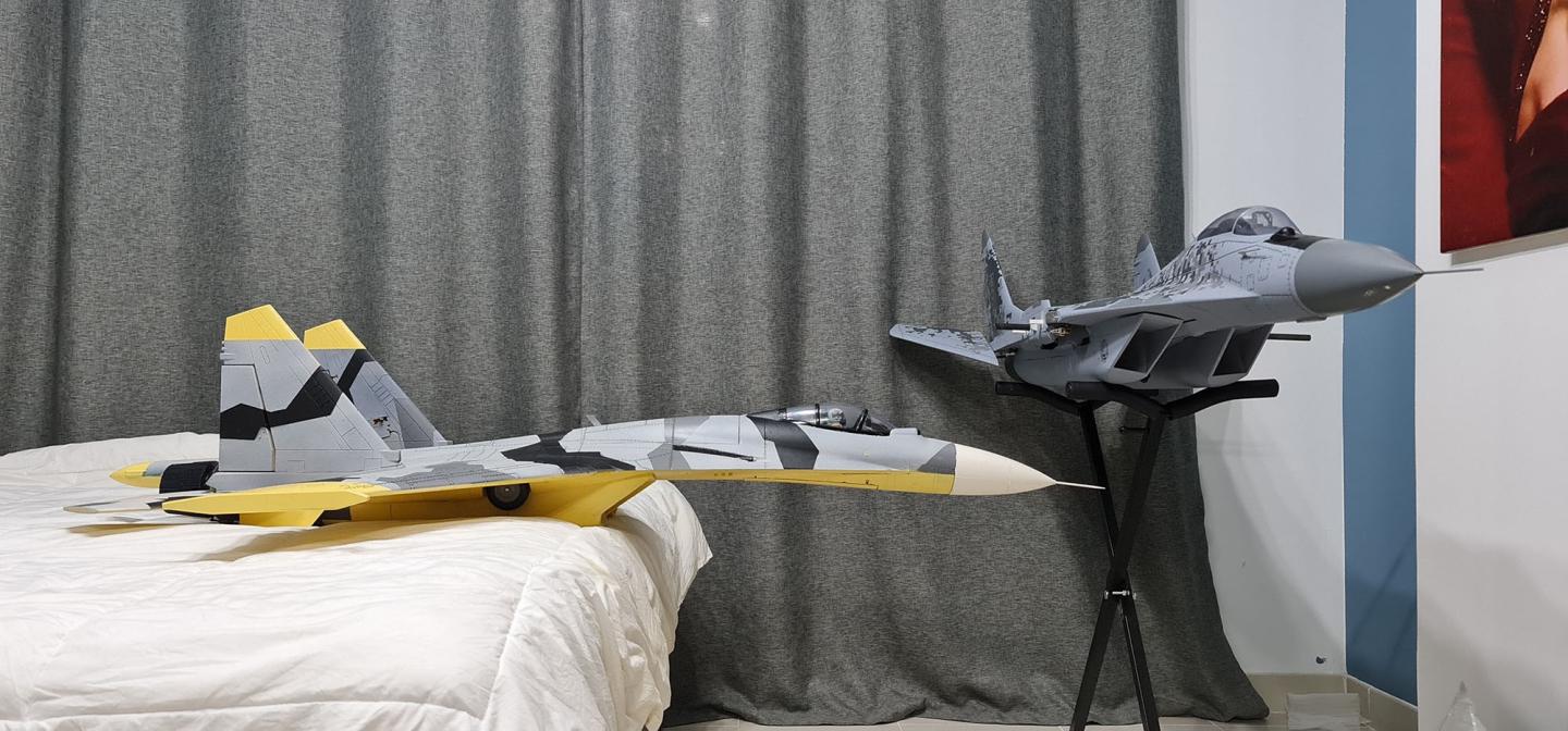

                                      well, i got the Su-35 a week ago and i did the paint job on it with thinner spray cans ( it wasn't easy since it can eat the foam ) attached a few pictures . then i had the maiden yesterday with the following conditions :
                                      - a wind speed of 26km/h its always windy here.
                                      - CG at 170mm ( not that it was my intention to do so but my battery weight is 700gm and all the way forward .
                                      - reinforced the front nose wheel
                                      - reinforced the battery tray
                                      - flying talerons + alirons for roll
                                      - elevator for bitch
                                      - flying on mid rate the full flight 80% and 50% expo
                                      the flight : started with smooth takeoff then the plane suddenly bitched down . i over corrected up elevator and ended up going vertical , surprisingly it kept going up ! THEN I MADE A TURN AND STARTED MY TRIM JOURNEY. it was very sensitive and i was very worried , then i decided to do a landing approach throttle 25% to reduce my altitude . plane went up !!! so i tried again and again and again and every single time i reduce the throttle the plane goes up!!!! so i figured its tale heavy ,, tried to land for the first time after 4 approaches with a bit of throttle and i managed to land it but it was NOT a smooth landing !! ( i felt the plane was out of control all the time ) and i looked like an idiot who is flying for the first time in his life !!! nothing happened to the plane at all.
                                      i have a video of the takeoff an the 4 landing attempts. i will try to post it soon
                                      then i decided to give the plane a full check up and found out the TV nozzles was abit towards down so here is what i did before the re maiden flight :-
                                      - adjust the TV nozzle to more centered location , rudder wise and bitch wise
                                      - added 19gm of weight over the battery which shifted the CG from 170 AFT to 162 AFT
                                      - reset all the trims i did from the first flight
                                      - but the D/R on low rate 65% and 50% expo.
                                      - wind speed between 25km/h and 20km/h
                                      and here is the results:- started with gradually accelerating , the plane took much less runway to talk of with a very very smooth + altitude the kept going , prepared to turn right ( as usual ) and felt much smoother and began the trimming , it took 3 clicks of left trim and 5 trims of up trims and the plane was locked on ! i felt more confident with it so i went for straight up and roll. it did ( AND I'M NOT JOKING ) about 4 turns per second !! i love how it rolls !! the all what i could do in 3 minuets flight in a maiden ( i did ) also i flew about 2 rounds in half throttle which she can handle pretty well. then prepared for landing . went about 30% throttle which the plane responded by descending very steady but still fast so i reduced a bit more and a bit more and landed with about 0% of throttle and a bit of up nose , it was a very smooth landing.
                                      did another flight after that and was even better
                                      guys the plane was so stable and felt so light in the air that i felt it can go vertical for very long , i loved how it flies and
                                      unfortunately i have no video for the re maiden flight but i will try to get one by next weekend .
                                      any ideas ?
                                      i have to thank everyone who told me there experience with this plane
                                      @Airguardian thanks for insisting to say that i have to use expo it saved my plane life a few times during the first maiden THANK YOU
                                      @paulrkytek thanks for the painting tips over the all private messages you took the time to write
                                      @xviper it is a better jet then the MIG .. before flying it i thought the mig is light , but now i know better and i know why u said if u crached all of the three the freewing SU-35 is the one u will buy again
                                      @TangoVector @ kallend @Evan D thank you guys for the tips and all of ur replies
