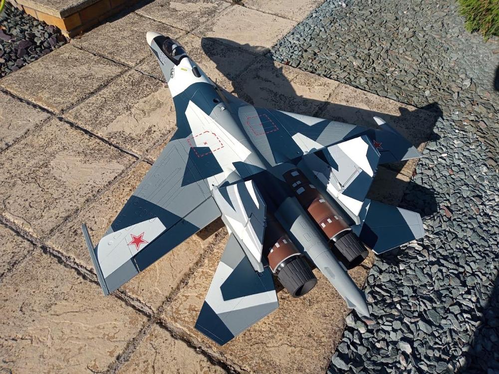

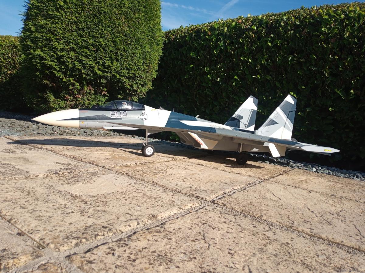

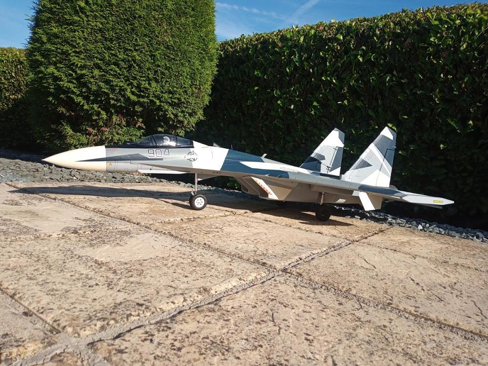

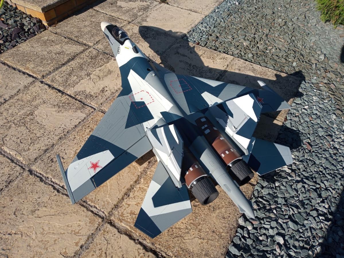

                                        Ok so I finally got around to making my latest version of the SU35 from all the spare body parts I had hiding in the loft and transferring most of the hardware from Sharp Nose Su. So it has the twin fms 3060 1900kv units I have used on the previous models, twin 80amp Hobbywing escs, separate BEC run on 2s 600mah lipo, Hobby Eagle A3 Super4 gyro on tailerons, ailerons and vts. and It did not need much aileron movement with the tailerons. All up weight with 820gm Admiral 5100mah 6s lipo comes in at 3550gms. I have uprated the mains oleos and wheels and use 5mm pins and have added a 13mm thick ply triangular restrain to the rear of the mains legs as per photo Hard to see with matching paint.. The nose oleo has larger, better wheels for my grass runway and is backed up with a 13mm thick ply triangular restraint set into the original groove for the stock restraint. Setup is basically as Air Guardian build and setup video including VT alignment, battery compartment mods, uprated stab servos etc. etc. I also have some additional air into the top of the battery bay as per 2nd photo below. Maiden flights went well at the weekend and I will be out again tomorrow !!!.
Name:	SU35 landing gear view.jpg
Name:	SU35 3rd sept photo 2.jpg
