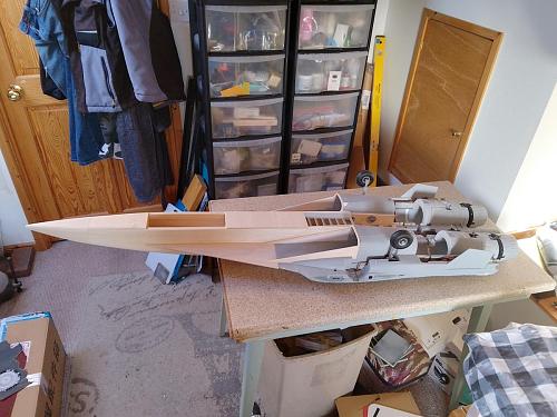

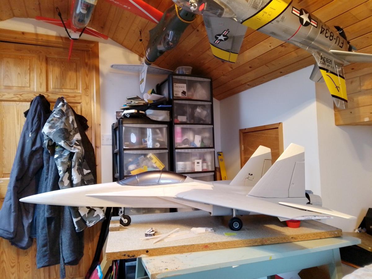

    Progress on Yaksoi130 continues

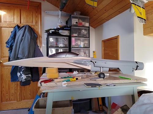

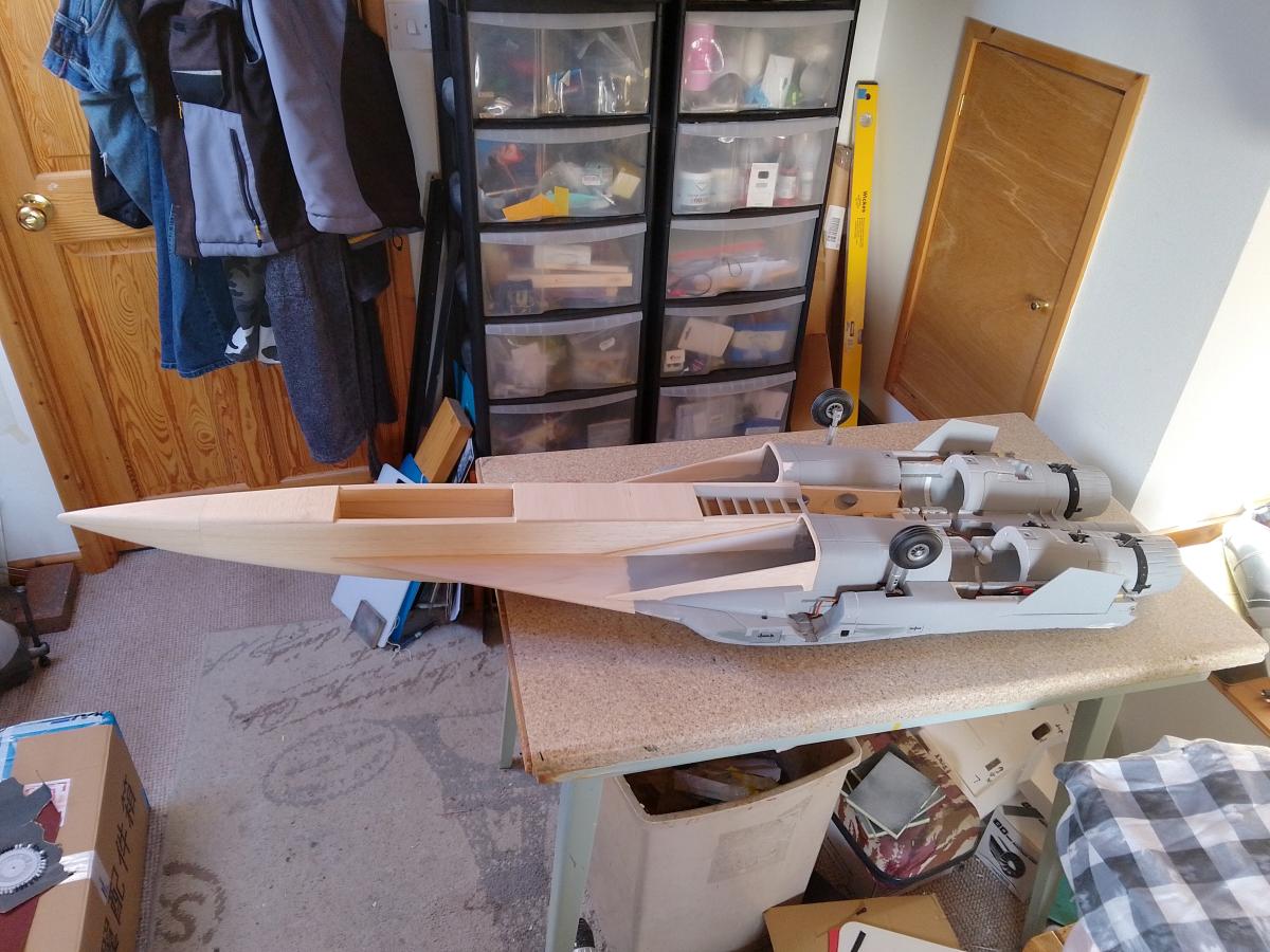

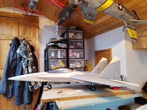

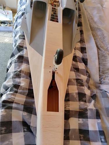

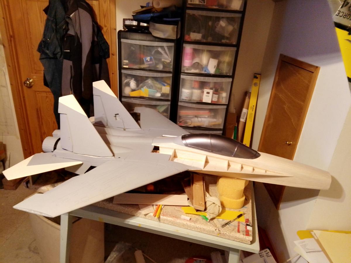

        Seasons Greetings to all. We progress slowly
        Click image for larger version  Name:	Yaksoi 130 progress photo 1.jpg Views:	0 Size:	113.5 KB ID:	365003Click image for larger version  Name:	Yaksoi progress 26th Dec.jpg Views:	0 Size:	142.4 KB ID:	365004Click image for larger version  Name:	Yaksoi underside 26th Dec.jpg Views:	0 Size:	150.5 KB ID:	365005

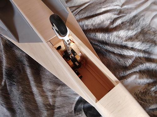

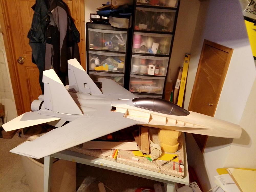

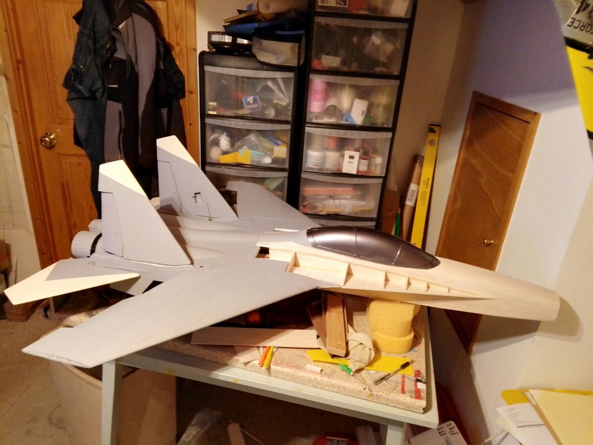

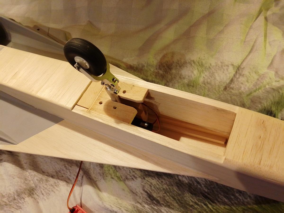

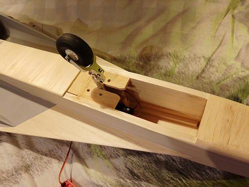

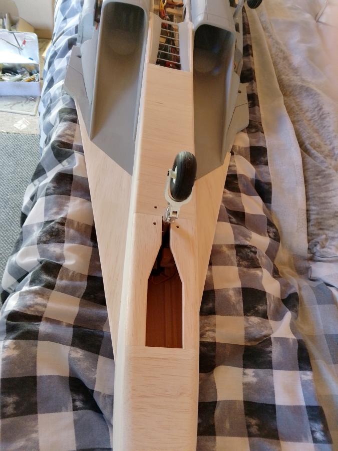

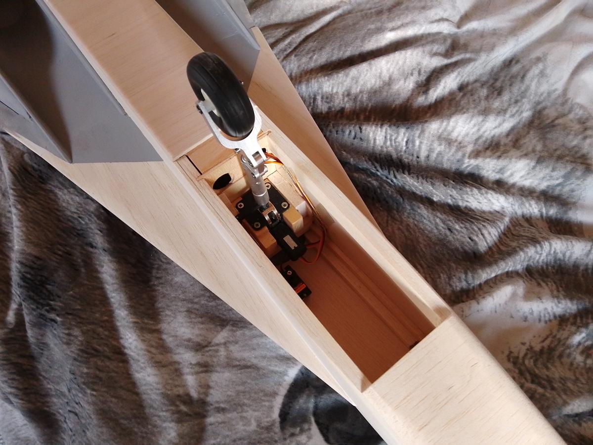

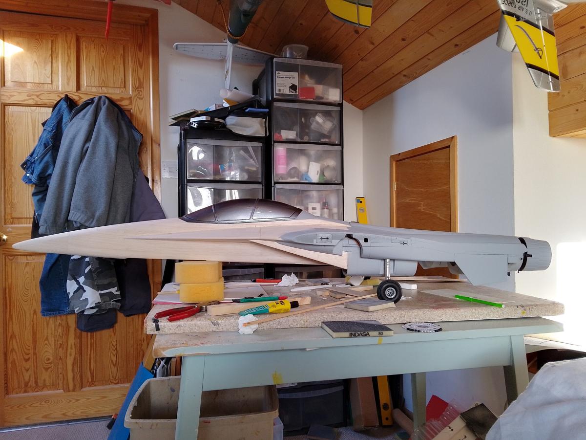

          SHARP NOSE SU . Nose leg install. Nose wheel bay will be painted black with black arrow painted on underside to loose it visually when in the air. The twin air holes feed the battery bay with final air exit at rear of model , to be shown later as I progress. The cut back main fan ducts should hopefully provide better air feed to the fans and I have supplementary feed with 2 additional holes per side fed via the esc cooling duct. Only time will tell. So far mock up shows final weight with admiral 5100mah 70c carbon at 3750 to 3800gms max depending on final paint. The twin FMS 3060 1900kv 12 blade in-runners give 5.2to 5.4kg bench thrust. ( anticipated actual 4.2 to 4.3 kg. ). Any thoughts on if and how the position of the battery ( below wing line as opposed to above wing line on SU35 will affect the thrust angle of the nozzles would be appreciated. ? I am thinking a touch less of down thrust ( i.e less up elevator action for nozzles ) may be required. Given that the new fms SU27 weighs in at 4380gms ( FMS flying weight figures ) with the same fans then all should be ok !!!
Name:	Yaksoi 31st dec 2022.jpg
          Click image for larger version  Name:	Sharp nose su nose leg install 1st Jan 2023.jpg Views:	0 Size:	142.9 KB ID:	365713Click image for larger version  Name:	SHARP NOSE SU  nose leg brace 1st jan 2023.jpg Views:	0 Size:	116.6 KB ID:	365714Click image for larger version  Name:	SHARP NOSE SU  NOSE LEG 2ND JAN 2023.jpg Views:	0 Size:	80.4 KB ID:	365715

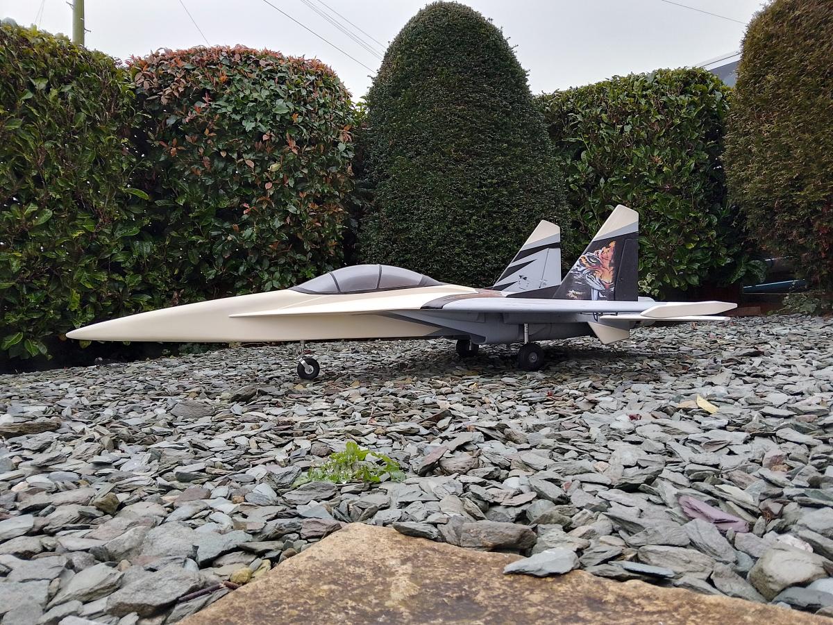

                          #712

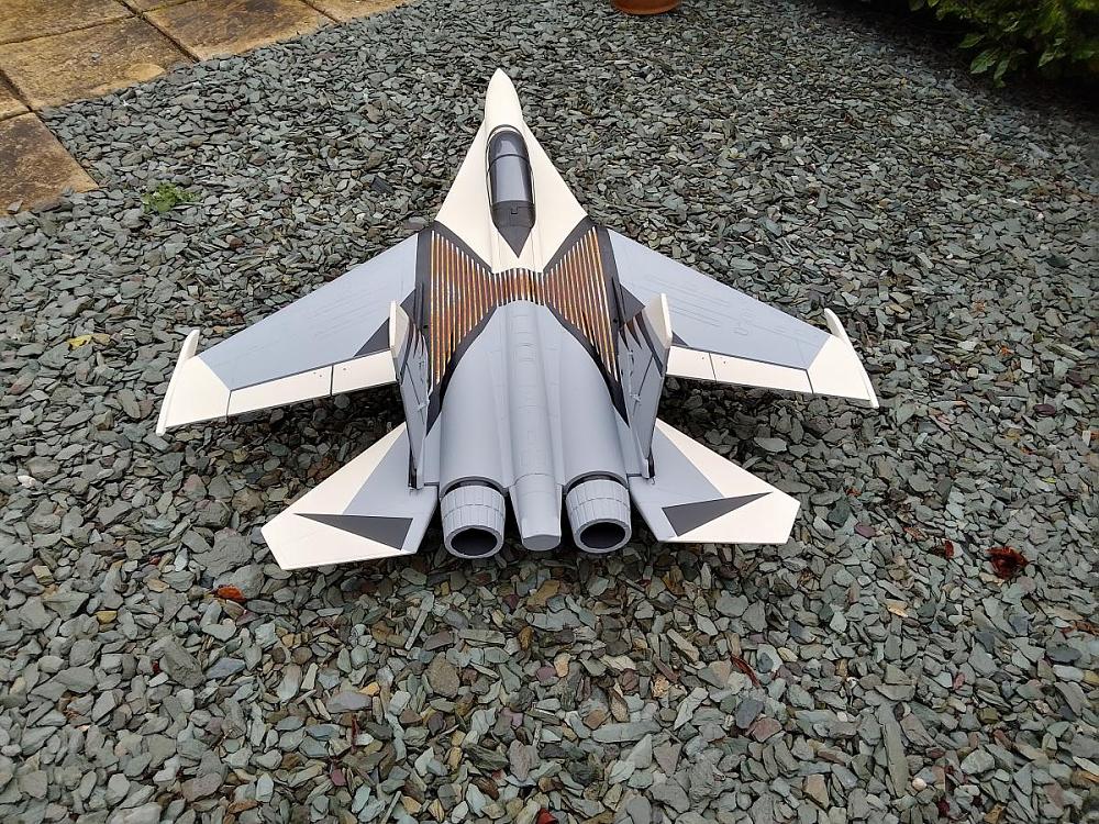

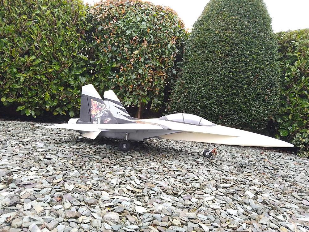

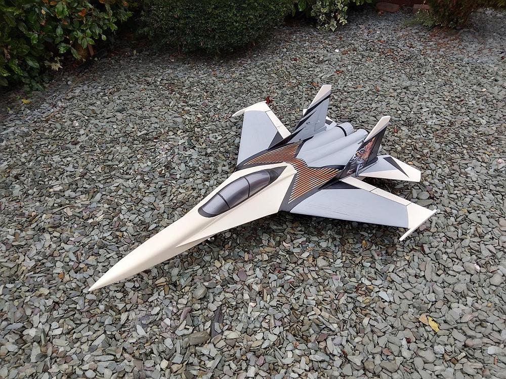

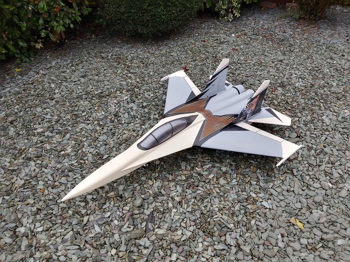

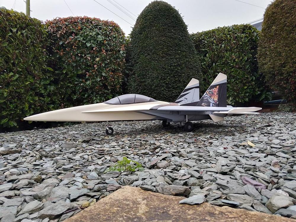

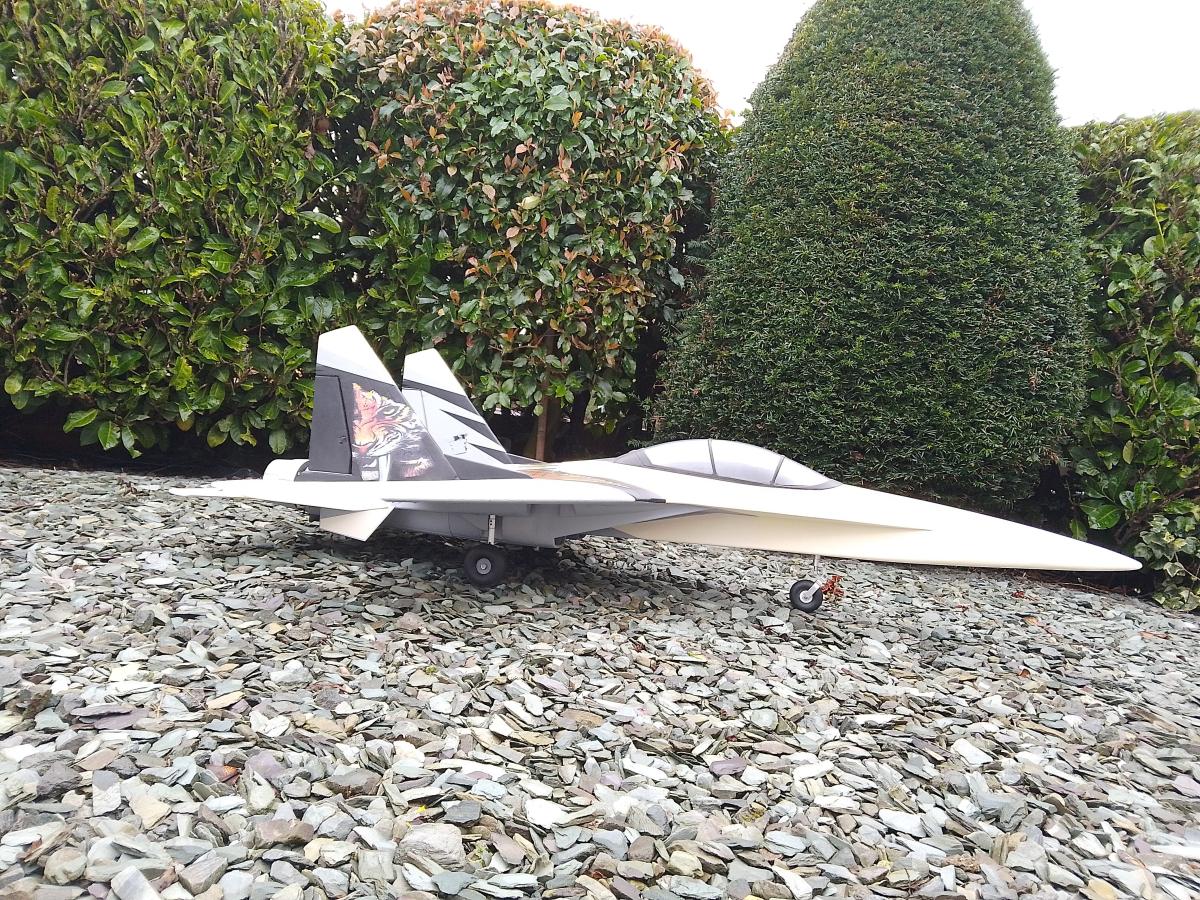

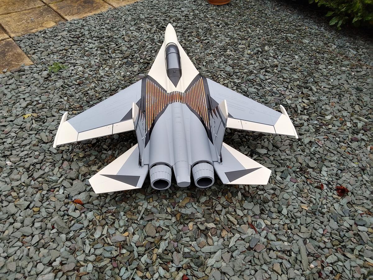

                          Shap Nose SU livery now complete :-
