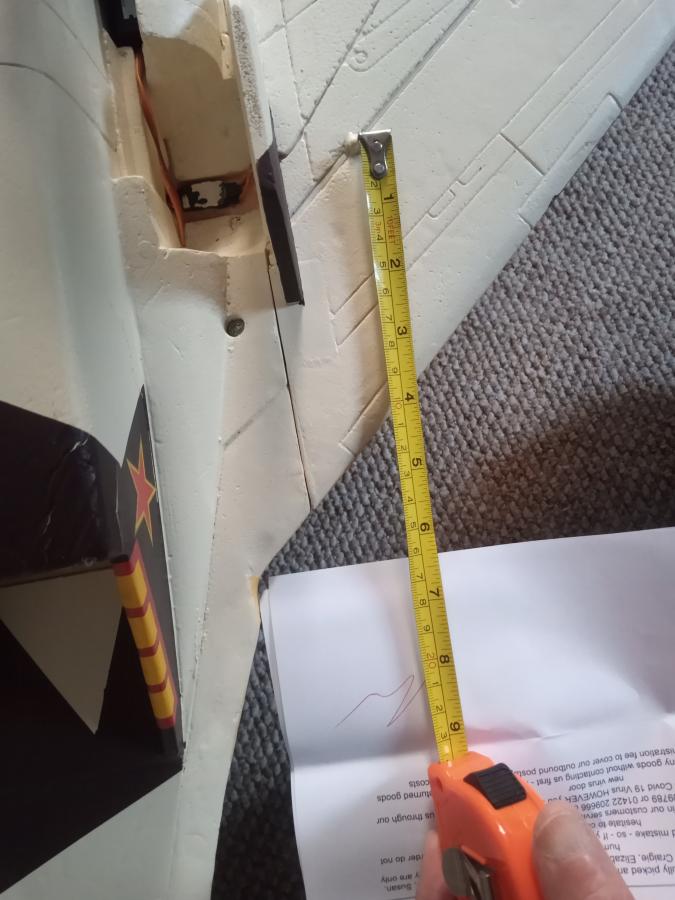

        My SU35 cg is set here at 160mm back

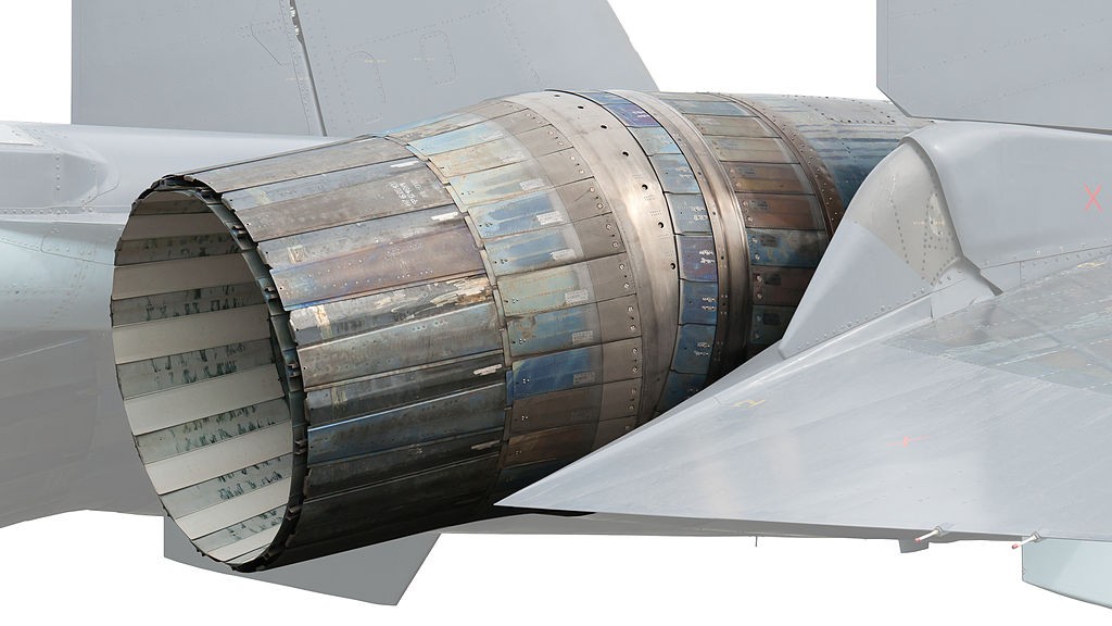

            i thought that the real SU-35 doesnt use TV for rudder ( correct me if i'm wrong ) and i was thinking about making it look as scale as possible.
            It does not... but the nozzles are canted at a 30-32º axis, so when used differentially they produce a yaw component in addition to roll.
            Unless you dismount and reglue the nozzles so they pivot at the correct angle, it will not be scale either. You could get the scale differential movement by mixing yaw and roll together on the nozzles, but the pitch would still be different (Unless you install two servos for the yaw, one for each nozzle to be able to mix it... or as mentioned, changing the nozzle alignment so they are canted at the same axis).
            Originally posted by masterssls1
            can u enlighten me about what u mean when u said You are missing on one of the (if not THE) greatest assets of this jet! :|
            The point of thrust vectoring nozzles is to retain control when the jet is at or near 0-speed conditions, and arguably the yaw axis is the most important one to be able to control in those conditions... and you are outright dismissing it. At least if you cant the nozzles axis like on the full scale jet you will have scale yaw control, but just removing the yaw servo will not cut it.
            Plus you would need to fix one of the nozzles' axis if you remove the yaw servo, which is a nuisance.

                        Today my 4th Su-35 (Lyuda) reached 300 flights, w00t! :D
