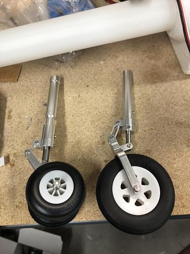

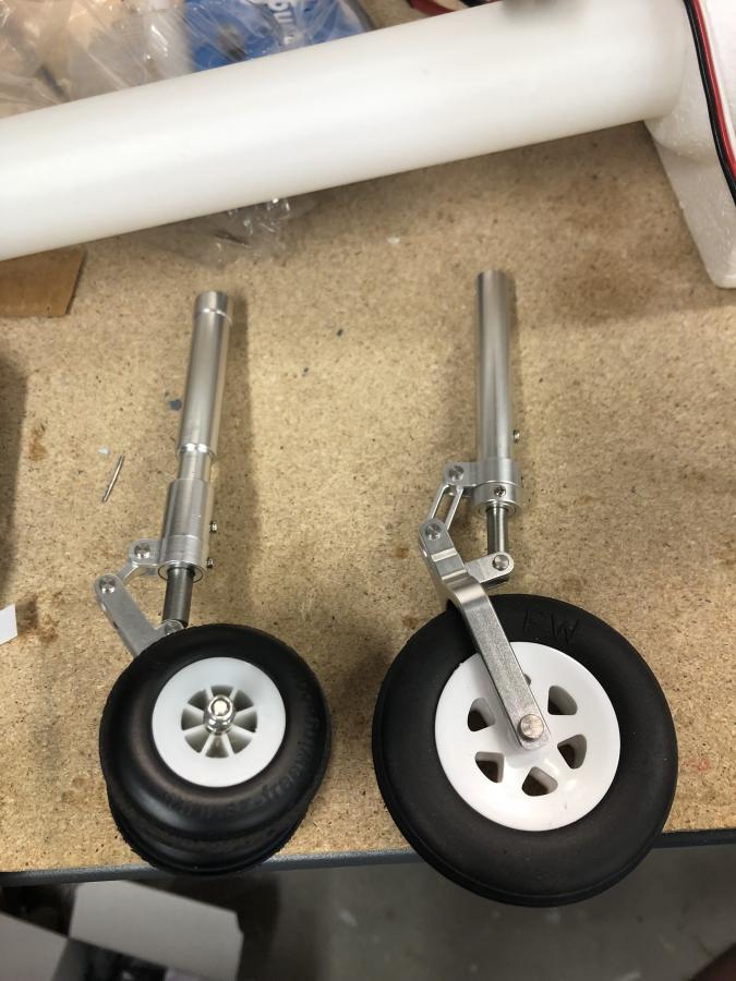

    Originally posted by TangoVector
ID:	315600 It ain’t gonna be pretty…

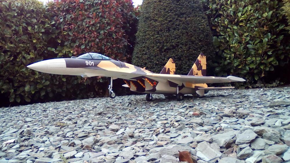

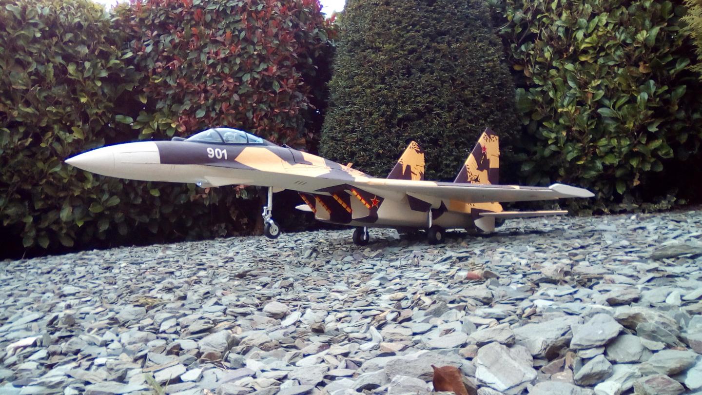

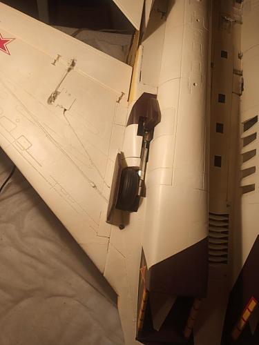

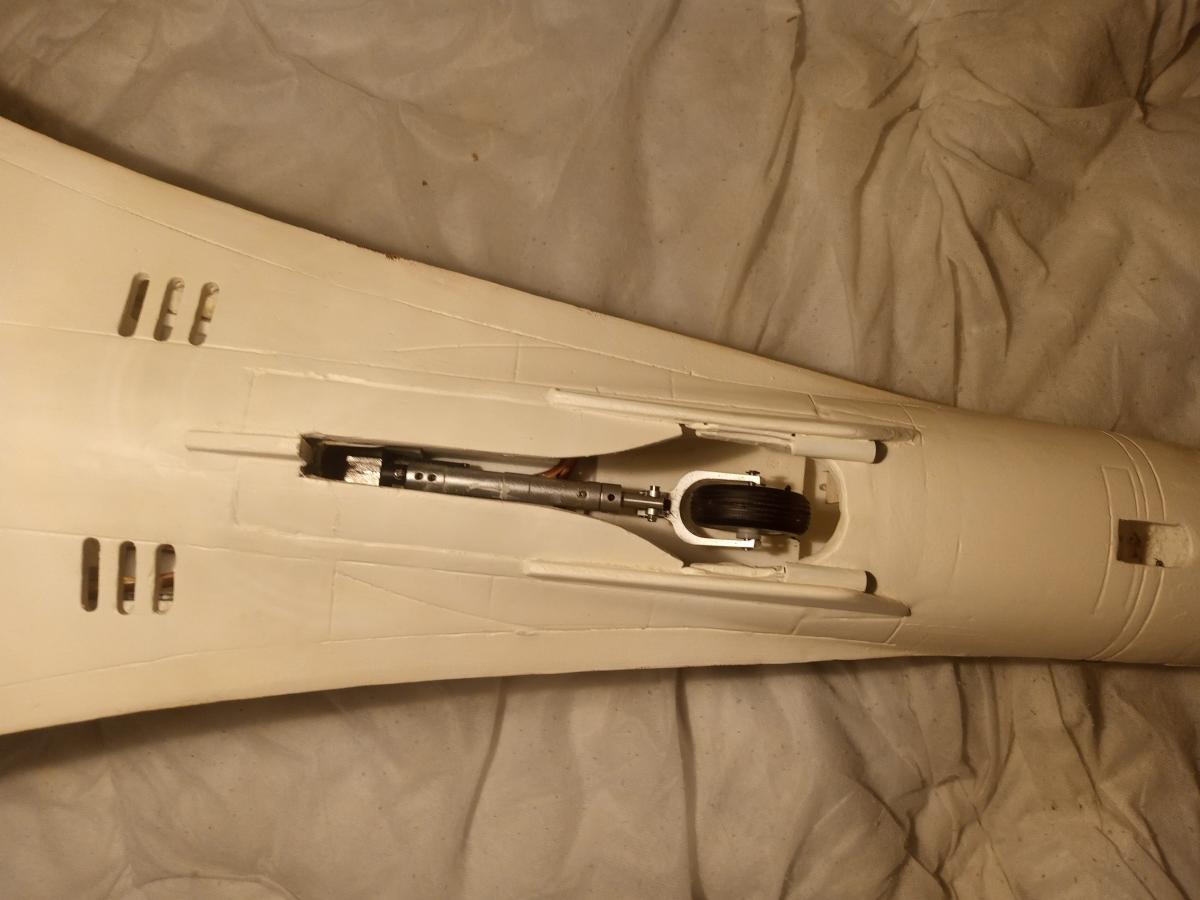

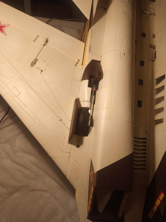

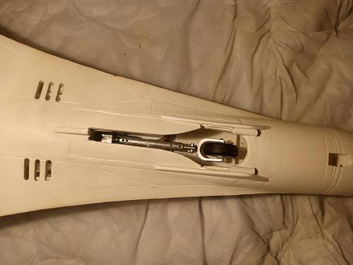

    I have the same fans and servos and they both work fine. I fly off grass and have slightly bigger mains wheels but with upgraded oleos. Good luck with fitting the big wheel without a bit of re sculpturing or catching the doors or door servos on opening. I gave up on the doors and added small ventrals and landing lights to hide the line of the hole left.

      Is that nose wheel strut from a Freewing F -22 ?

        All that is left now is the nose-gear changed to Avanti version. Not scale but I prefer good grass capability since the grass is a little tall at the club sometimes.

          no, its from Hobbyking, as are the mains struts( 60 to 90 size with adjusted spring strength). I replaced the normal brace and slider on the nose wheel with 8mmsq hollow cf burried in the fuselage acting as a body reinforcement and backstop to the nose leg when the gear is down along with a ply slotted nose guide hidden. by the gear doors which are now glued in. There are also backstops to the mains in ply wedges. The nose gear gives me a nice slightly upward angle of attack for take off.
