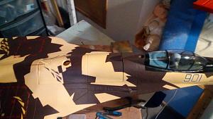

      From my live FB feed

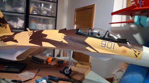

      Well, I hadn’t flown the SU-35 for almost 2 years!
      Put some work in on it, and grafted a 2 seat canopy on, then took it out to fly.
      10-20mph winds and she handled it like a champ!

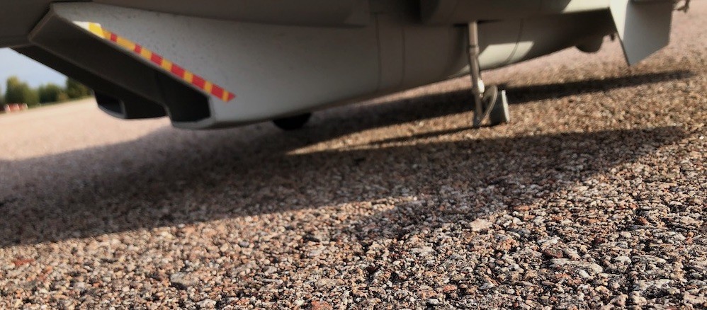

          #284
          Originally posted by paulrkytek
          just need to put in stronger spring on the front oleo ( Its not a Freewing front leg ) and better elevator servos ( again I did not use not freewing originals but othe ones I chose are ok with 3kg torque but a bit notchy so I am trying the Turnigy DMC809 19.5gm 3.8kgf .07 sec digital metal gear ball bearing servos .

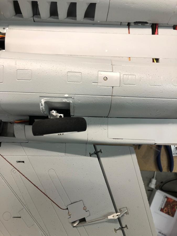

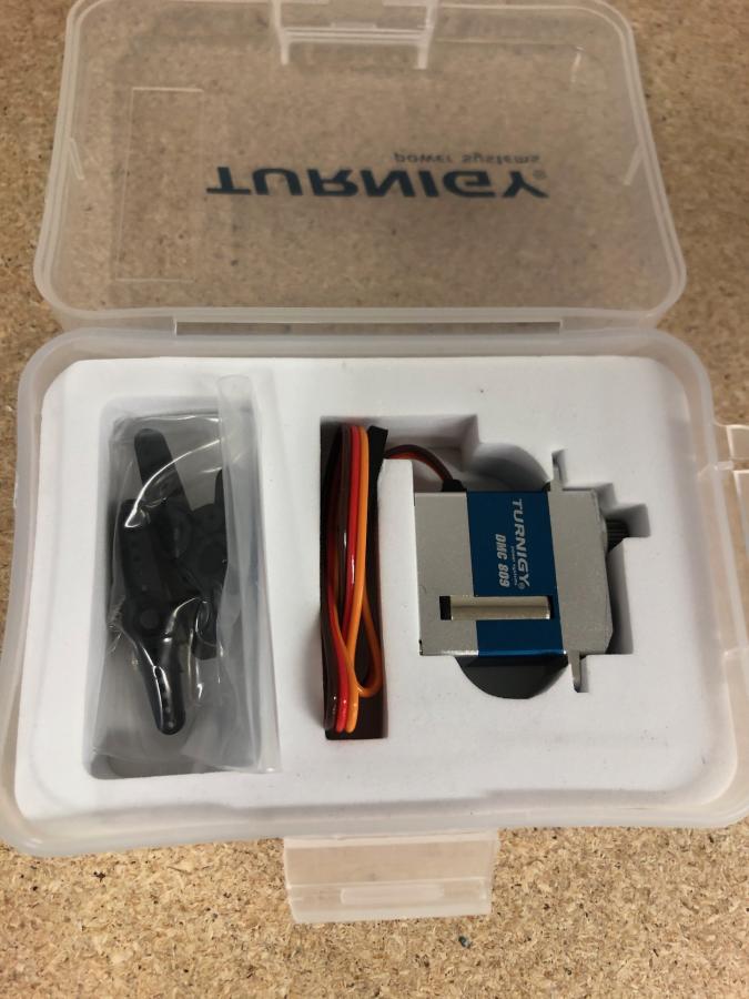

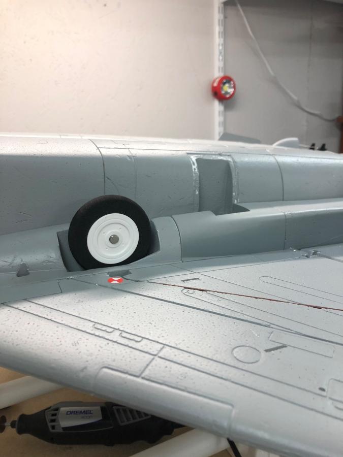

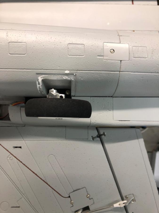

          Hi guys,
          I knew from Airguardians videos that the stock elevator servos aren't the best and after ten flights I do agree, so time for something else. paulrkytek are you happy with the Turnigys and what nose gear are you using?
          Does anyone else have any suggestions for other easy swaps of elevator servos?

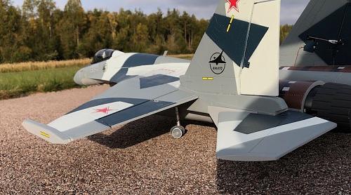

          During a skidding landing, which turned into a go-around, my left main gear took a beating with the tyre coming off and leaving me to land on the plastic rim... After some wild skidding it came to a stop facing 90deg off, phew!
          I have the opportunity to fly off both grass and asphalt, but the club with the grass is much more active with many fellow pilots but the grass isn't always as short as I would wish, even if I help mow it when I have the time, so I have decided to swap the landing gear, for the mains I think I will get the F15 main gears for better grass capability. The front I'm not sure about, I've looked at the list of aircraft that uses the same front servo since scale is not a factor, I want it to perform better on grass, has anyone tried something that works well?
          The nose gear candidates are A4, T33, Mig 21 and some more. There are no dimensions on motions site, so I've only looked at the pictures to guesstimate if they will fit. Any suggestions will be appreciated.
          Thanks!
          /Tobias

            Tobias, its early days yet on the Turnigy servos but they are precise and quick enough for me and i just wedged them into place with balsa at one side and on top before screwing down the lid.
            I increased the dia of the third hole out from the servo arm centre to take he wire elevator linkage. As far as retracts go I used the freewing retract servos on front and mains to ensure matching polarity and sequencing. I used HK oleos but they are heavy duty and have 5mm dia pin holes( bought them in a sale) so I added alloy tube to ensure snug fit on freewing 4 or 4.1mm pins, The rear oleos were 75mm long ,69mm dia wheels and I picked the nose leg to suit and give me a good angle of attack for take off on grass and they now work fine but it did involve a bit of time and effort to set up and get the best spring rate and ride height for the final all up weight of 3450gms so I guess it depends on how much spare time and patience you have. I also added some 6mm ply backstops to all 3 oleos to help take the strain off the pins for the occasional less than perfect landing !! If in doubt I suppose you could simply stick with the stock Freewing units but add some restraint to the rear of the oleos. Also you can usually find the Freewing oleo/unit lengths in the spares section of the model on their website if you click on the unit and check out the Q&A`s

              Even when I operated from grass I kept the nose strut stock. The F-15 mains should be a good improvement though ;)
              As for servos, my reference go-to was the TGY-306G that is no longer manufactured.
              Because of this, I have been researching new servos now for quite some time and I just placed an order with a hell lot of high-end servos that are not crazy expensive to test out:
              KST DS215MG, ALZRC DS452MG, TGY DMC809, VOTIK 9495/9497 MG-D, JX PDI-1151(/71/81)MG...
              Any of these should be able to improve substantially over the stock servos. In adition, a few of these are 300Hz capable, so for those using good gyros, that's also a thing to consider.
              I have not flight tested any of them yet so can't give feedback in that regard, but have the DMC809s around here already which look fantastic and had a friend made a comparison of the KST to the stock servo, video here:

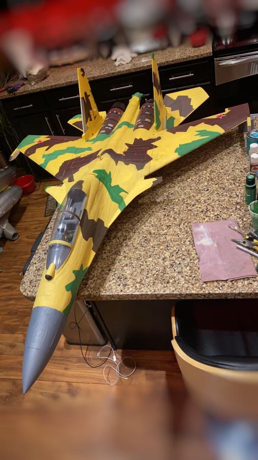

                  #288

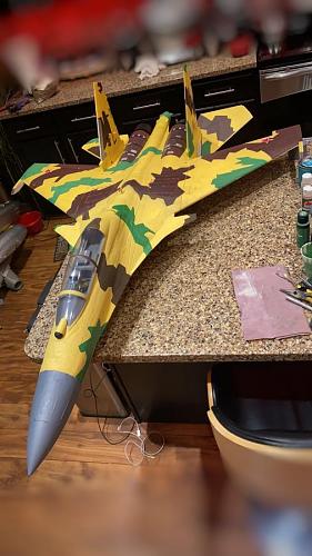

                  Click image for larger version  Name:	F69E3632-7A11-4056-8967-CDC91DE66955.jpeg Views:	0 Size:	73.4 KB ID:	276351

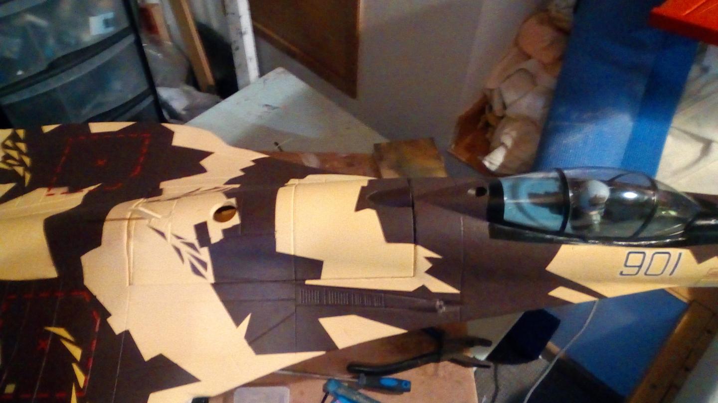

                  Finíto! Finally got the canards on and painted with my custom 2 seat cockpit.
                  I couldn’t stand the Christmas green so dulled it down, and matched the faded yellow up on the nose, with careful blending of yellow, white, khaki, and a drop of red. Will eventually airbrush the exhausts and weathering.
                  For now, off to the St George Electric Fun Fly for a bunch of great flying/weather and people!
                  Will post pics and specifics of my conversion after the fly in.

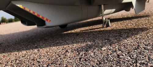

                            #293

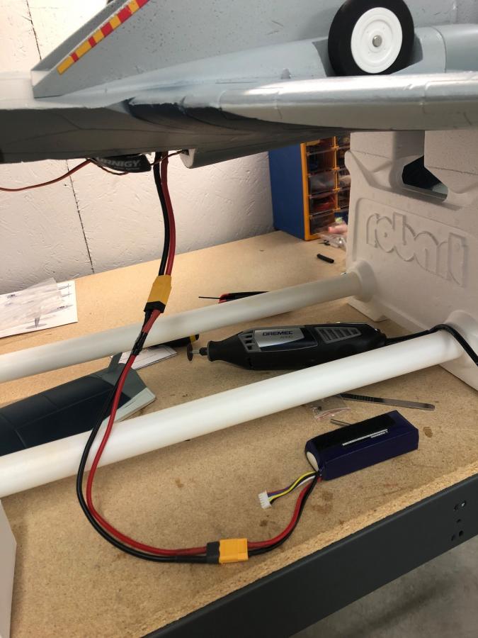

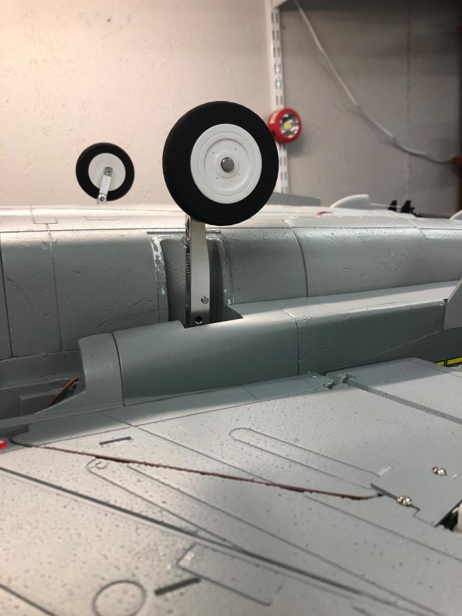

                            Finally the gear (pun intended) has arrived. Actually it arrived awhile ago, but other things took precedence. Anyway, I have now mounted the Freewing F15 main gears into the the Su35. It was a drop in fit except they were both pointing toe-out. After some Dremel-action they are now straight and it is on to the next modification, the elevator servos. I bought the TGY DMC809, looking forward to dial it in with those, wasn't too happy with the elevator feel of the model, will work with my expos and rates to find my own sweet spot. I'm also thinking of changing the servo-horns on the TV-elevator to get some more vertical movement.
                            There is also a picture of my bench-battery solution which makes it very easy to work with my models powered up on the bench. The battery is a 1800mah/4S (because that's the one that was closest to grab) with XT60 connecting via my XT60-XT90 cable to the model.

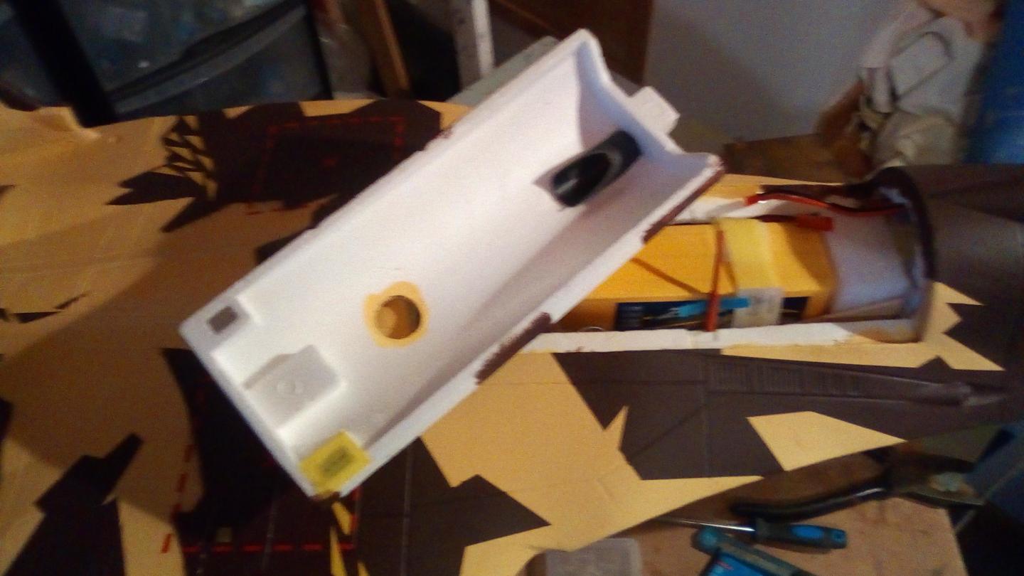

                                  Added air intake and exit scoop to improve cooling of battery and esc as per pics attached Click image for larger version
ID:	282714​ Click image for larger version
ID:	282715Click image for larger version
ID:	282716 Ignore battery its just for balance I normally use Turnigy 5000mah 60c heavy duty
