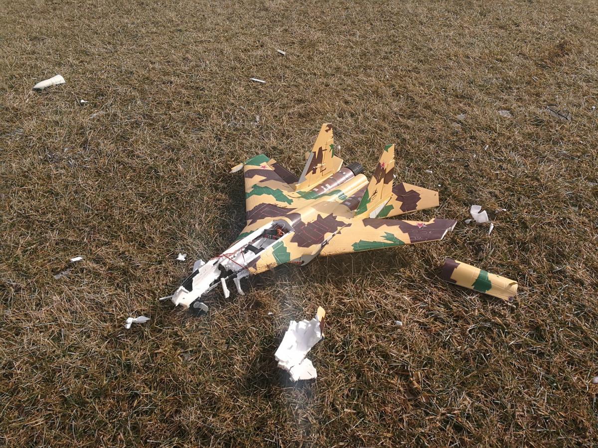

                                  I crashed mine on takeoff last week, sadly. But she's repaired and ready for flight again.
                                  Last winter, I installed a gyro on the TV nozzles, which forced me to move around some channels on the receiver. I failed to notice that I didn't put enough expo on elevator, and none on the nozzles.
                                  When I took off, on a grass runway that wasn't cut really short, it took quite a while for it to get airborne, and so I pulled it off the ground, fearing an overrun.
                                  As soon as she got airborne, I got in trouble: she jumped into the air, and I over-corrected badly. She hit the high grass with one wing and cartwheeled. I think it was a good thing that the crash happened this quickly; had it gotten really airborne, with these hyper-sensitive controls, I don't know whether or not I could have landed it safely.
                                  Result: one wing ripped out of the fuselage, nose broken, nose gear doors broken off.
                                  Lessons learned: check and check again after a serious modification.
