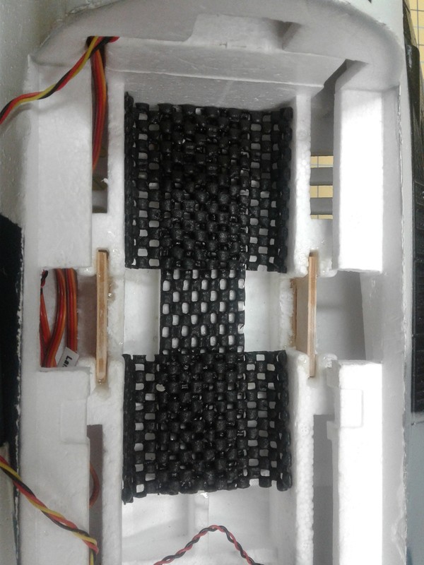

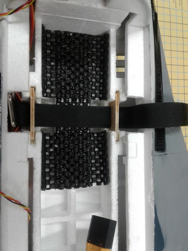

      One final mod to the battery tray. Opened up a couple holes so I could have easier access to the strap. I can strap the battery in now with just moderate pressure.
      No more stressing the battery bay. I may go ahead and strengthen the inner fuselage area up front. We'll see.

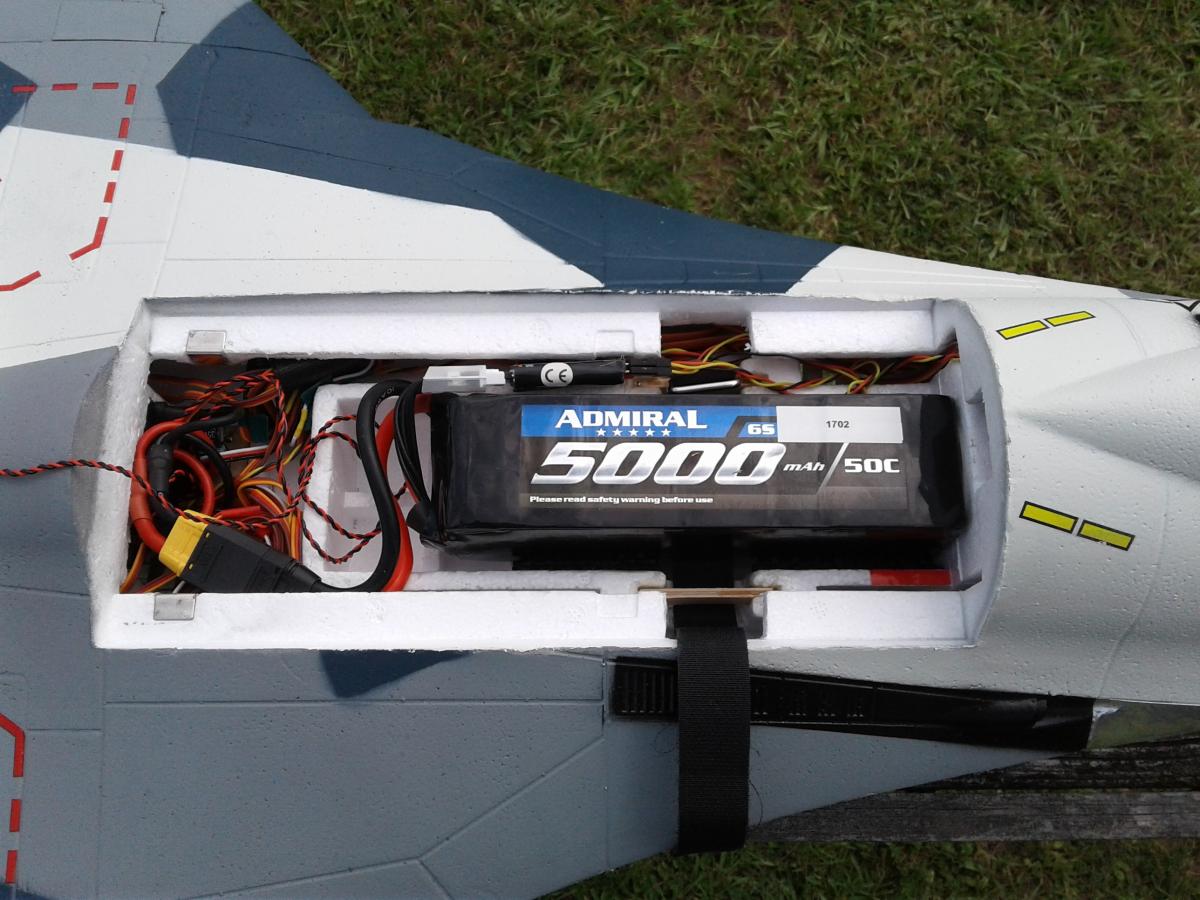

                                        Here is my placement for the two different types of batteries. The red tape marks the 1" space for the Turnigy.
                                        Click image for larger version  Name:	 Views:	2 Size:	135.8 KB ID:	154046

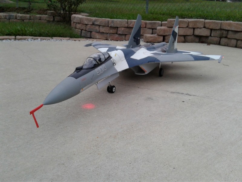

                                          Wife made me a pitot cover since I have an actual pitot system in the bird. With the Cg changes made yesterday, she is finally signed off. Good luck to any of you flying today gentlemen.
                                          Post your videos.
