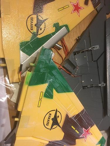

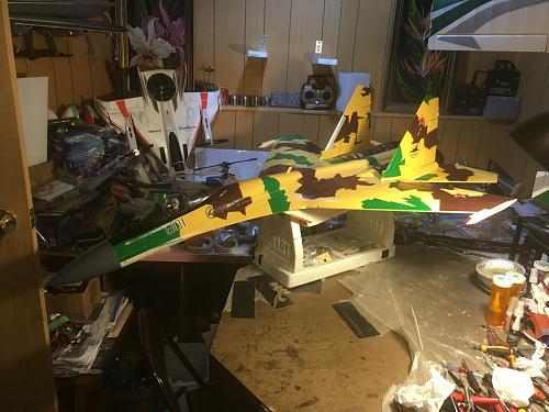

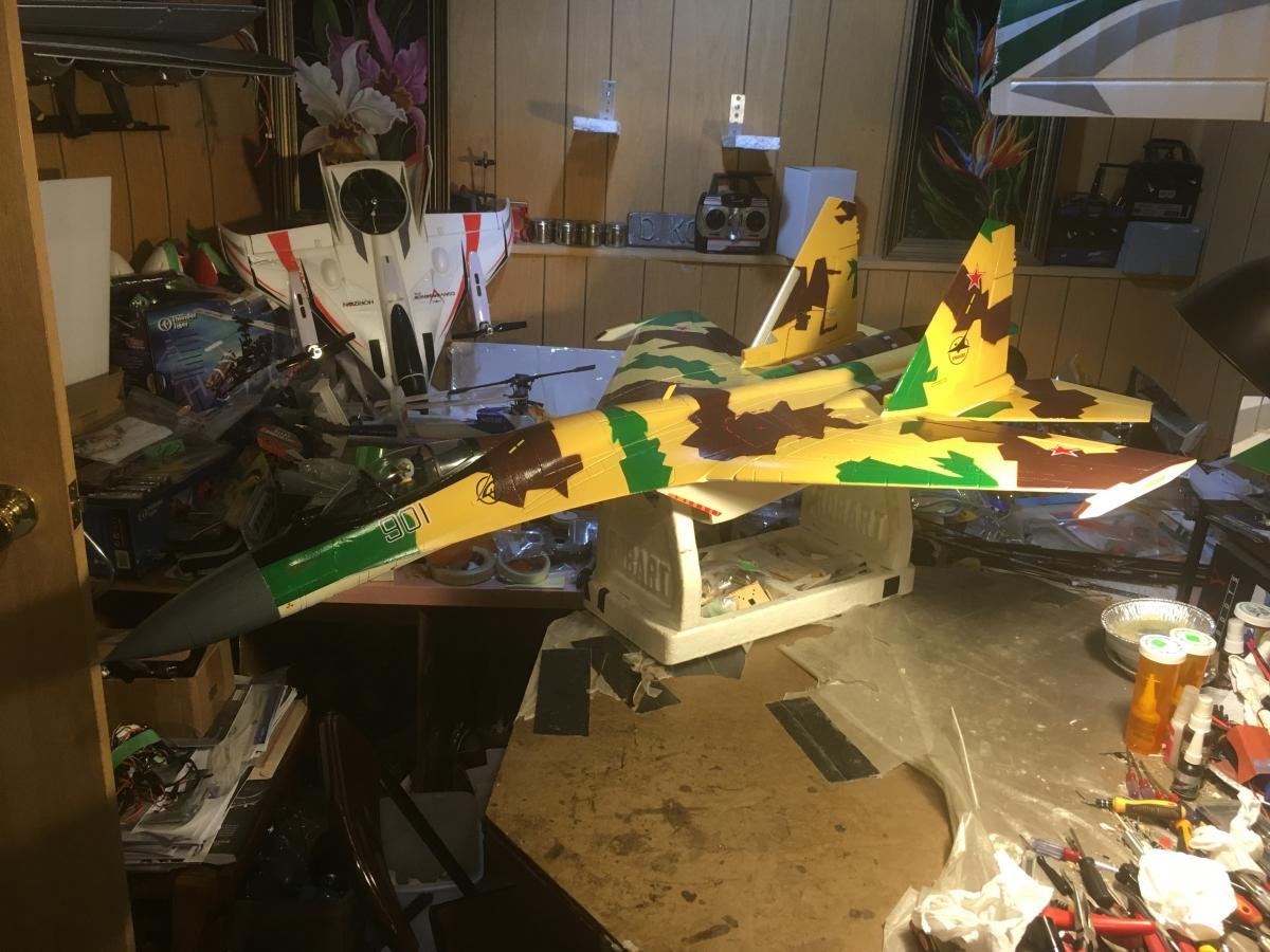

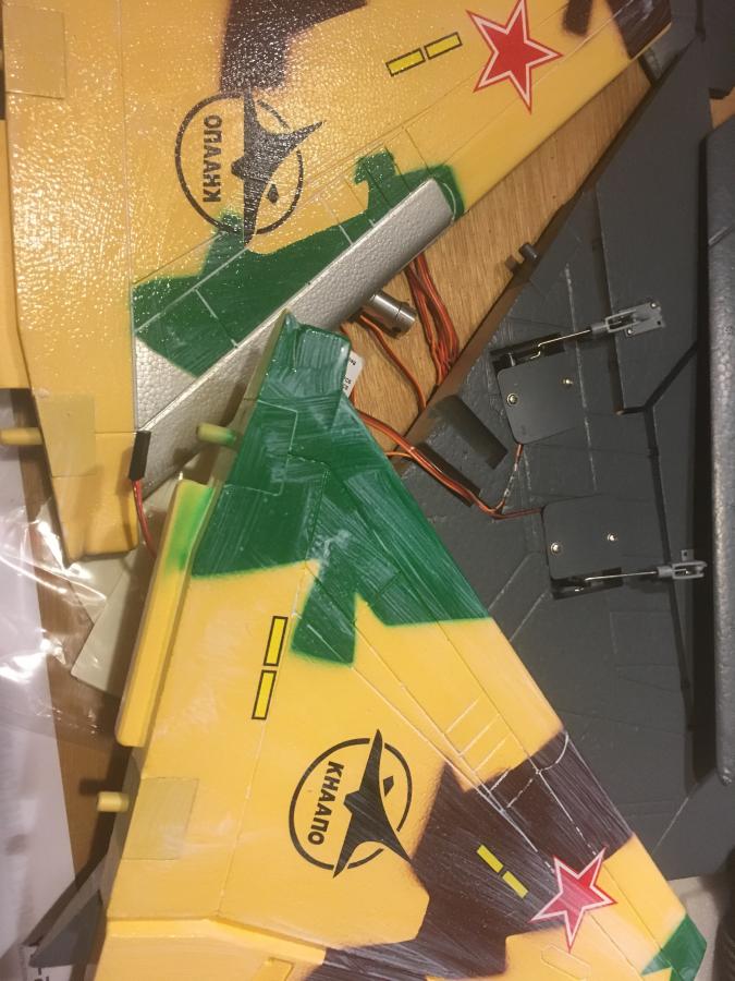

    I'm almost done mine. Did some reinforcement of the battery hold down area, reinforced the little nose strut brace thing and glue in a piece of wood where it comes to rest so as to take up that space. Maybe that brace can actually act as a brace. Did all the mixes for the nozzles and will eventually install an A3-L HobbyEagle gyro, mainly to help with the rudder vector nozzle servo. I may as well hook up the ailerons and elevator, too. All's left is to put in a couple different batteries and mark where they have to sit to achieve the desired CG. Then hang it up till a nice day comes. Winter is almost upon us so may not get to fly it till spring.
    And a picture of that rudder decal that's backwards.

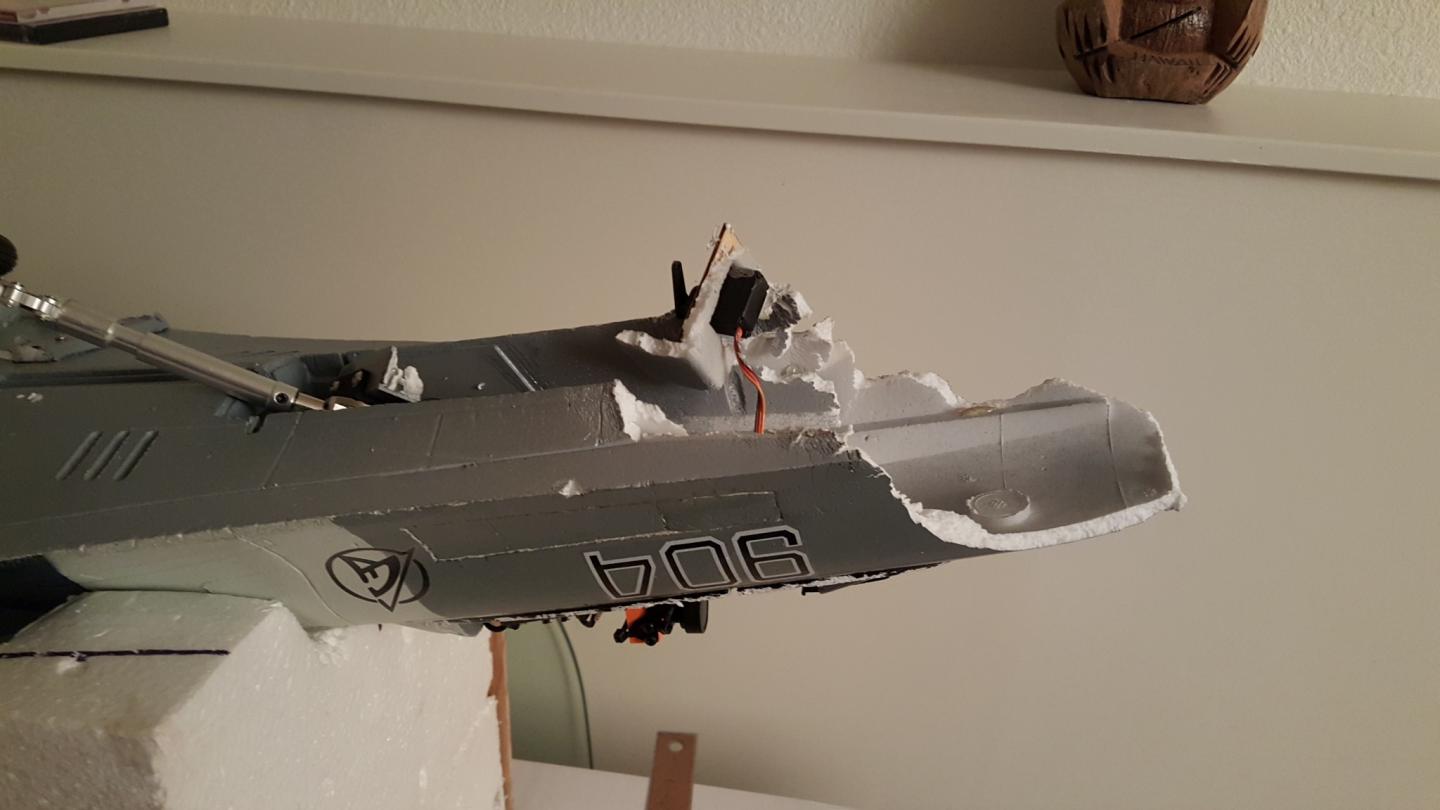

                Hi guys! Thank you for starting this post. My second SU on its way from MotionRC and scheduled delivery on Monday, Oct 8.
                Unfortunately my formation flight didn't go so well. We weren't flying jets, just ww2 birds but, still pretty cool video. My P47 went up in the air the next day, minimal damage, my buddies Spitfire broke in half.on impact and took some work. He had no control after we collided because my p47 cut his elevator linkage.
                (This is my friend's channel btw.)
                Regarding SU, i wrecked my first model this summer, in fact, the 4th flight took place just 2 weeks ago. This time, it will be a winter project as it sustained significant damage, basically my front end is gone along with intakes. Stalled on failed landing and took a nose dive in to the pavement..
                After watching hours of videos on youtube, i realized my mistakes. I wish i would have done this before my last flight... oh well, lesson learned.
                One thing that i still can't get a grip on is that all surfaces were aligned by the book, TV aligned by the factory marks. Elevator at 11mm. CG was at 155mm (with gear down). Also, i noticed that my servo travel on the elevators were different. Left had more travel than right. During my first flight, i noticed that i have insane amount of "down thrust", i attempted to trim (was not using TV on first flight). After trimming elevator, i tested flaps, deployed flaps and nearly hit the ground as it had strong nose down effect. At the time i didn't know that i would get this kind of response from the plane. I am used to flying ww2 birds and normally on flaps down aircraft flares up.. not down lol. So, now i know that jets have reversed effect on flaps down. One thing for sure, why do i get so much down thrust (not talking about flap effect, just standard in-flight with flaps fully retracted)? Is that normal and what is the workaround?
                By the way, viper, you mentioned ratio flaps to elevator, sorry i can't find it right now but, as i recall it was 5% and 3%. Please correct me if i am wrong and does that mean you have 5% at full flap which is how many mm down? and 3% at half flap? Are you able to provide measurements please?
                When landing, are you in full rate or low rate? I understand i need lots of elevator authority during landing, is that right? I will also reprogram to have flaperons to disable while in flap mode.
                What do you use to know if you are balancing at 165mm and is that with gear down or up? I used fishing line to hang the SU and moved the battery until i got it hanging leveled of the ground.
                I am also a big fan of FrSky. I fly Taranis X9D+, only i use R9 and EagleTree Vector for FPV. Not planning on flying high or far, just enjoing FPV fixed wing flights very much.
                Sorry i am very tired right now and i know i had lots more to ask. I will comeback to it tomorrow with a clear head.
                By the way, i moved my stock ESCs into the intakes, had to make cut-outs but worked great. If you want i can share pics.
