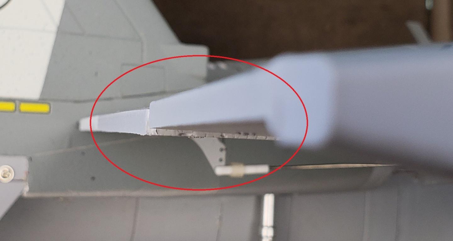

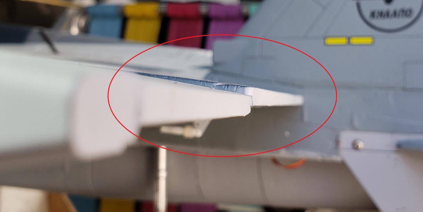

                                    Need help or advise;
                                    I replaced original FW stab servos with these KST DS215MG. Last time i was out flying, the model was trimmed, that was about 2 weeks ago. I went out this morning and noticed that my left stab was out of trim. Radio hasn't been touched and i could have bumped the stab while moving it, but on power-on it should have came back to it's fixed position.. Also, servos are buzzing on and off. Right stab seem to be okay.
                                    Is it normal for a servo to get out of trim?
                                    What would cause the servo to get out of trim (not including radio TX)?
                                    Another thing too, take a look at the pics, notice the aileron trim - this is my level flight trim. Is this normal? IMO its a bit excessive.. don't you think?

                                      #178
                                      Are you using each stab and aileron on their own channel? If you did a good amount of trimming on your last flight and didn’t look at the control surfaces, at least they counter one another. Just a thought..,
                                      Radio system are you using? I’ve had issue with some receivers and especially gyros in this plane. Also, the control horns become soft after a while due to the way they mount. I tightened mine further than necessary, then epoxied them in. Basically making them permanently part of the control surface

                                        #179
                                        Thanks for responding,
                                        I am using X9D+ and x8r receiver with 2 decoders to get 16 channels. The ailerons and stabs are plugged directly into the receiver, each on its own channel.
                                        This was first time i noticed that servos got out of trim. I might have tweaked the trim by accident or something in the channel mix could have caused the stab servo go out of trim.
                                        The question is about aileron trim on the pictures i attached. That's a lot of trim for a new model.. don't you think? It gets me level flight, but i just wonder if you had to have that much trim for your Su out of the box?
                                        Another thing i am dealing with is stab servos aren't synced.
                                        I used x8r on my FW F16 and noticed significant roll to the right every time i flare up the model before landing. So, i measured the throws of my elevator servos and found that they aren't synced. One servo would give more travel than the other causing uneven elevator. I got same problem on Su and beginning to wonder if it's x8r related.
                                        To better explain... On the radio all numbers are the same for both channels except one channel is reversed. All mixes are the same. Both servos are centered when in neutral position. However, when i give full elevator, one has more throw than the other. The work around i found is by using curves in the mix.
                                        C17LM what radio do you use by the way?

                                          #180
                                          Receiver thoughts for Sam CS:
                                          If you switch the servos on the receiver, you will notice if the throw is changing (never mind if they travel the wrong way) If the same servo throws more, it's servo-related. If the other servo increases, it's receiver-related. I would have thought a reduction of the output to the max throwing servo would be an easy workaround to get the servos to match. Are you using openTX on the Taranis? If so, when you simulate in the companion, do they look to be moving exactly the same?
