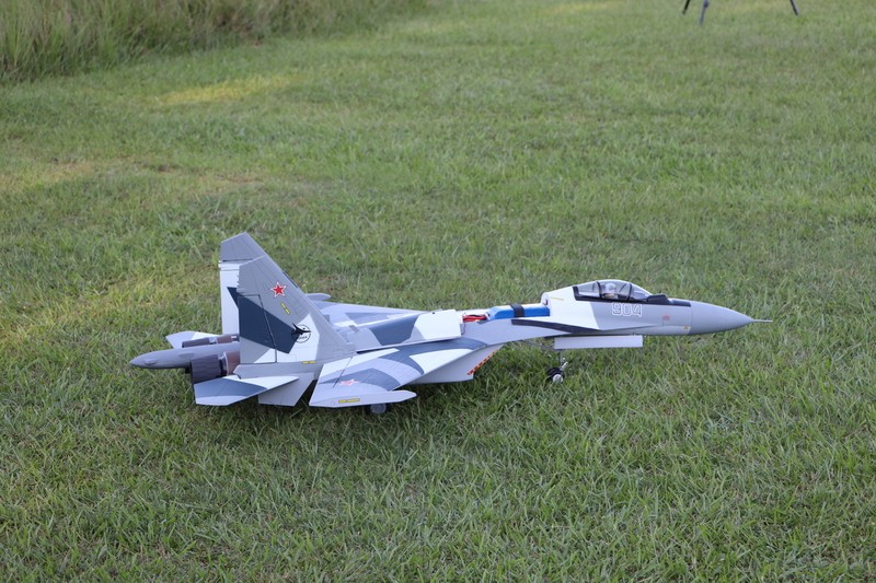

          Yesterday I flew three flights with the Su-35.
          Stock 12 bladed power system
          Turnigy Heavy Duty 6s 5000 all three flights, pushed all the way forward
          Flight controls at 40% expo
          Nose wheel steering at 75% expo (really gentle in the middle, but I have full throw for turning around)
          Taranis X9D Plus SE
          Dual X8R receivers
          Weather:
          91F
          High humidity
          Week old uncut Bahia grass (not optimal for this bird)
          ESC temps shown below are after landing with no airflow. Temps climbed about 20-30F after the bird was stopped on the deck.
          In-flight temps were about 135-150 F.

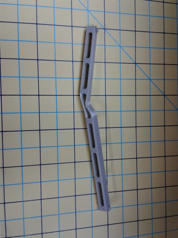

          7. The nose gear mount is not glued very well. I had no hard landings yesterday. All three were greasers. My nose gear still came unglued.
          I recommend just going ahead and re-gluing the nose gear and doing the shim mod while in the process. I will do that today hopefully.
          The only damage from this was some chipped foam in the wheel bay, a broken plastic support arm for the nose gear, and a broken steering clevis. I also got a little dirt in the pitot tube.

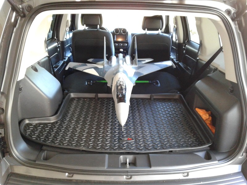

          8. It fits in a Jeep Patriot in one piece. I couldn't take my wing apart anyway due to the lighting system. And my nose cone is glued on with a spear (er pitot) on the end.
          Click image for larger version  Name:	20180921_082723.jpg Views:	1 Size:	128.4 KB ID:	152850

              Well the grass is cut every week. This day it had been 6 days since the last cut. It was ridiculous to fly in that grass. But I wanted to test her out.
              She did take a long time. The first flight she got off much quicker because I had TV and flaperons (1/2 flaps). On subsequent launches I did not use flaps. She really likes flaps on takeoff in grass.

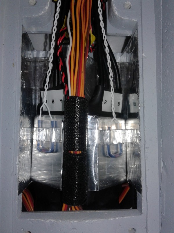

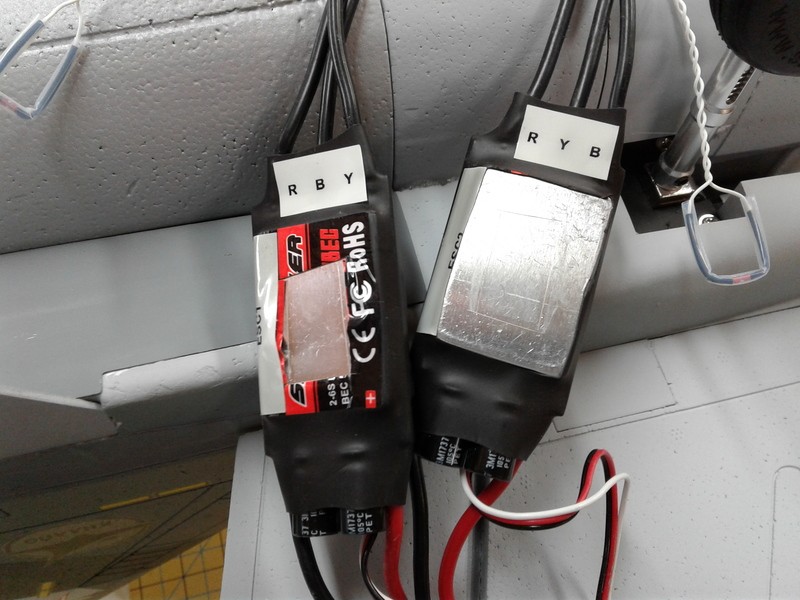

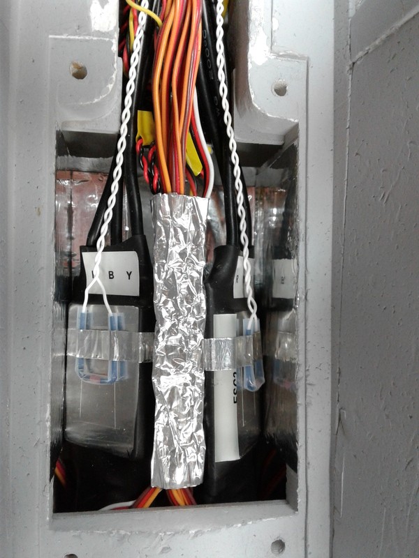

                #47

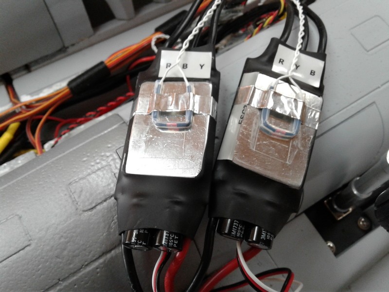

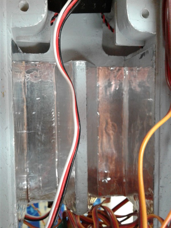

                I went and trimmed some heat shrink off the stock esc's and lined the bay with aluminum tape. I also added some emergency heat protection in the form of a foil wrap on the flight control wires passing through the esc bay.
ID:	153012Click image for larger version
ID:	153014Click image for larger version

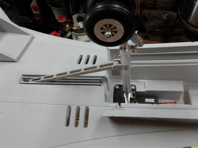

                Nosewheel is fixed. I decided not to shim it. I just gave it a proper gluing and replaced the scale brace.
                The fans were soooo dirty. Got them cleaned too.
                "Volkhova" is back on duty.....

                  That's one thing I remember about my first one. The front tire is just in the worst place for kicking up stuff and right into the intakes. My first one flew off a gravel runway. The fan blades got dinged up really bad even after the maiden.

                    The ESC's get hot for my taste. But I think they are OK. Today they were running about 140F in the air and 160 on the ground parked. That's about 20F cooler than before I did the mods. OAT was about the same at 90F.

                      #50
                      I took off that aluminum foil from the wire harness and just put a piece of aluminum tape between the two esc's to kind of insulate the harness.

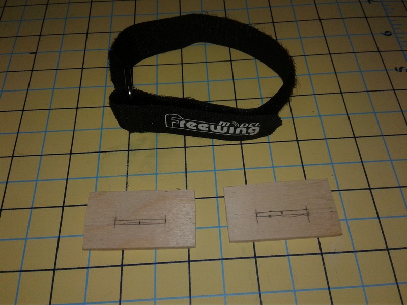

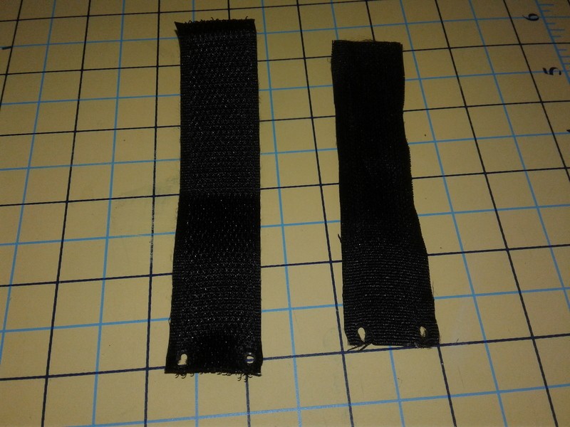

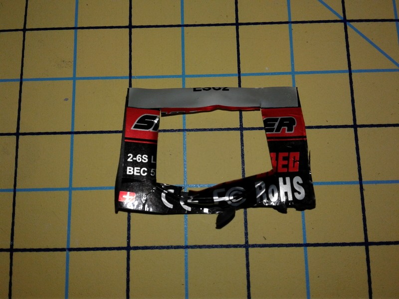

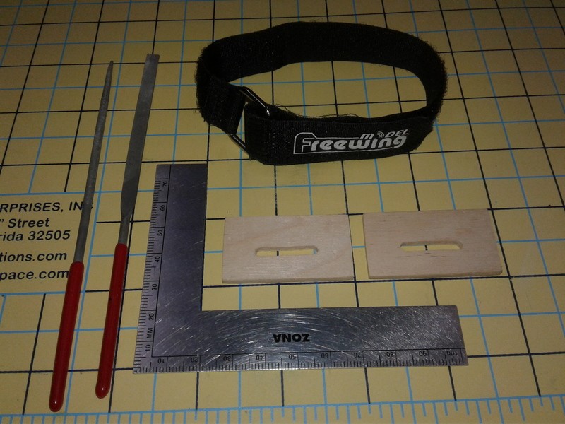

                          My battery strap decided to start coming loose after 6 flights though.
                          So I made some new parts, dug up a T-45 battery strap and voilla. One strapped battery. And you don't even have to tighten it much, which puts less stress on the battery bay.
                          Oh and I did a lot re-programming. I have it where when flaps go down, ailerons are gone, but tailerons are active. This will work well based on my flights yesterday.

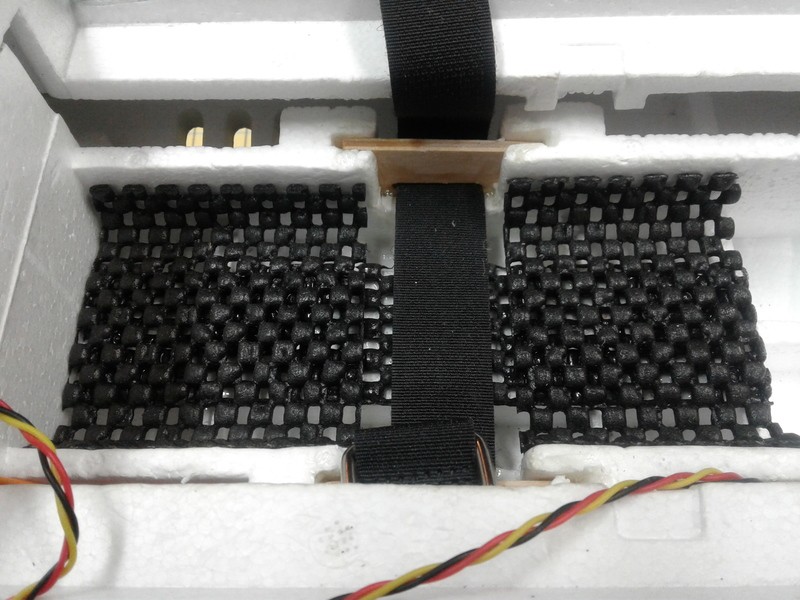

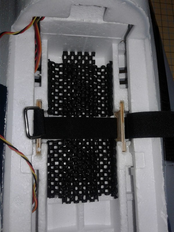

                                        Here is my final battery tray mod. Very secure battery with moderate pressure on the strap. The original was hard to cinch down.
                                        The extra pieces of shelving liner were glued-in with Tacky Glue.
                                        Click image for larger version  Name:	20180925_062254.jpg Views:	1 Size:	115.1 KB ID:	153335
