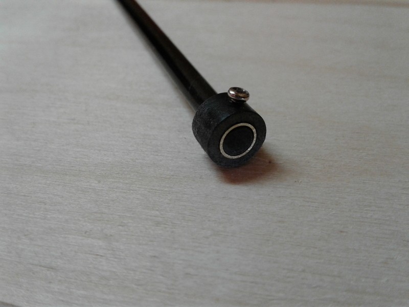

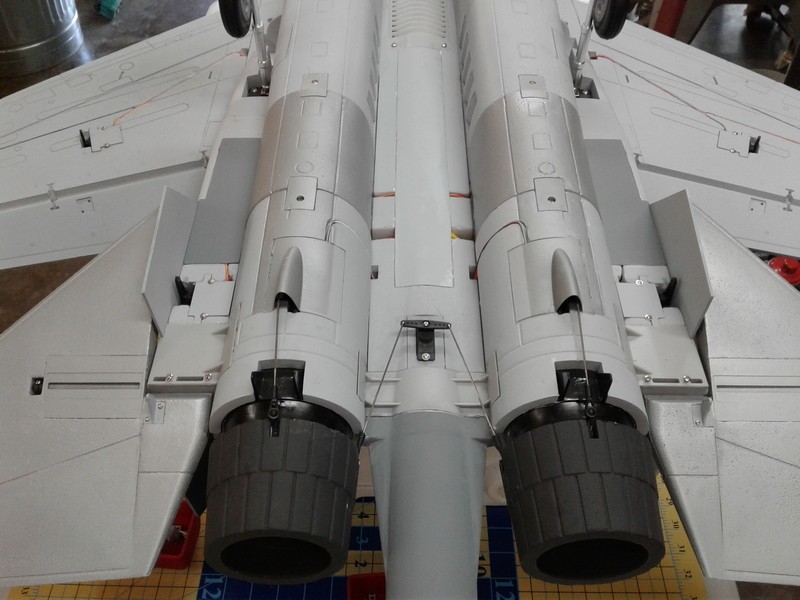

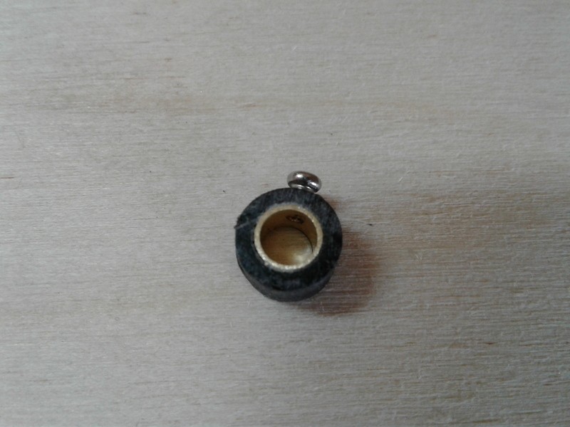

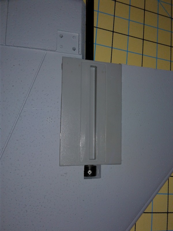

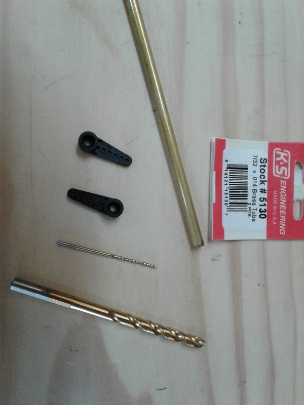

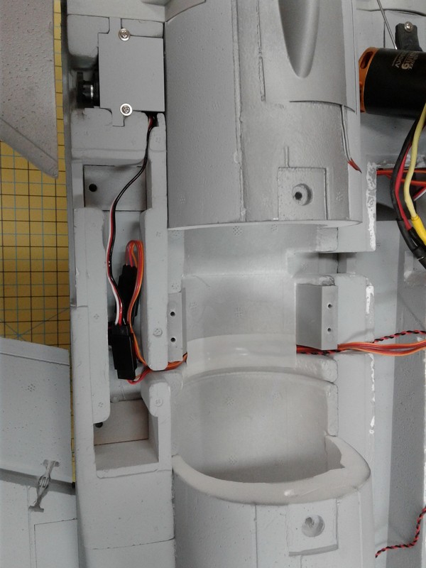

        Today the bird is finally out of the body and paint shop. Started to do assembly and true to form I am missing the collars for the elevator axles. !@# So, I took a 17g digital servo horn and drilled it out with a 7/32 bit to accept a piece of brass tubing which fit over the axle.
        I then drilled a 1/16" hole to accept a small machine screw (probably off a landing gear leg). And there you have it...excellent collars. Construction resumes.....

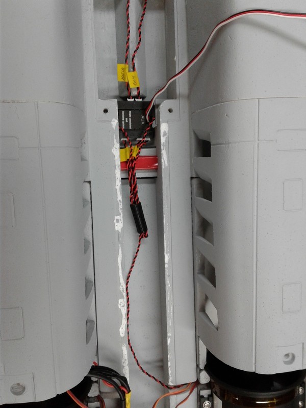

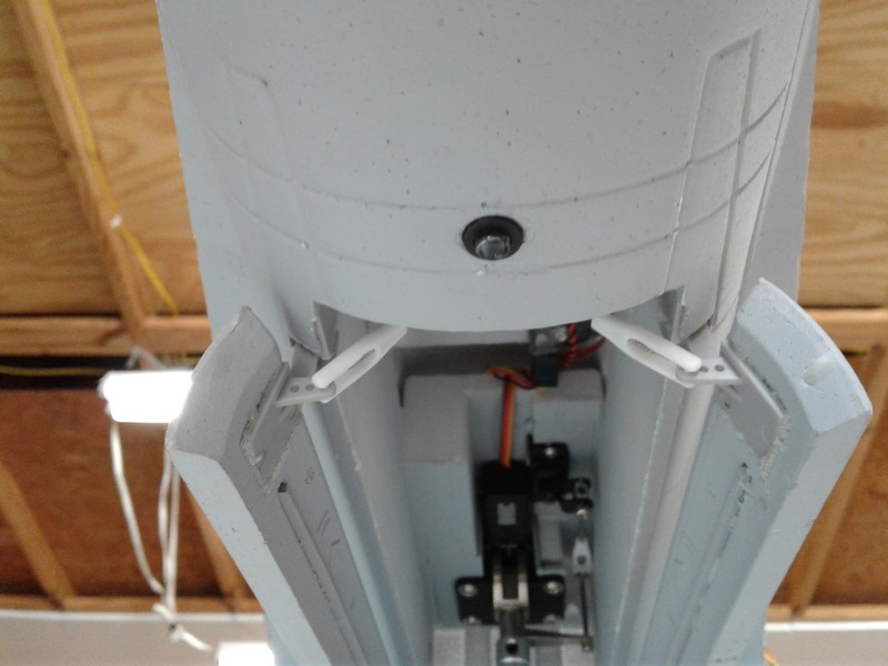

          #24

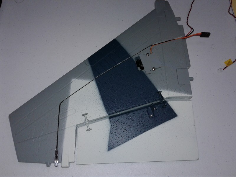

          Received the new vertical stabs today. Interestingly, these both had loose lower hinges just like the originals. A little epoxy in the hinge pockets fixed that. And no foam was melted.
          Got the strobe installed in the tail. I have been using some Gel Tacky Glue to hold the leds and cables in place. Works good. It is rubbery like EPO glue and thus easy to remove.
          Still have to mount the two receivers and organize the last few wires in the battery bay. But the bottom is all buttoned up.

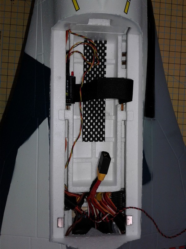

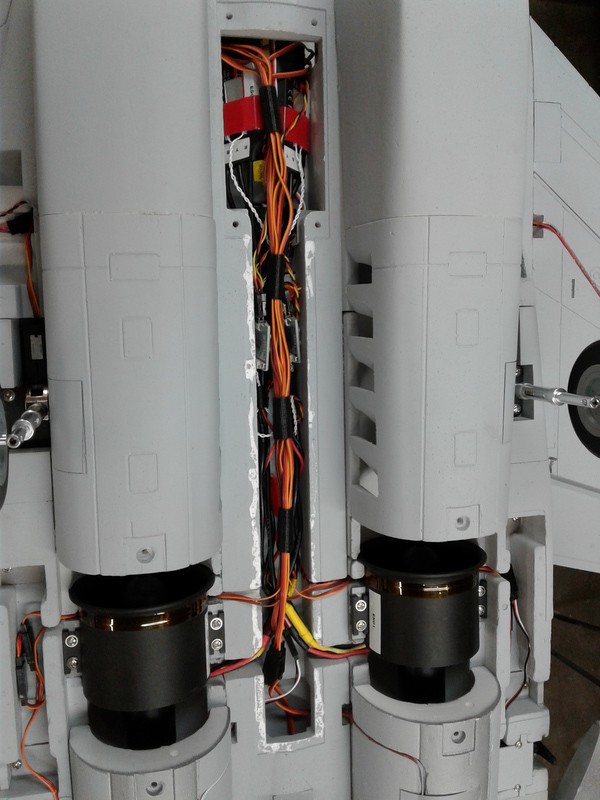

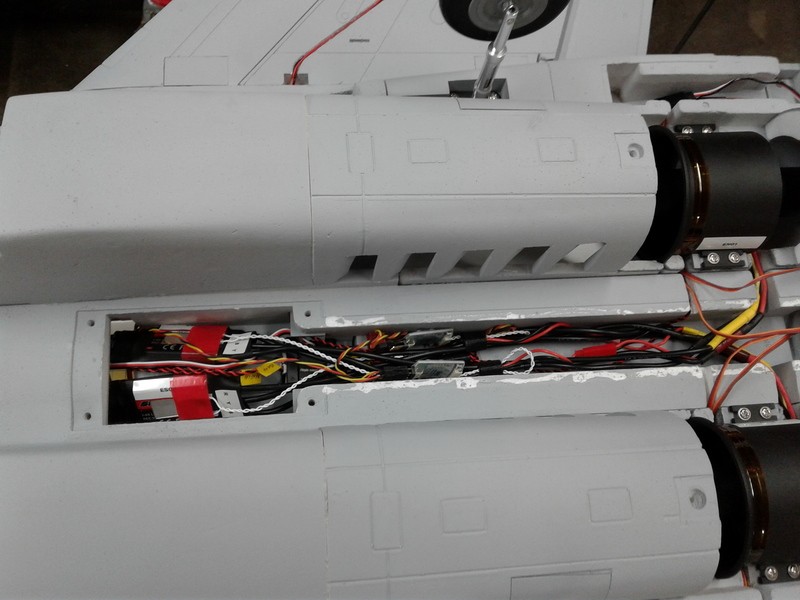

            #25

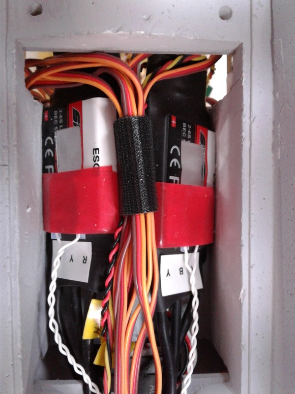

            Got everything ready...at least I thought so. While setting up the controls I found a bad elevator servo. Luckily I have a spare. I always seem to get bad servos for some reason.
            Anyway, This bird has been an exercise in wire management. I think I have it all sorted. The two receivers are in the blended wing portion of the fuselage aft of the battery. The antennas form 90 angles on their own in that space.
            Looking good for a maiden later in the week. I like the lights.
