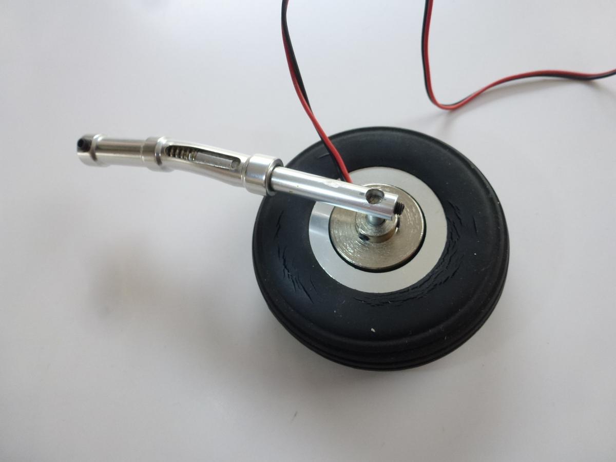

      I'm currently working on moving the main landing gear forward, to reduce the distance between it and the CoG. On this model, the main gear is far behind the CoG, which causes the problems with "leaping into the air" on takeoff.
      I didn't really have a problem with that until I installed trailing-link struts, moving the wheel more aft of the CoG. Since then all of my takeoffs became some sort of cobra maneuver on their own.
      I have been flying with a CoG of 155mm; I will be moving that to 160mm for the next flight to see the effect. I will also start experimenting with flaperons, which could also improve takeoff rotation.

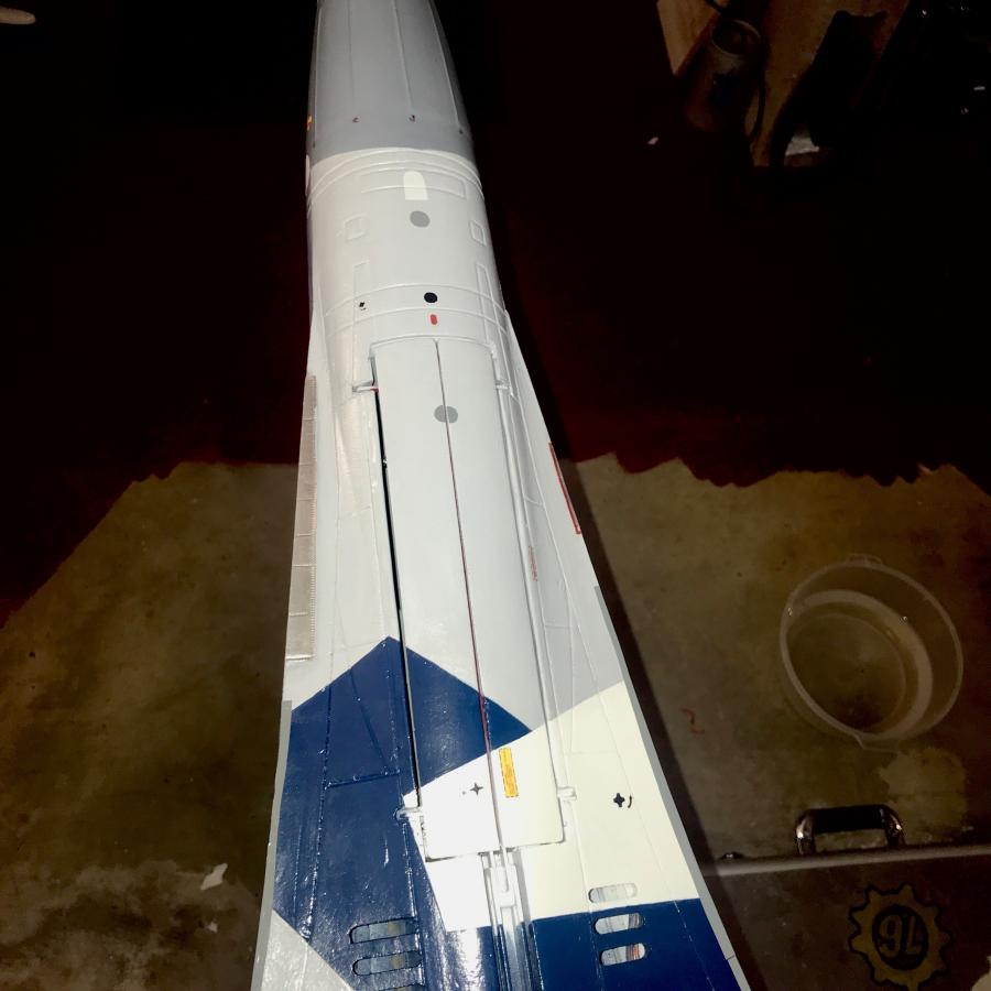

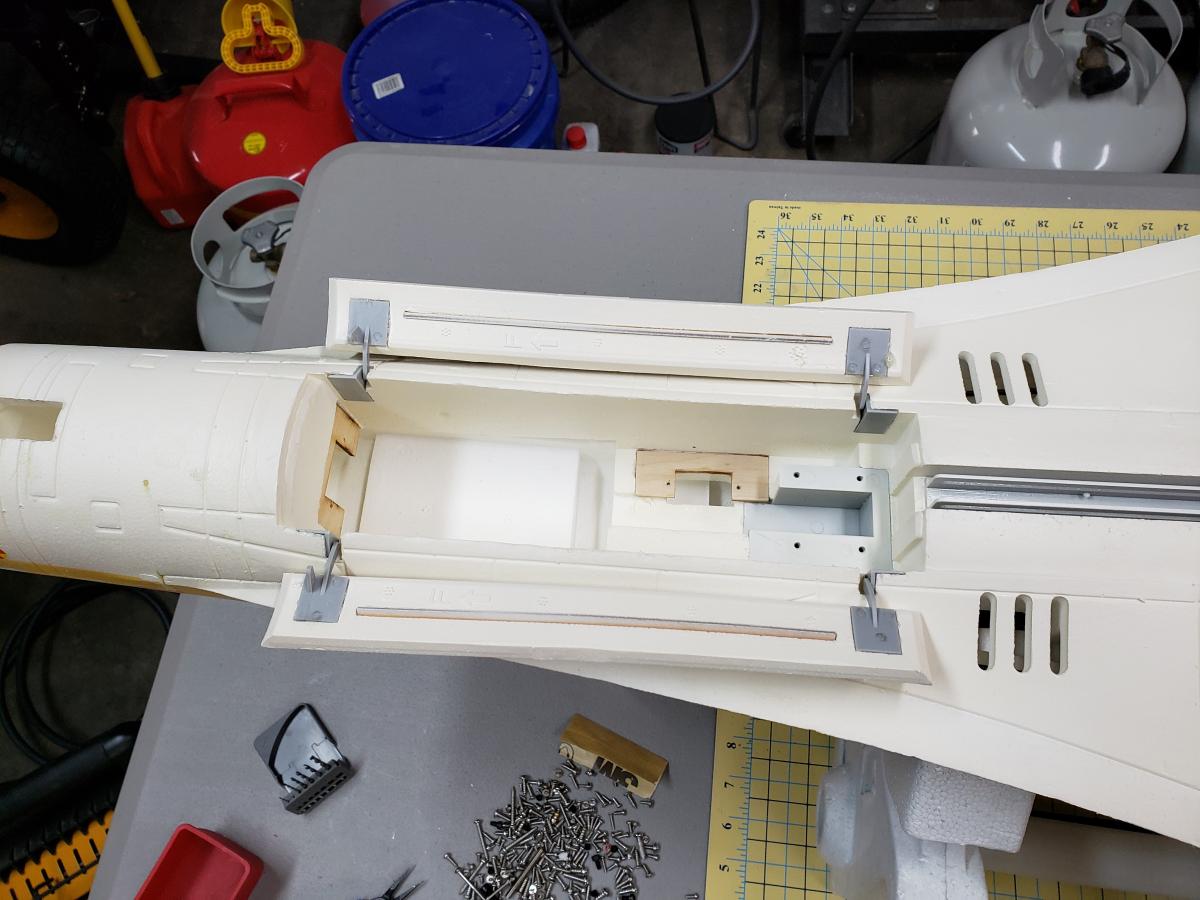

        Well here is where my CG is (will be).
        As you can see from the video, mine didn't have any bad habits on takeoff. I DID use TV on takeoff as well as flaps with tailerons. I found that flaperons caused some weird yaw action when the aileron function was used with flaps down. So whenever I have flaps, my ailerons are off and the tailerons are active. I have not had any problems with her leaping into the air unexpectedly. On landing I do usually disable TV.

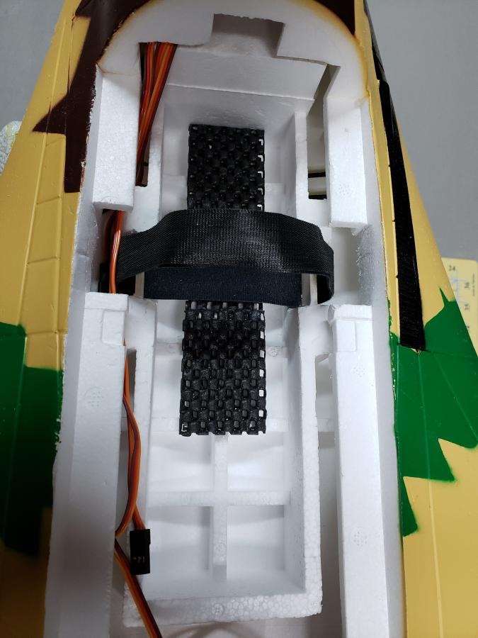

        On this build, I am incorporating the changes I made for the last bird, as well a new one.

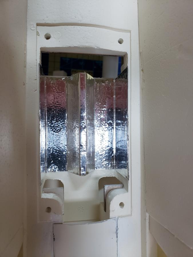

        1. modified the battery tray with new wood to accept a proper strap. Also put rubber on battery tray floor.
        2. lined the ESC bay with aluminum tape for heat protection

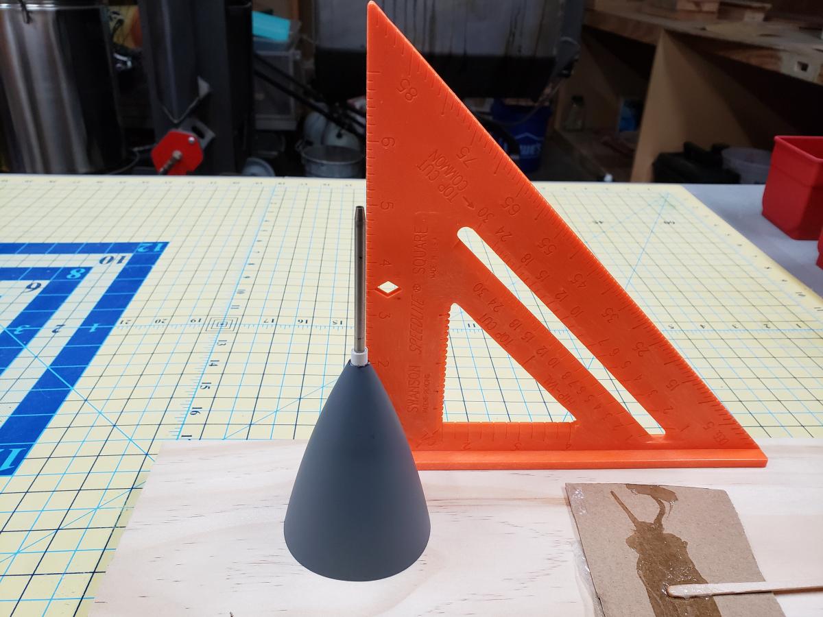

        3. installed the pitot tube in the nose cone for airspeed sensing (to be mixed with controls later on)
        4. installed a lighting system
        5. had to make a new plywood mount for the nosewheel steering servo because the factory had messed it up
        6. changed out the esc vent screws and motor hatch screws for the correct length ones !@#$

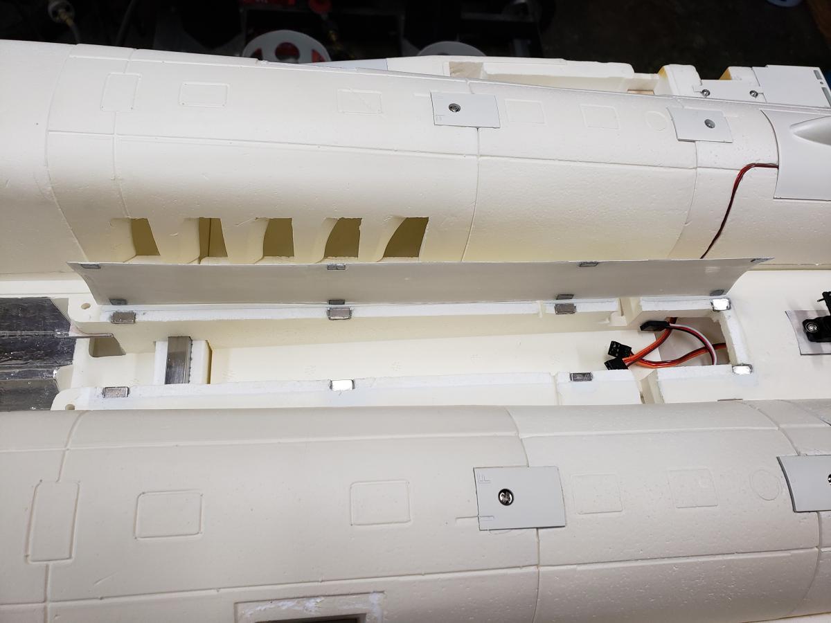

        7. (the new one) added 8 magnets to hold the wire cover on the bottom of fuselage.
        Electronics have all been tested. She is almost ready for paint.

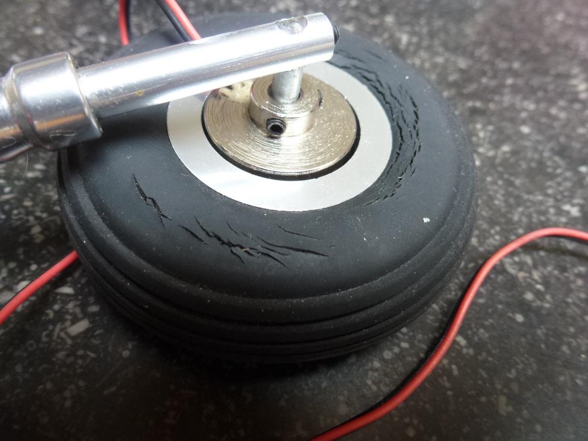

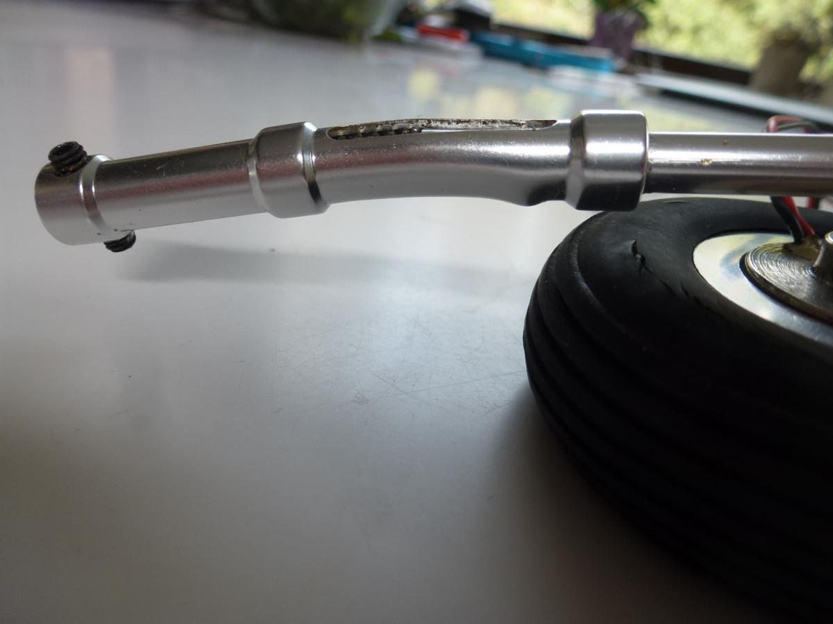

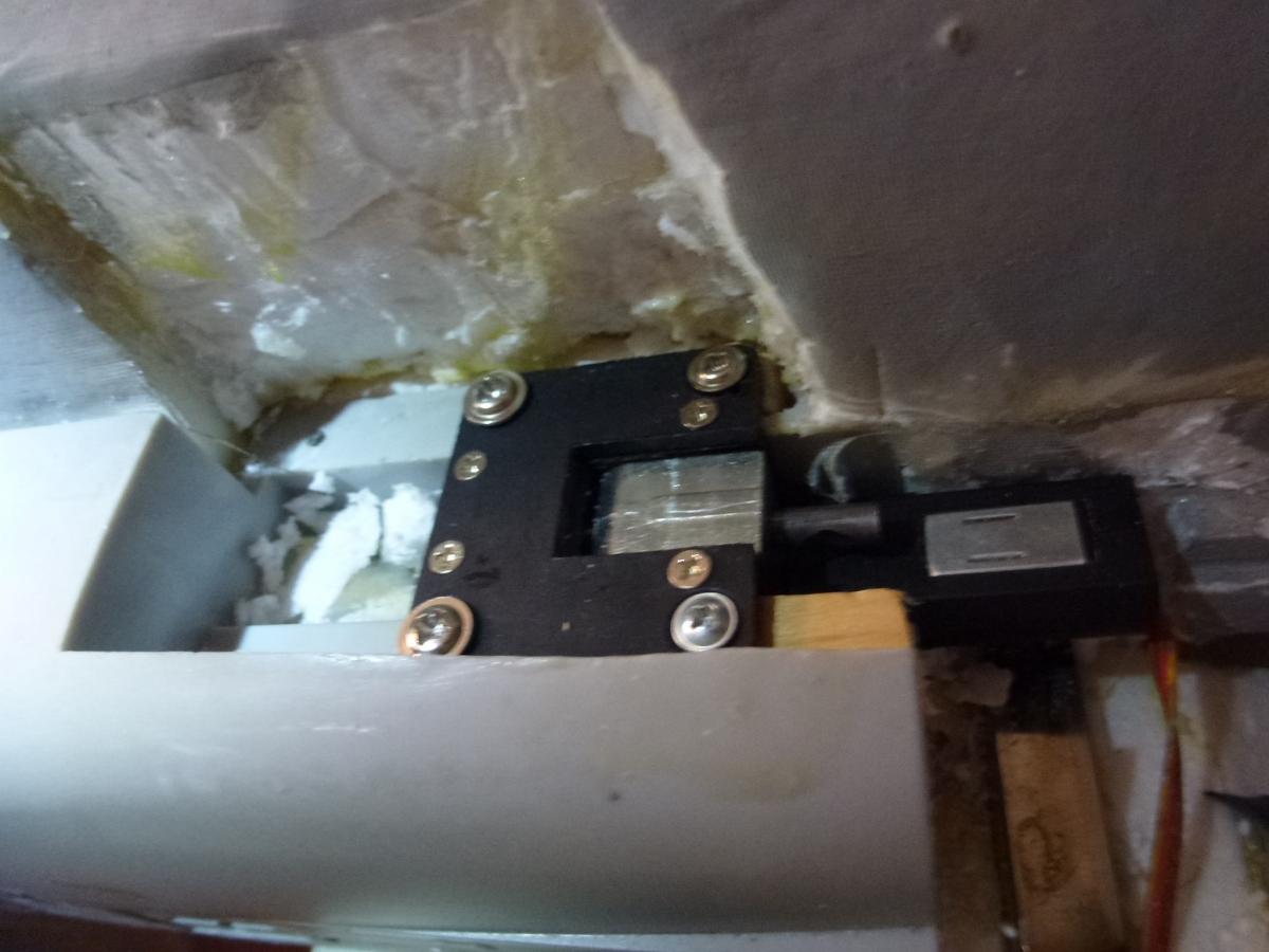

          I have the pitot too (N2 sensor), and I measured straight-line airspeed of 155 kph on one pass. I have no idea about the accuracy of that measurement, but for me (and for my experience) that was fast enough to enjoy.
          Getting back to the takeoff "bad habits", I didn't have any of those either at first. With the stock powder system, I did have a little problem rotating late (on a concrete 80m runway), so after the crash and restoration I upgraded the motors, and I installed the HK brakes.
          First flight after restoration, I had a smooth takeoff (using TV sure helped), but landed a bit hot and had to use the brakes. And boy, did it stop.
          But the result of that action can be enjoyed in the pictures below: one seriously deformed gear strut, and the tyre sheared... I guess it could use some sort of ABS...this is a ship's anchor being dropped at full speed.
ID:	185450Click image for larger version
ID:	185451Click image for larger version
          So I left the brakes out, and replaced the struts with the Freewing F15 trailing-link struts, which can take a drop-test from 10m up from the looks of it...very solid indeed.
          But ever since I started using those, the SU35 developed the "bad habits" on takeoff. So now I'm trying to experiment with the main gear placement, to see if that changes anything.

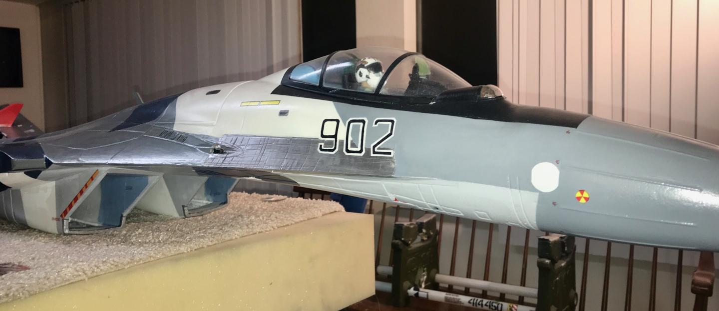

              Looks good! I like the magnet idea. I did the same thing with the aluminum tape on the ESC bay. I also used a 70mm f-16 intake cheater instead of the old small one, The airflow should be a lot better through there. I’m thinking about adding a semi hidden port on the aft end of the cable bay so the air travels down the channel and out the back. I have the wood battery bay tray and strips of wood running the full length of both sides. That way the top and bottom halves of the fuselage are actually secured together. If you need nomenclature waterslide decals I already created them. Which took forever on my computer.. Its the first time I have made them but think it’s kind cool. I made multiple sets, and 901 is the only other prototype SU-35 so the small decals are the same.

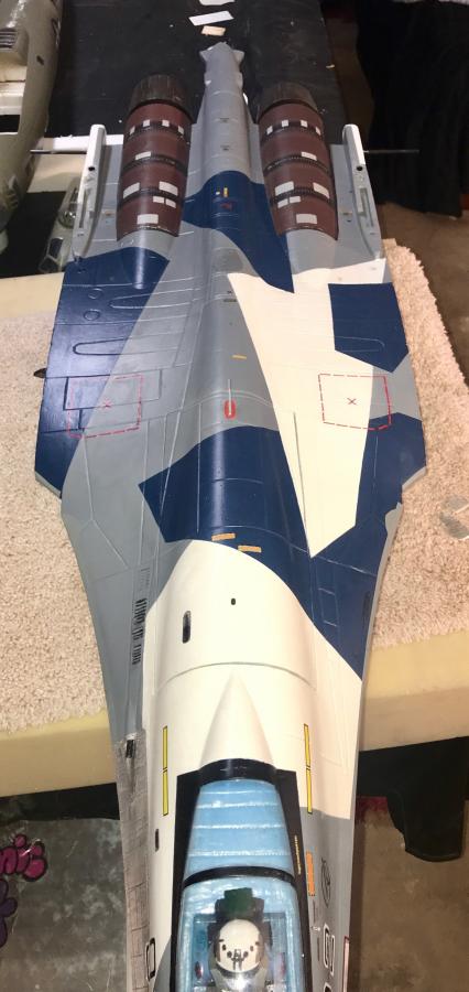

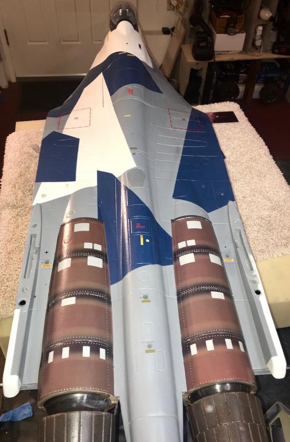

                Hey C17, I have made those water slide decals myself for other planes. They worked nicely. On this project, however, I made a custom order from Callie Graphics. I'm doing mine up in the Gromov Flight Research ACE scheme. The prototype is actually an SU-27, but I like the scheme. I have the bird masked and ready to paint. I'm waiting on the decals to arrive so I can match the blue.

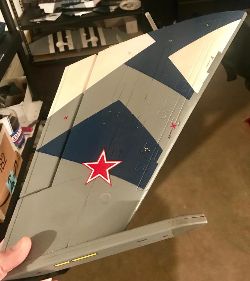

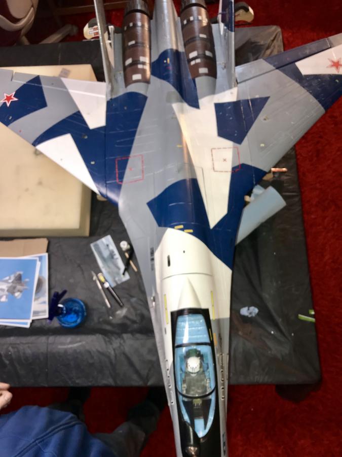

                            Are the decals different from the stock ones? Love to see them. Doing a Ukrainian digital camo on mine.

                              Yeah, they are the correct ones. The Freewing decals are correct on the stars and some of the anti collision lights. The rest are wrong. I have been literally working on this plane for about 9 months.That being said, I have had a bunch of other planes I have been spending time on. One day I will just commit to this and finish it. I have no idea what the weight difference will be between it and my other "flying" SU. I'll be sure to post the weight difference in the end.
                              On the pics... that canopy is a scratched spare I have on for the build only. There is still a ton to go, but copying images and trying to replicate parts with stuff around the house is time consuming.
                                #155
                                Hey there C17loadmaster, if you wanted, send me your decal references and/or files and I can see if I can get Freewing to update their decal sheet. The bird is almost ten years old at this point, but perhaps they'll bite.

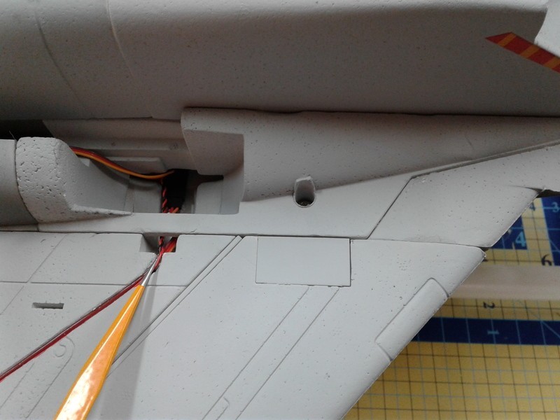

                                          I'm running CG at the spot in the picture above - the wire channel for the ailerons. (Thanks seaviper). With the CG further back, it got weird and unstable. I actually glued a few bolts inside the nosecone for a bit more weight up front, and push the battery as far forward as it can go.
