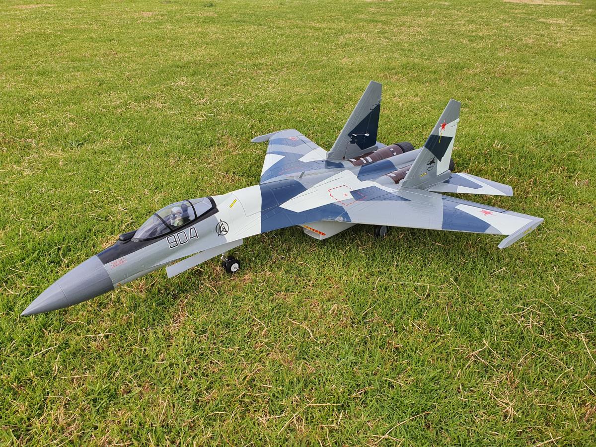

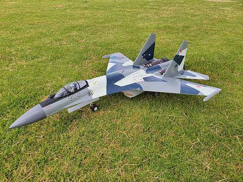

    [QUOTE=mshagg;n284716]Joined the club this week, thing is an absolute rocket with FMS 1900kv inrunners, had to back the timing off to ease the load on the packs but still > 1:1 thrust/weight.
    Basically followed Airguardians build guide with a few bespoke 3DP bits and pieces to better support the gear on grass ops. A3L pro on the TV servos. 3 coats of gloss takes the rough finish of the EPS.
    Looking good, I have the fms 1900kv units in my su35, hawk, F16 and yak 130, they are very smooth especially good in the yak

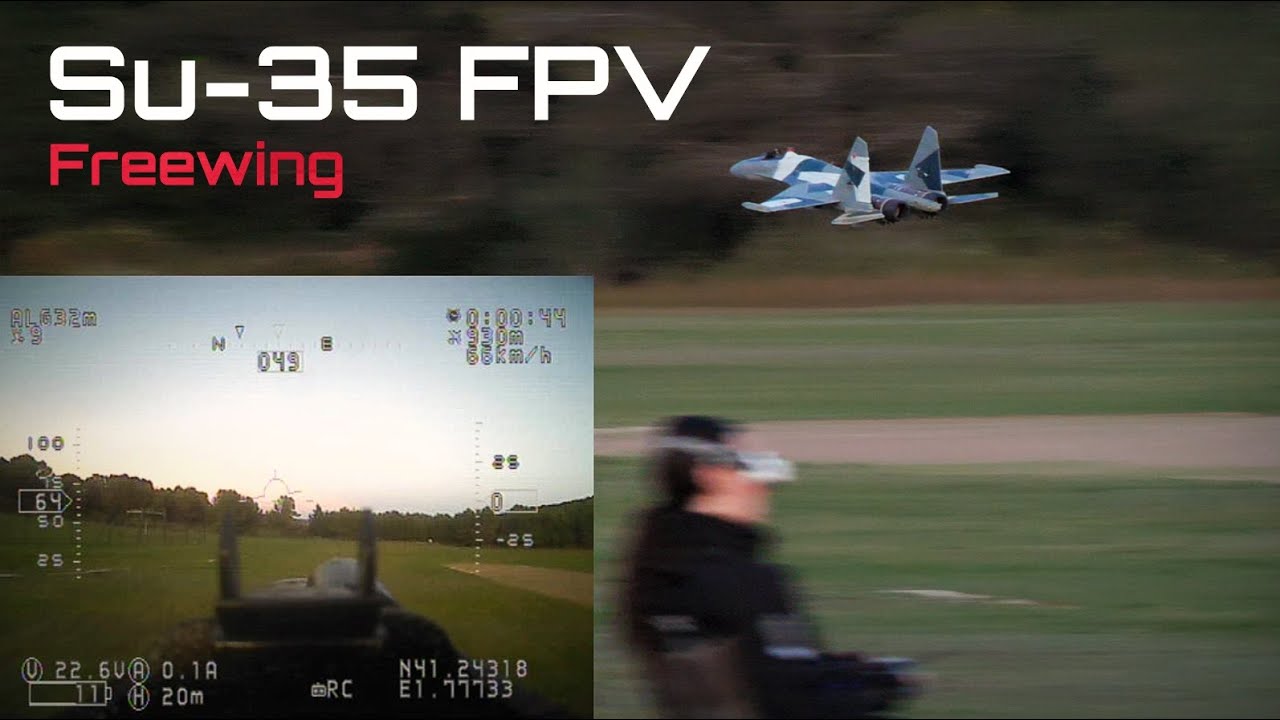

      Having extra-fun with the Su-35 in FPV!
      I replaced 2x X8Rs and an RB16 with two RX8Rs.

        You had me at " > 1:1 ". A pair of FMS 1900kv ordered!
              What a cool jet.

              Do you have any data on the current draw of this EDF units?
                About 140A for the pair on low timing. Above 150A (as high as the current sensor goes) on high timing.

                                  So, there go my actual first FPV flights after I upgraded to RX8Rs/20A UBEC and removed the redundancy bus (allowing the CG to be shifted further aft to where I like it). :)
