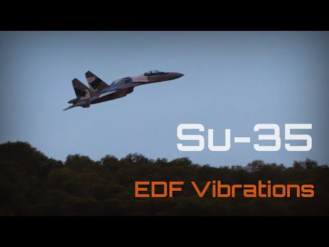

            • Here's a 'documental video', regarding my Su-35 screeching sound. These were scenes from mid-summer when the sound was worse.
              Part of the high-pitched tune that my EDFs make have to do with the fact that I use a high-power, high-rpm, low blade-count setup (5 blade rotors with 2600kv motors running at 6S)... but the worst part of it, turns out, was rather that the EDFs had a 'cheapo' shaft adapter and the mounting pads had detached from vibrations, so all in all, a pretty bad combo. After installing a proper shaft adapter and 'regluing' the EDF securing pads that had come loose, the sound improved a lot. Viewer discretion: Watch at your own risk, I will not compensate anyone for permanent damage to your hearing abilities, lol. 😂

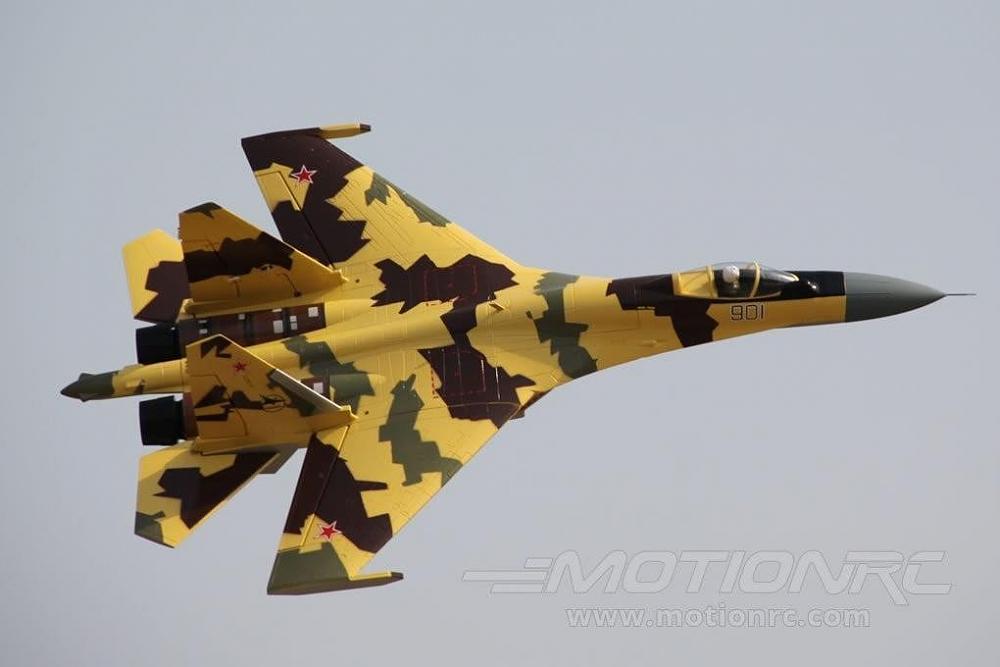

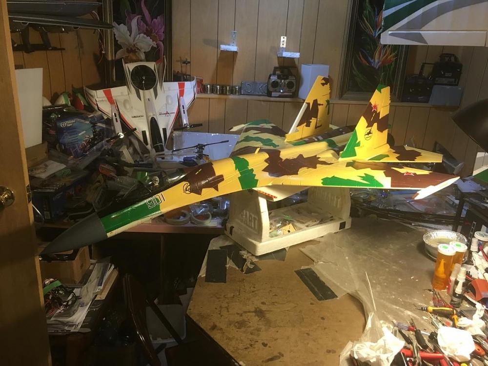

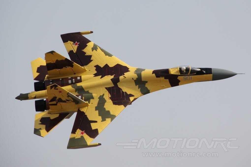

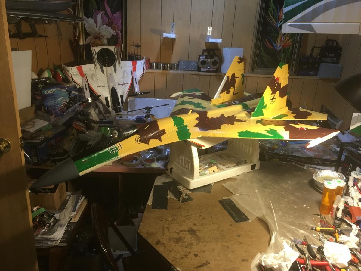

                                      I'm looking at the MRC ad for the desert camo Su-35. The picture shows a dull olive green color for the green shade. But, in other pictures of this version the green is a very bright green. Here are pic's of the difference in color. Does anyone know if Freewing changed the colors on the newest models?

                                      • Never had the desert camo as I didn't really like the color match they did.
                                        Not sure if they have changed it over the years (there are definitely small variances in the grey version though) but in any case I always found the yellow version looking more 'toyish' and less scale, so to speak, so there's that. The fullscale jet looks much more 'dull' and de-saturated.
                                        • Certainly the "bright green" is a terrible color. The dull green doesn't look all that bad. Put on a very light grey "wash" and the overall effect could be pretty good.
