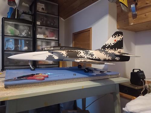

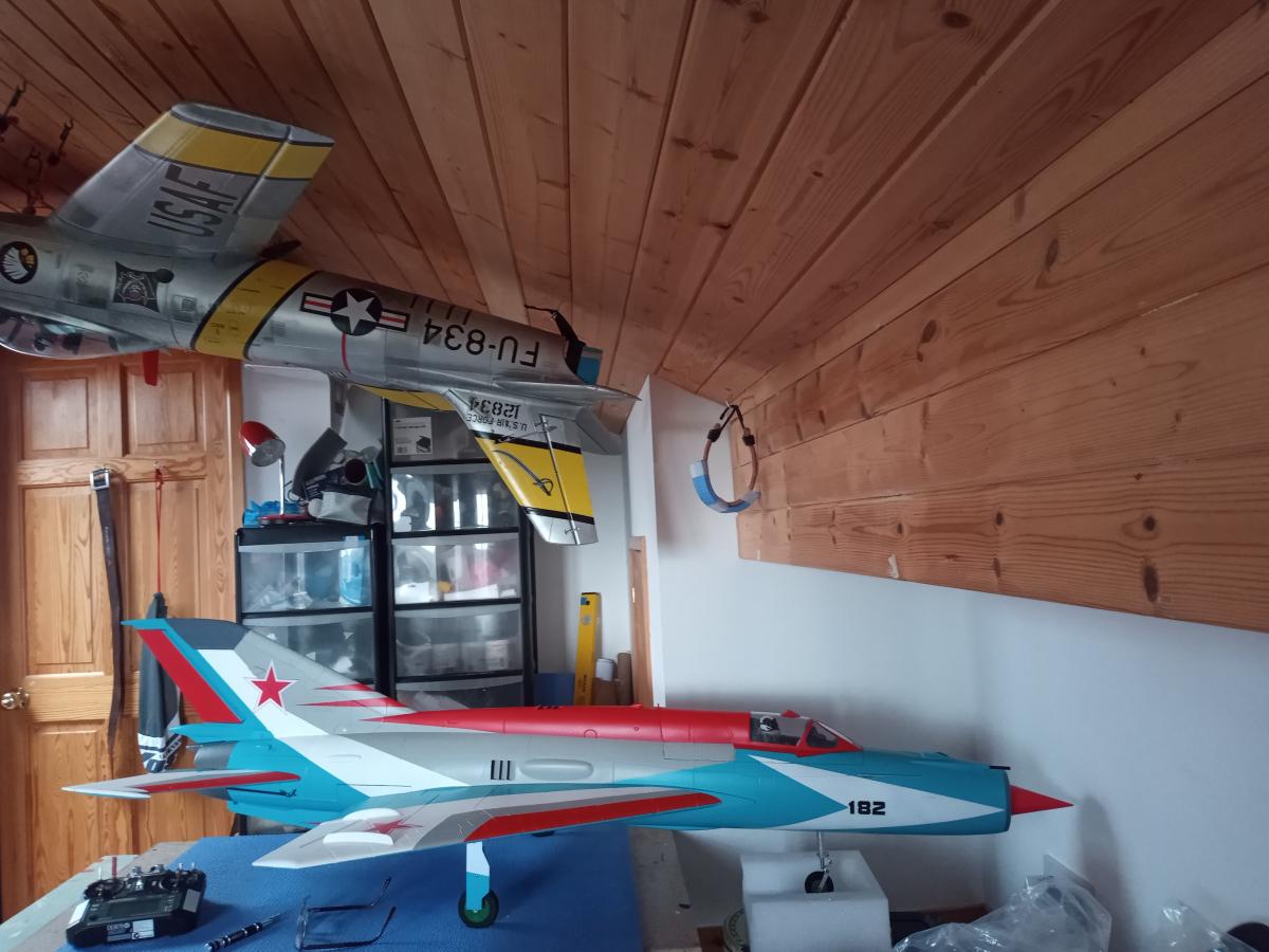

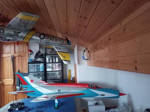

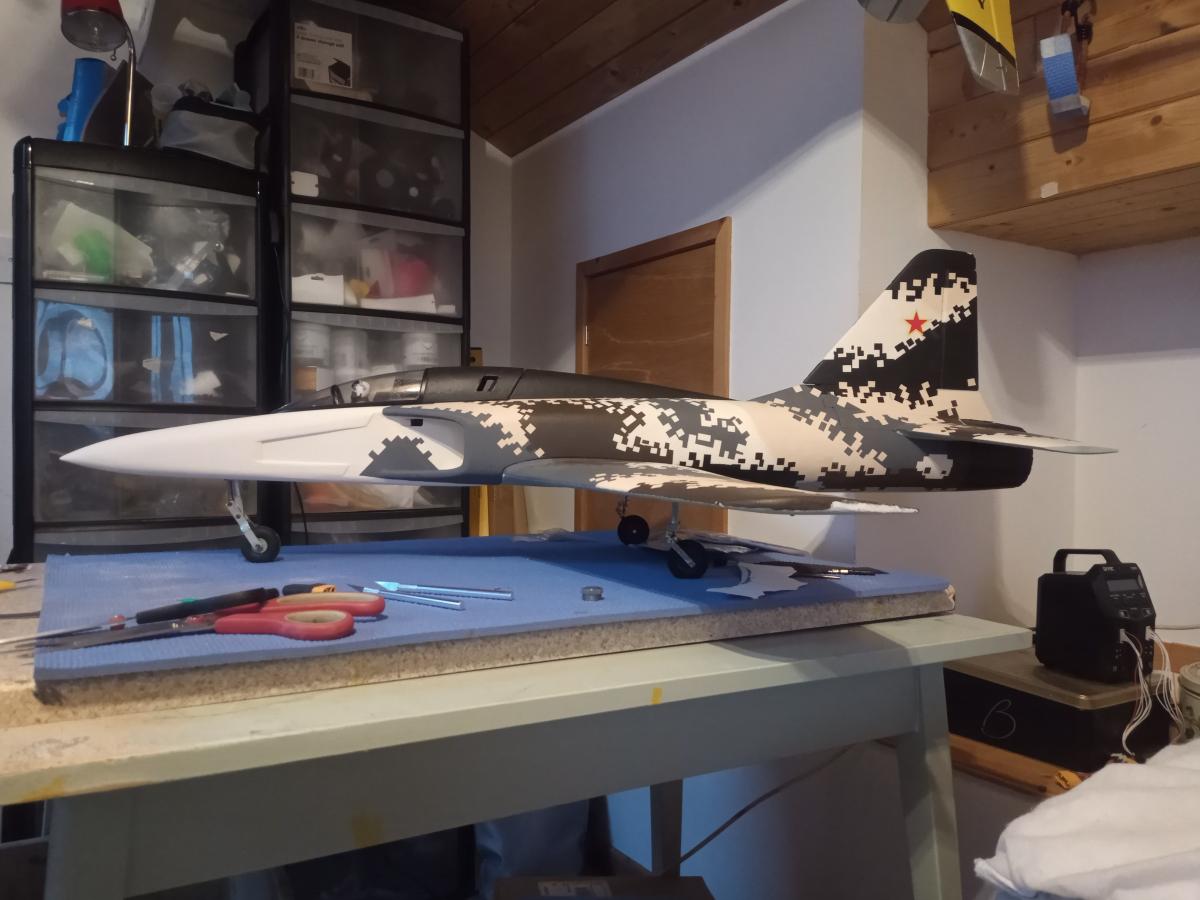

                            Vinyl emulsion sample pots, brush painted, finished with matt water based clearcoat. Same with my F16 Tiger, Mig 21, Rebel and any touch up colours. Very fine hair on brushes for flat finish, mini roller for even orange peel finish. Local diy do colour pot samples £3 pot paints a plane., all 3 same paint and method, good luck !!
                            Click image for larger version  Name:	IMG_20171201_112120_4CS.jpg Views:	0 Size:	134.8 KB ID:	328113
                            Click image for larger version  Name:	Rebel nose 7.jpg Views:	0 Size:	96.0 KB ID:	328114
                            Click image for larger version  Name:	mig 10.jpg Views:	0 Size:	111.9 KB ID:	328112

                                  the digital camo looks great man , is that a paint ?!!! 😲 . the paint job on the mig-21 is amazing , such a beautiful jet
                                  Yes 90% paint 10% peel and stick vinyl which is basically a white A4 sheet, painted using the same colours as the plane i.e. grey, dark brown, black , sand pink and cream, then cut into strips then cut into squares/rectangles to make up the isolated digi squares then peel and stick on to suit and firm down with low level heat on hobby iron. The digital squares attached to the main body of paint are formed by cutting the pattern in the frogtape masking tape before applying masking tape then painting. There are several stages involved and it does take a fair bit of time though the hard time consuming part is the thinking about what to paint and where to complete the picture so to speak so it can need "adjustments" along the way to achieve the desired effect.
