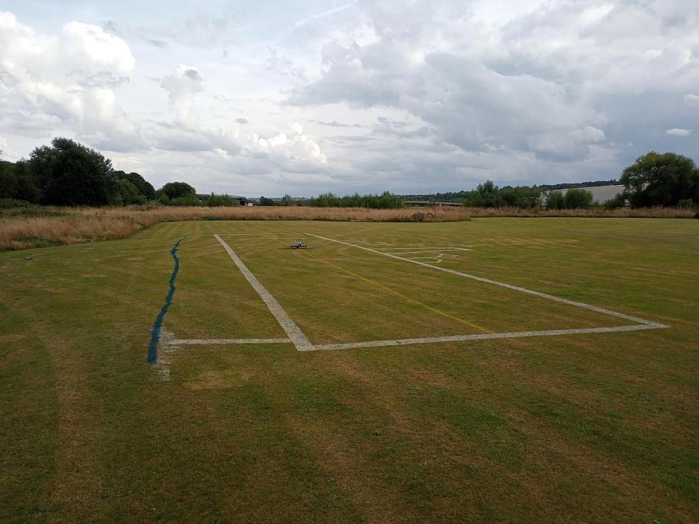

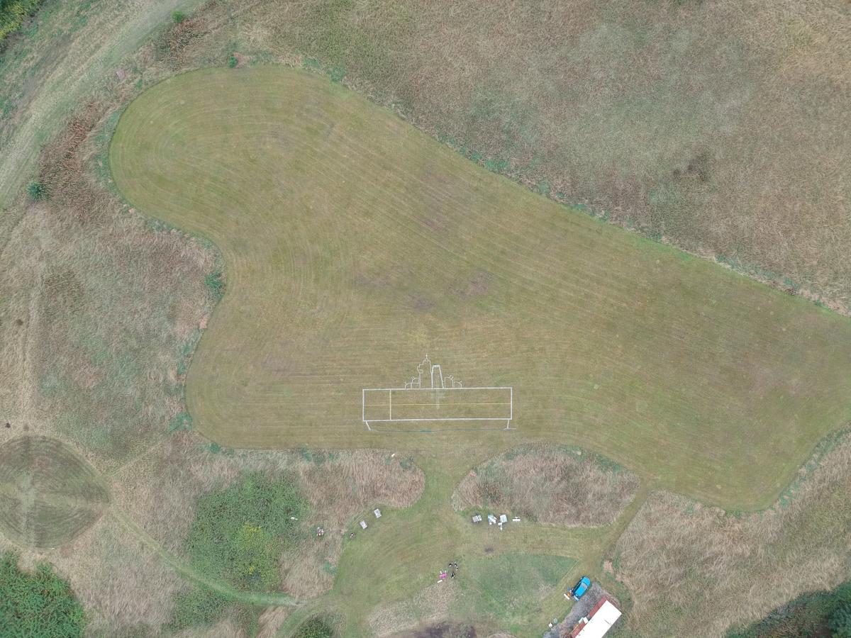

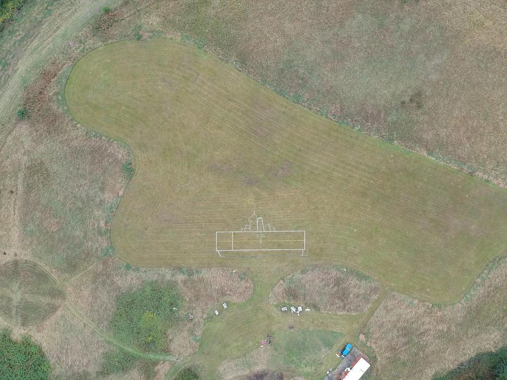

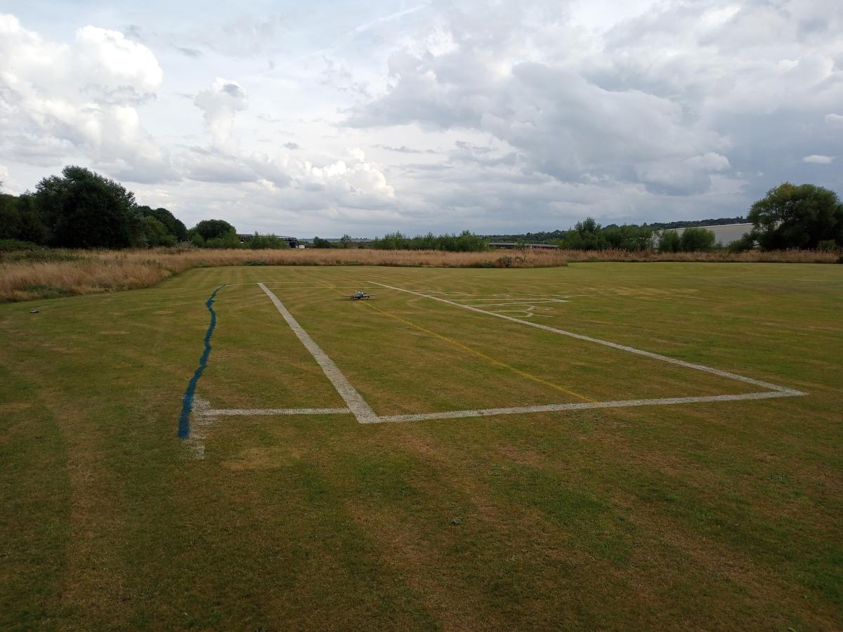

                        Hopefully so, I will keep you up to date. In the meantime it is down to the field to see if my paintwork on the carrier deck for this weekends Warbirds day at DDMAC survived the rain.
                        Click image for larger version  Name:	DJI_0084 (1).jpg Views:	0 Size:	188.9 KB ID:	356413
                        Click image for larger version  Name:	IMG_20220907_163454_072.jpg Views:	0 Size:	130.6 KB ID:	356414
                        I wonder if an SU35 ever flew off a carrier deck ?
